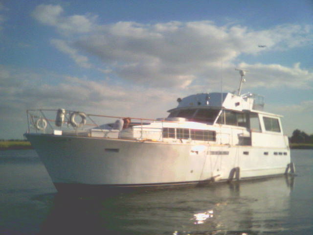

    our '70 58'
    anyone have any idea on how to stop the leaks on my roamers port side windows??? please help

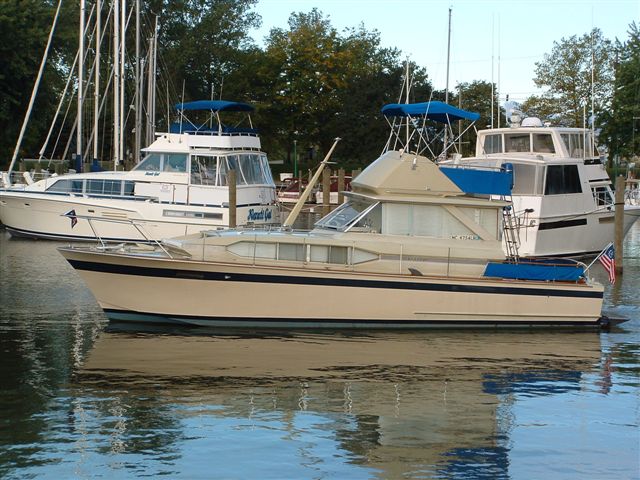

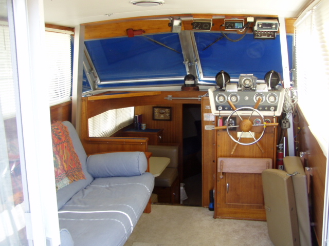

    GEMINI
    Formerly known as SURVIVOR:

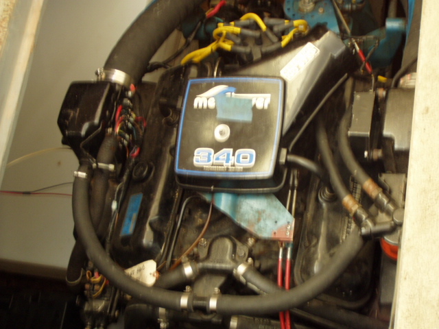

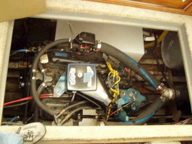

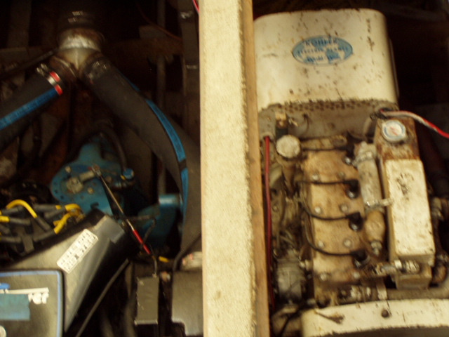

    GEMINI (Continued)
    Getting to the guts of her.
