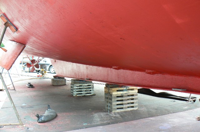

    Yes but it does project out the side where you could clip something coming off the bottom or the side of a sloping channel.

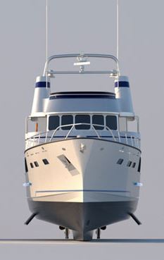

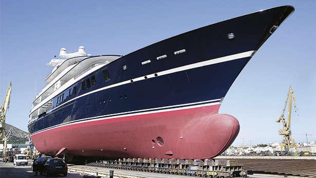

    That doesn't look like a stabilizer fin to me to small, wrong angle; even yet from that angle does it doesn't look like it is beyond the hull side. I agree with Bill that finding one extending beyond the keel of an 11' draft boat is extremely unlikely. Think about how these things work; down low and close to the bottom (which means close to the centerline of the boat) makes them less effective. Now that certainly doesn't mean one can't hit something protruding in it's path, including an underwater ledge or channelside. I know this from personal scientific testing.. don't ask me how!

    Here's an example of a stabilizer fin extending beyond the hull side:
  7. K1W1
    7,453
    That one could be knocked pretty hard and easily in that position if you were to pass a coral bombie or rock too close.
    A Composite fin could be made to shatter but I have not seen any of those offered to my projects so far.
    Most folks who operate vessels with Stabs manage to do so without any major life threatening incidents so it might not be a popular item even if available.

    What should it look like? Considering those fins were designed and spec'd for satisfactory performance on that boat by people who "know big boats" it is a bit disingenuous to make the claim that they are too small and at the wrong angle.
    There is a relationship between fin size, vessel speed, rudder size and power and the interaction between all those factors. A rudder alone can be used for roll stabilization but it is not very effective and creates a whole new world of issues so it is not common to find the rudder as part of the roll control system.
    A fin sticking straight down would control roll but would also increase draft all out of proportion to the benefit. The angle fins are fitted is often related to the side clearance, some boats that use retractable fins place them parallel to the water surface, stick far out from the side, and work quite well, just as well as those at some angle intended keep them withing the box defined by draft and breadth.

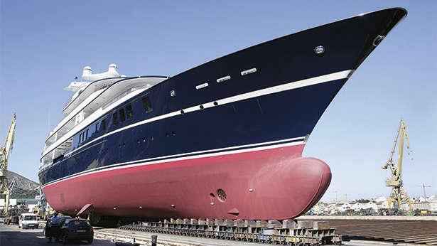

    Back to the topic, Serena was built by a commercial yard in Brazil that builds steel commercial vessels and small (up to 10m) composite recreational boats. It is fairly safe to assume the boat was steel and if they used fin stabilizers from the usual suppliers and they were fitted in compliance with class rules and manufacturer's recommendations, it is extremely unlikely that grounding a fin hard enough to hole the boat would have gone unnoticed by the crew or passengers.

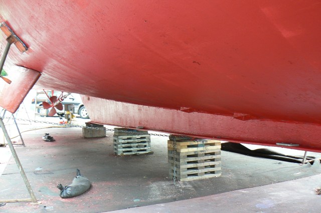

    I have seen a lot of fins damaged by grounding, groundings that were immediately and painfully obvious to all on board. Those fins were bent, broken, de-skinned, and/or shattered but none of them tore a hole in the hull or ripped the shaft from the actuator to leave a shaft sized hole open to the sea. It is very easy and fairly common to hit a fin and nothing else, docks, dredged channels, and coral heads are the usual suspects. Resting on a fin as the tide falls is another issue that may damage a fin (they are designed to fail - they are sacrificial to save the hull) but that doesn't sink the boat either.

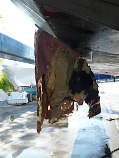

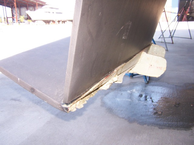

    This one broke off fairly cleanly. I need to dig through my pic files, there are a few showing fins that look like fish skeletons from the composites failing when the fin structure flexed during a grounding ... a grounding that everyone on board knew instantly but did not hole the boat.

    "...I have seen a lot of fins damaged by grounding, groundings that were immediately and painfully obvious to all on board. Those fins were bent, broken, de-skinned, and/or shattered but none of them tore a hole in the hull or ripped the shaft from the actuator to leave a shaft sized hole open to the sea..."
    The captain of this 61' steel trawler said he didn't know he hit something. He also didn't know how the razor blade marks got on the lucite cocktail table either. No water entry into the hull.
