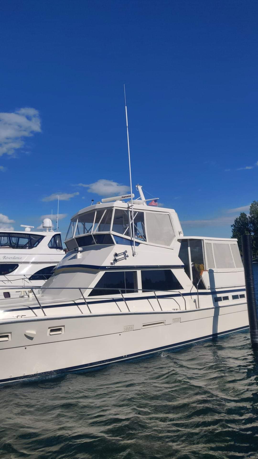

  7. MBevins
    MBevins Senior Member
    May 23, 2008
    1,172
    Windsor On. Canada
    FB_IMG_1591910962458.jpg [​IMG]

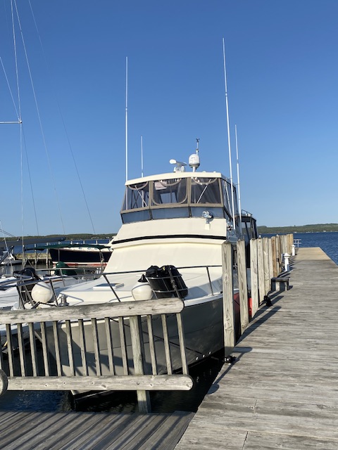

  10. LM Viking
    LM Viking Member
    Sep 20, 2018
    141
    Michigan
    This is my install. The aft 2 are 8 ft masts with 4 ft antenna and are not in use at this time but replaced 2 that were there. One an old gps which was not used and the other an old cell phone antenna again not used either.

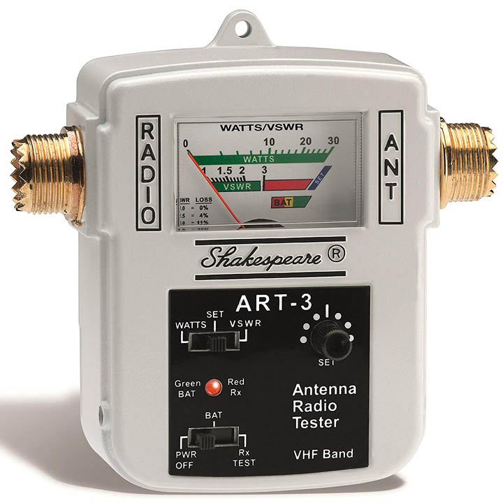

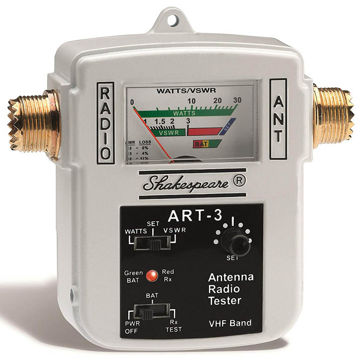

    Handy tester that takes the guess work out of it. I've seen them on Amazon.
    Rob Glassman and Drifter like this.
