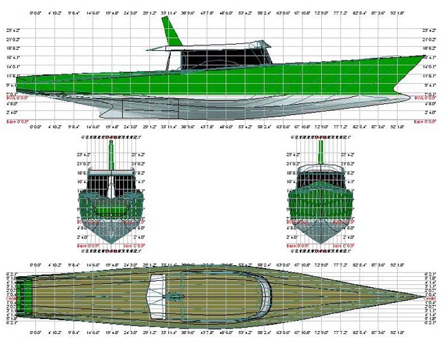

    I could stretch this 20' and lengthen the house. Good efficient fast boat with a good ride for down in the Southern Ocean. Yacht grade fit and finish about $17MM in aluminium.

    Doesn't look like it has much space aboard ... are you trying to tell me something I'm not getting?
    Fast is not what I need, I expect a very long voyage down. Stable is worth a whole lot more than fast. I read a lot ... 10 hours a day in journal articles alone.
