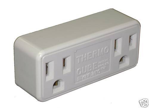

    All the block heaters I have used are on when ever they have power. In below freezing temps, I use Thermo Cubes to turn them on and off.
    The cubes I use turn on at 35° F and off at 45°. They're available in other temp ranges, like needed for air conditioners. The cubes are on ebay and Amazon and cost about $15-20 and rated at 1500 watts. Thermocube.JPG
