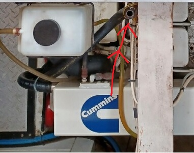

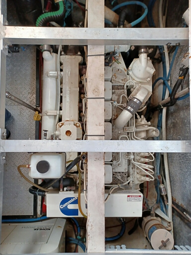

    Attached are a few pictures of the engine that perhaps can be of help?
    As far as the engine hours: we do know the owners (original) bought the boat and used it in Canadian/northern USA waters before having it brought to FL (via a Cpt). The owners then used the boat on 1 or 2 excursions to the Bahamas. Otherwise the boat has been sitting in a marina with a monthly start (I do not know if it was put into gear during those starts as someone suggested).
  8. Pascal
    8,945
    Is that the fuel tank crammed against the engine in the first picture? Looks like rust on the tank surface next to the racor. If these tanks are original they are likely close to the end of their useful life
    Speaking of the Racor, the bottom is pretty much unreachable. How do service this thing.
    same question about the 90 degree elbow next to the generator, looks like bronze with green corrosion. Can’t see what it is attached too because of the floor frame but whatever it is it seems impossible to reach and service… strainer? Air con pump? Can’t see it
    this boat seems to be a service nightmare. I know it s tough to cram two diesel in a small boat but maintenance costs always go thru the roof when it takes 3 times longer to do a job.

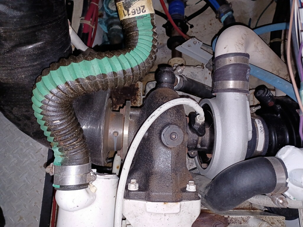

    Also the fan in the second photo, aside from being partially detached, is something I'd expect to see on a small bowrider.
    The exhaust pipe looks in remarkably good conditions for the boat age, though.

    Looks like the turbo and exhaust/dump can has had some recent work.
    Nice paint job on the heat exchanger and expansion tank.
    New decals?
    The air cooler case is made of aluminum. The core is nichol/brass. There are two zinc points to help keep the alloy corrosion down.
    Cummin's dock queens have a problem here. They fill with crud and the alloy case corrodes and fille with white mud.
    Looking at the HE and turbo work (fresh paint and no paint), I hope these were recently looked at.

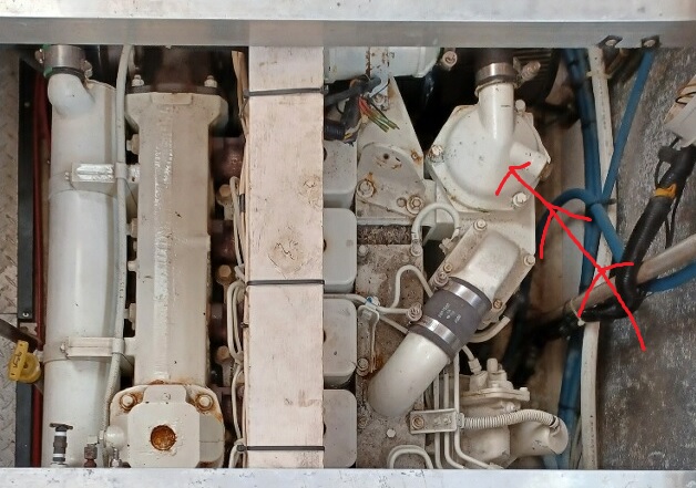

    My other comment about the raw water pump.
    Sherwood was the mfg who made the original raw water pumps for Cummins marine.
    What a cheap POS pump.
    SMX makes an exact replacement pump with out the headaches. Also uses the same impeller.

    That green-strip Gates hose will fail soon. No need for those bends.

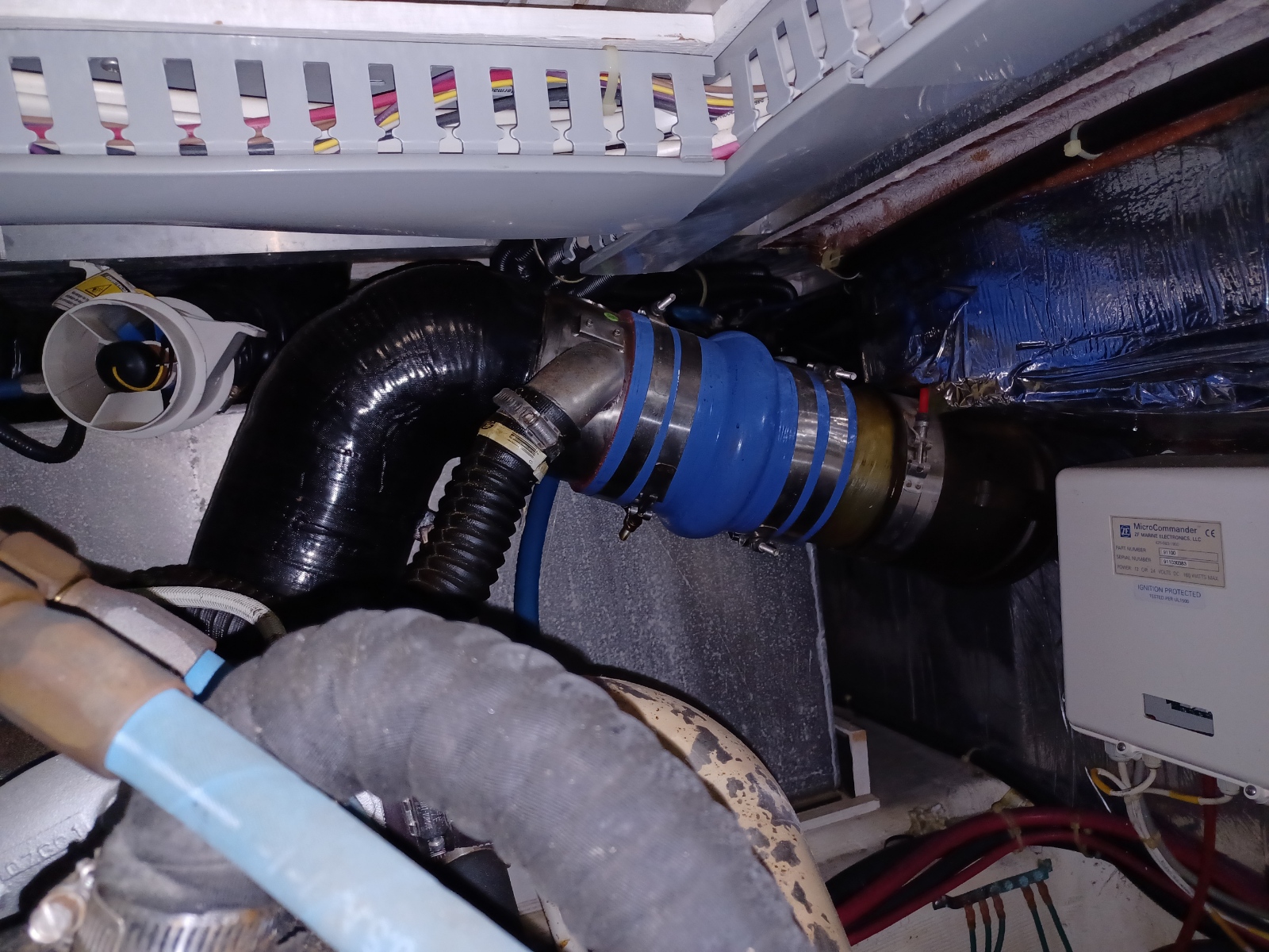

    Whisky Tango Foxtrot is this hose for??

    The dump can hose clamps are wrong and already look stressed. Needs replacements soon.
    Needed to be doubled clamped on that green stripped hose to hold that wrong hose in place.
    Every drop of raw water that that engine uses goes thru that hose to cool the exhaust, then over board.
    I can't quote the numbers that flow thru/out, but it is far greater than what your bilge pumps can remove. No slack here allowed.
    It is these little things that a real Cummins MARINE tech need to get in there and survey well.
    Then a real tech to get it rite.
