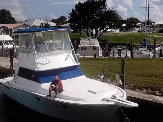

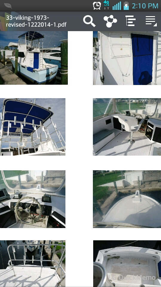

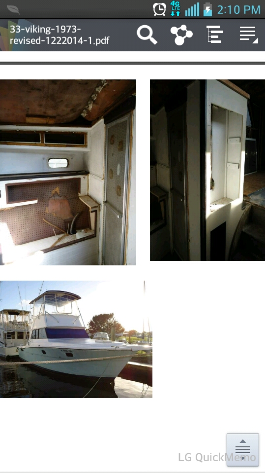

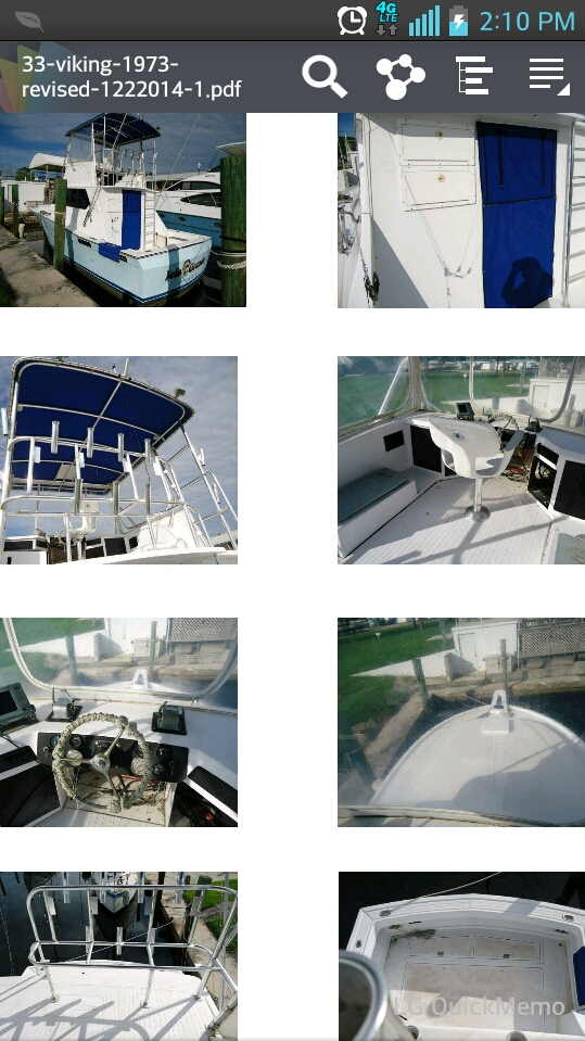

    Hi Viking Owners!

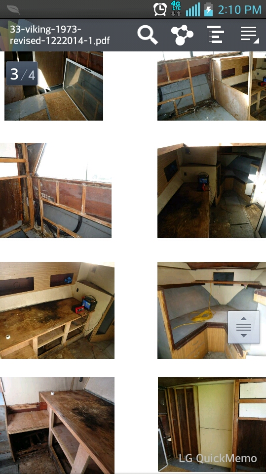

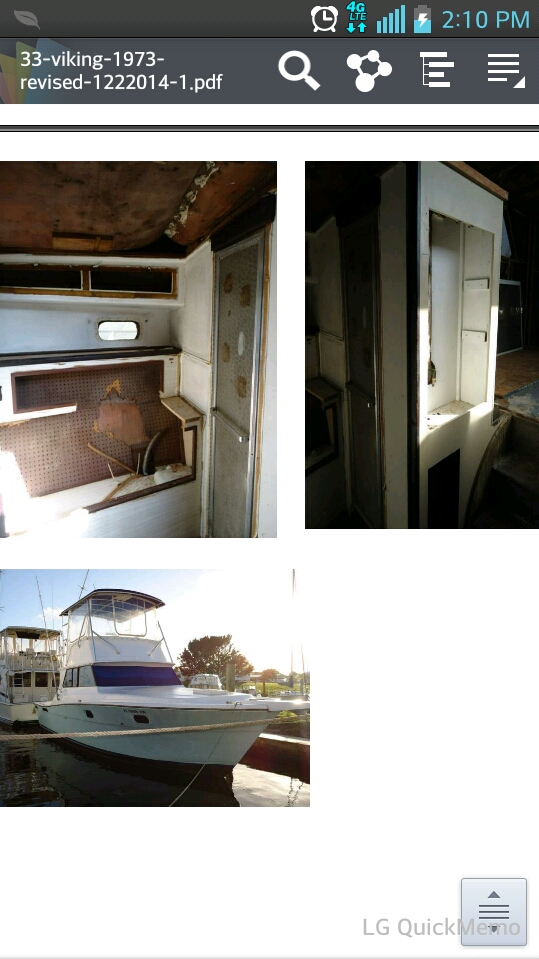

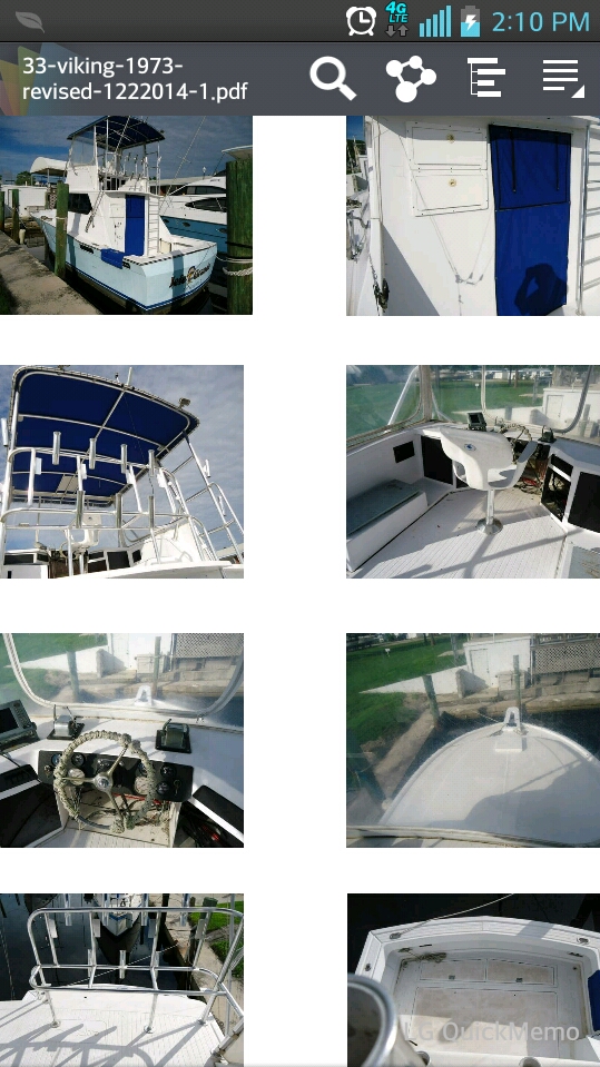

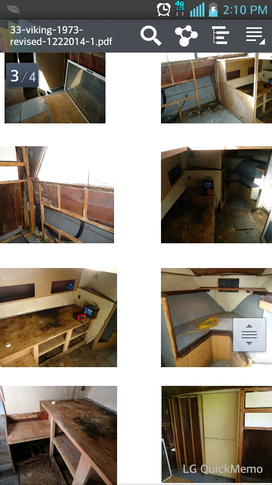

    My name is Alex and i am in the process of leaving a deposit on a Vintage Viking Sport Fish Convertible 73 33" on Monday for under 4K.
    I have some question and any input would help but i do need some direction to help with expectations of this fine beauty. I am a business minded person i have owned successful small IT and computer businesses so i wonder if a small investment here would raise the value of my Viking and if so how much. I don't plan to sell her.
    Boat details:
    The hard work has already been completed. She has new paint
    on her topside and hull sides, new aluminum framed top, ladder, and rocket launchers, new canvas, newer aluminum fuel tanks, and more. The interior has been gutted and reconstruction has been started. The 454 twin Mercruiser engines appear to be locked up. Great candidate to repower with diesel engines. Or, just build the interior the way you like and make her a spacious live aboard.
    Ok so here i go.
    I was told by a boat yacht dealer/yacht owner to open the heads or spark plugs preferably heads and add 4 qts of mystery oil and turn the motors just a hair everyday for 4 days and she just might loosen up then hire a professional mechanic to clean her up inside and remove water and rust for a restart, is this possible. I love this boat and hope the answer is a yes : ) but honest.
    Interior refit costs
    GPH estimate
    Speed and distance she can handle
    Fill up or not to fill up
    Leave her in Bahamas as a weekend getaway and visit her on my 22ft when she's ready of course for now she stays home.
    Charter for fishing and Bahamas getaway
    Costs of use
    Maintenance
    If i replace motors how much will that cost me for used direct replacements
    Should i sell my 22ft for 5k and beef up this Yacht? I want to keep both.

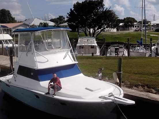

    How do you like living aboard? I might try that sometime, I imagine it would be wonderful. I hope to one day keep the viking I'm about to buy in the Florida keys or Bahamas and use it as a getaway. Is it comfortable for two anything you care to share about comfortbility or your enjoyments of it? Thanks.
    I am purchasing a 1973 Viking Convertible Sport Fish 33 with twin 454 Mercruisers. IMG_4812504393474.jpeg

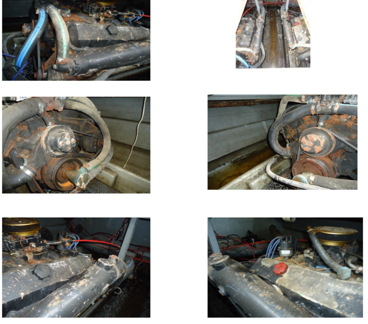

    Wishful thinking, if i can free the motors how much can i expect to pay for a mechanic to bring motors to optimal condition? If a rebuild is required what would that cost?

    Yes, definitely wishful thinking. I guess the real question is why did it freeze up. Was it over heated or could it have been water intrusion. I suppose if it sat not running for years and years that could cause it to get stuck enough for the starter not to be able to turn it over which would be best case scenario. To have them removed rebuilt and put back in, you are probably looking at 4-5k per engine (not including replacing risers and exhaust manifold which is about 1500 per engine). So that brings you back to the engines you saw on ebay for 1500. Yeah it sounds like a good deal if it has 450hrs but you are taking the persons word and we all know an engine with low hours because of it not running much could be worse than an engine with higher hours that is newer. If its an old engine, you could end up having to pull it apart and redo seals from them drying out and who knows what else. Just remember if you rebuild the engines you have, you will end up replacing the exhaust manifold and risers which I said is about 1200-1500 for each engine and with the running engine and low hours you will have to most likely do the same thing. To be honest I don't think you are saving any money by buying used engines unless they are drop in ready. If i'm going to spend money I rather have my engines be rebuilt than buying used engines and putting them and only have them have problems and go through the same process. By the way, even if you buy engines, you are still going to have to pay labor to remove the old and labor to reinstall the new ones, so with that said you are looking at the same labor either way you go. Only difference is, if you have yours rebuilt you know for sure when you rebuild them and drop them back in you won't have any issues and you know you shouldn't have any problems unlike dropping used engines in.

    I missed part of your question about if you can unfreeze the motors. Well I guess it all has to do with why they are frozen. If its just from sitting a long time it could be as simple as new rings, gaskets etc., but if it is from over heating or water intrusion you could be looking at a total different situation and have to have a complete rebuild. I really think if you are keeping the boat and planning on using it, you should just have them rebuilt. Sure you could try the simple thing first and let it soak in marvel mystery oil and try turning it slowly at the crank. You may get lucky and it unfreezes but, don't expect it to be dependable. It obviously became frozen from lack of maintenance, whether that be just letting it sit for years on end with out running, or worse case it was from over heating and even worse, salt water intrusion and it is full of salt water and rusted out.

    Hi Alex, Just wanted to chime in here. Depending on how long the motors have been siezed and the cause of seizure, you may be able to free them up. The question becomes, how much damage has been done. For instance, if they were siezed due to water intrusion via head gasket or the motors being submerged (more likely scenario if there is a common problem with both motors.........the chances of both motors blowing a head gasket simutaneously is highly unlikely), then there is presumably damage to the bottom end (main bearings, rod bearings, crank, etc.) as well as the top end (valves, seats, cylinder walls, rings, etc.). This being said, you may be able to get the motors unseized and running, but be careful about relying on them too heavily because there is likely premature wear on parts that you cannot see. My experience has been that if there has been water intrusion, it is often difficult to get a reliable story from a previous owner and you will need to assume the worst and hope for the best. If you decide to move forward on the boat (and it seems like a heck of a boat for the money......even assuming the worst), I would prepare for a repower. I have a boat restoration shop (not looking for any business!!!), but I have extensive experience and would be happy to answer any questions for you!

    CaptAndy if you'd be willing to help with some pointers or advice I'd greatly appreciate it. Is there an e-mail you can provide so we can communicate further? I'd like to ask some questions also show you some pics of the motor. I am going to see the boat tomorrow to see the condition of the motors and other area of the boat and could use some advice. Also i would like to know if you'd service the motors and how much that would be and so on. I got the boat price down even more so it is likely i will buy it. My plans are to have it ready by the summer as far as motors are concerned and in top shape (operable and reliable) then do the interior. I hope to take it to Bimini or the keys. Do you have any idea on what may be the issue based on the photos i attached?
    Thanks in advance.
