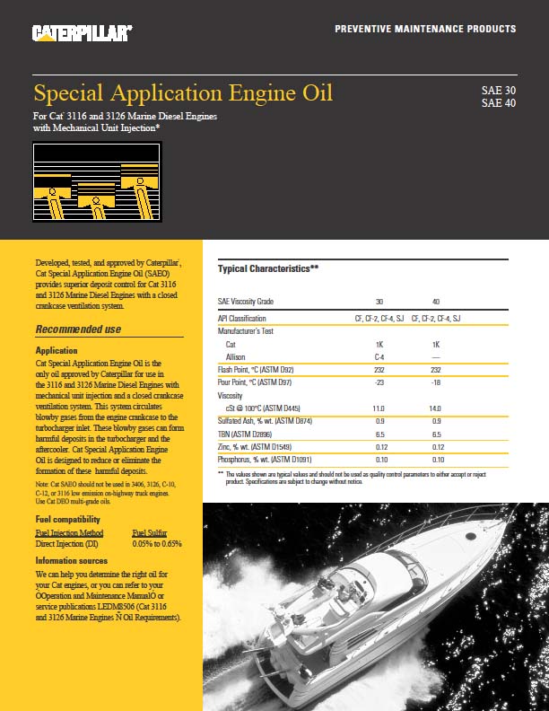

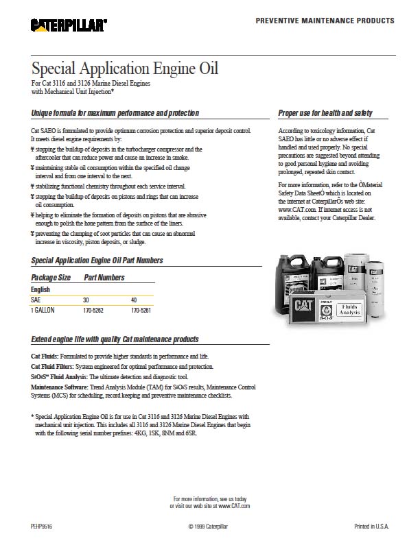

    Here is the CAT Literature about your "special" Oil.

    This is a yacht forum and this post applies to sportfish. ALA Viking vs. Cabo, that is the subject and hand that is what I am talking about. I am not talking about SHIP builders such as Feadship and others. We are talking about yachts here not even megayachts in this post, this is Yacht Forum. Ship builders may very well install their own engines. I know for a fact that Cabo and Viking DO NOT, which are the two yachts this post is talking about......unless I missed the subject line.
    Here is a list of the different DEO oil for different area's straight from the CAT website. Why is it that, you can never be wrong? Don't insult me with your lack of intelligance and lack of an open mind. Obviously you're very knowlegable about certain areas you are knowlegable, however your knowledge obviously doesn't pertain to North America or other areas. I'm not pulling stuff out of thin air.......Brazil has their own oil, Egypt and Saudi Arabia have their own, as does North America.
    http://www.cat.com/cda/layout?m=109560&x=7

    Cat installs a lighter weight oil in new pleasure craft engines and requires the first oil change at 50hrs. According to several CAT reps, it depends on the area/climate on which break-in oil is installed by the installing dealer. In warm climates I was told the 30W special application. In Northern (colder) climates....I was told it was a 5w30. This would be a dealer only memo, not something you would find on the website. The special app. oil has special detergants and such to help with ring wear and other facets of break-in, if you read the specs of it. These smaller boats usually have more HP then a 200 ft. feadship which runs at displacement speed......... a 52' Cabo can be equipped with C30 cats, 1550hp each.

    You posted about this break in oil and provided a part Number, I provided the spec sheet in this post that says plainly it is indeed a special application oil and it is only used for two engine groups. It is not used as a break in oil specifically but for normal day to day operations.
    It may interest you to know that I have asked on a number of occasions when ordering new Caterpillar engines for them to be setup to run on mono grade lube oil. This has always been declined and a threat to in validate the warranty given if mono grade is used during the warranty period.
    Now when asked again for the info on the Oil you say you know so much about you try to hide behind the dealer secrecy. As for being a dealer only memo- I would think if a special oil was indeed needed at start up then it would be needed again when the engines are rebuilt so it would be pretty much common knowledge amongst the mechanics who rebuild these engines.
    If you take the time to read some of the plethora of information that is available on the CAT Website where your link leads to you will see that there are various multi grade oils available which one is used depends upon the ambient temperature where the equipment is operating- I posted this about the multi grade oils above but I guess you didn't have the time to look and learn.

    CAPTJ- In case you are busy and don't have time to search all the links at the site just have a look at this one:
    • Cat® DEO (Diesel Engine Oil for Western Hemisphere excluding Brazil) - PEHJ0059 104k
    You will see at the first bold type heading on Page 1 that this is used as standard factory fill for CAT Machines.
    I have also had this confirmed by a fairly senior CAT Guy who told me the story of Break in Oil is a tale which has been around for years but has no substance to it.
    The link applies to Oils in your geographical area so there is no confusion that elsewhere we have different Lube Oils.
