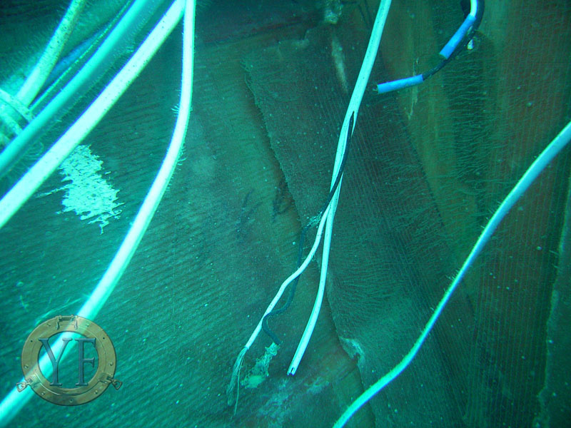

    Well, admittedly my evidence is very poor, but this picture of the bulkhead pulled away from the hull made me think it could have been caused by stresses from improper support. This pic is very cloudy but that damage just "appears" to me to pre-exist the accident. I don't have a high degree of confidence in this theory as I never observed it in storage, but this is the pic that got me thinking...

    Well -
    As far as tabbing goes,
    At least in conventional lamination
    "No scuff, no stick."
    And that surely looks like "no stick" to me.
    jsi

    Ok, I see your reasoning. I agree that there are issues with the boat having prexisting conditions, I don't personally think this is one of them as the hydraulic pressure of the incident is a much simpler and more likely thing that popped the bulkhead tapes clean like that (which should not have happened regardless of what broke it), but, who knows...
