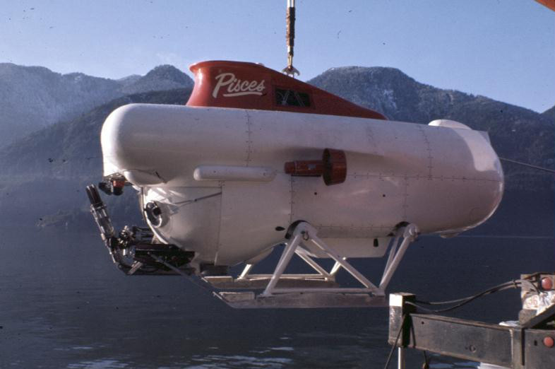

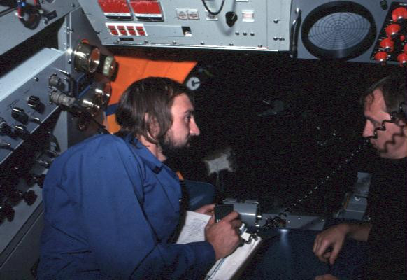

    Are there maybe some pics of this sub you could post?
  16. Marmot
    Marmot Senior Member
    May 20, 2007
    3,300
    9114 S. Central Ave

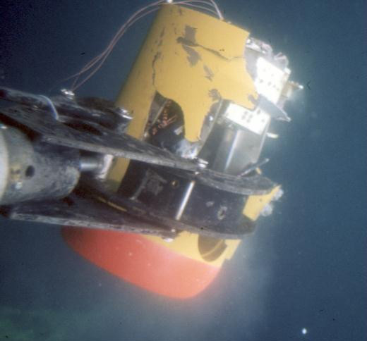

    Sure, had to scan a couple from old slides so pardon the quality.
    The odd pic shows the use of that large manipulator, it was used to recover torpedoes that didn't quite make the grade.
