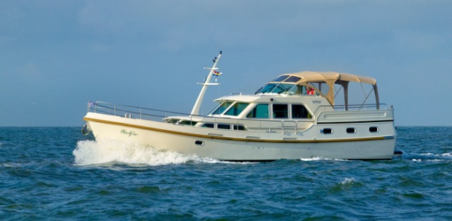

  5. HTMO9
    HTMO9 Senior Member
    Jan 13, 2009
    1,681
    Hello Brian,

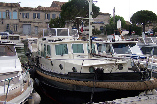

    some years ago I had the same question like you. I wanted a boat for using the inland waterways and canals in Europe, owner operated by a couple with the possibility of the occasional 2 more guests in a separate cabin with ensuite bath. Comfortable for onboard living for some weeks and capable and sized for traveling from the Swedish islands down to the Med (via inland waterways). I was open to all materials, propulsion systems, designs and sizes. The only design feature which was set, was the choice for a full displacement yacht, because of volume, comfort, speed limits and economy.
    By order of the Admiral, I started a serious and deep research. Because of my lack of experience with inland motor boating, I hired additionally a professional small yacht engineer for an independent and open research of this subject.
    We both came to the almost same result. And our result was nothing new. The wheel was already invented :). The exact same type of boat was built in Holland by many yards, because it is the most practical design for the European inland and costal waters and its corresponding laws and regulations.
    This was the result:
    Material: Steel and undoubtedly only Steel. Because of the many locks and sloping riverbanks with rocks and the many sheet pile walls, Steel with a solid rubber running strake. Anything else would not have lasted very long.
    Hull Design: Multi chine full displacement hull with frames and stringers for volume and stability, because stabilizers were not concidered suitable for the sloped riverbanks.
    Maximum size and technical data: Maximum length 14,99 meter (length because of licence requirements) x 4,8 meters width x 1,5 meter draft and 4 meter airdraft (3,5 meter with mast and windscreen down for the bridges and canal tunnels in France). Displacement max. 30 to 32 metric tons. because of the capacity of the haul out lifts in the inland boat shops in Europe. Twin engine diesel of 150 to 180 HP each with prop and shaft plus 24 volt electrical or hydraulical bow and stern thruster. Fuel capacity for 1000 NM range at 8 Kts, potable water for one week for two people plus watermaker. 8 KVA diesel genset, diesel central water heating, air conditioning, electrical cooking, no gas, no petrol store.
    And thats the way they all looked like. Aft owner cabin with ensuite bath and owner office with raised aft deck above, two steering positions, one on the aft deck, one in the salon. Engine room under salon, galley forward of salon with additional dinette and foreward guest cabin with ensuite bath. This type of boat is build only in the Netherlands but by more than two dozend of high quality yards. These boats last for ever but are an investment between 650.000,- and 2.000.000,- US $ depending on luxury and options build in. Built time one year.
    In order to confirm our research, we chartered one for two weeks in the Netherlands and found all results correct and confirmed and bought one.
    But and there is a big but. Our children found slow boating on inland water ways f...... booooooring and never joined us and they never used the boat themself. We never had the time to go down to France or through the Göta Canal with it. It was and is only used in northern Germany and the Netherlands and selling it would be an enormous loss. So it is still in the family and sits 8 month a year in a hangar on the hard.
    Answering your question: A pure displacement motorboat for slow boating on the canals is a non starter, period.
    Below the European inland motor cruiser !

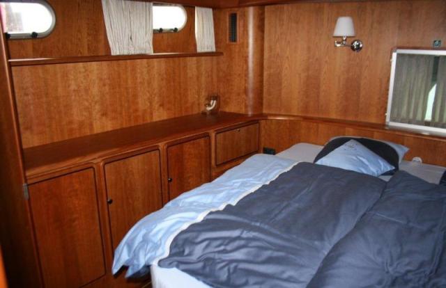

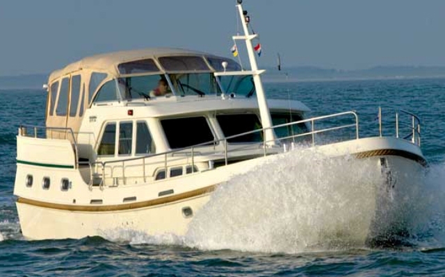

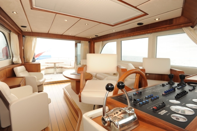

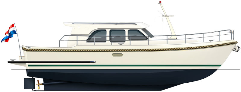

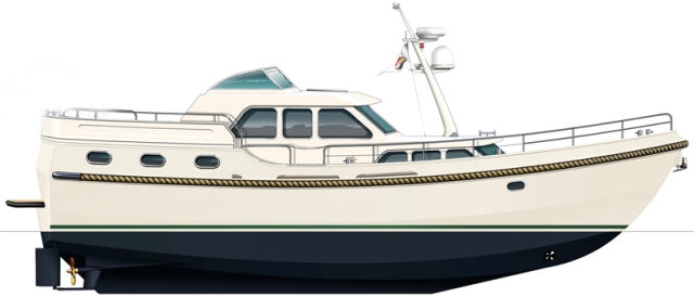

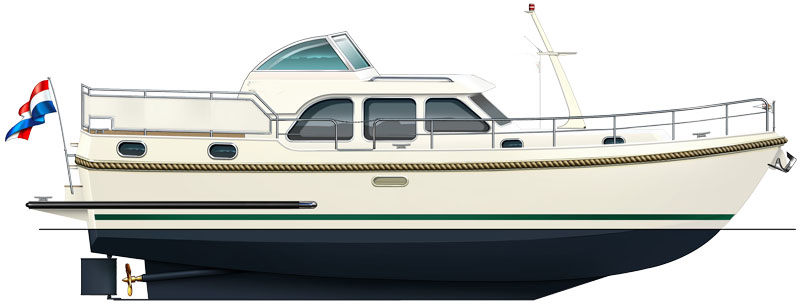

  7. HTMO9
    HTMO9 Senior Member
    Jan 13, 2009
    1,681
    Your last sentence is exactly what our kids are saying. Canal slow boating is a Hobby for elderly and retired people with a lot of time.
    Example: If I go by car from Hamburg to Lübeck, a beautiful destination on the Baltic sea, it takes about one hour on the Highway. Taking the Elbe-Lübeck Canal with the slow boat and sticking to the speed limit of 6 Kts, it takes 12 to 15 hours or more, depending on the traffic at the locks. So, on a normal weekend we do could a trip like this and back home. How will you entertain kids, if the only thing they see all day are the riverbanks and some locks. Its really a hobby for (like my son says) decelarated elderly people.
    Do not get me wrong, I like that boat very much. It works obsolutely flawless. It still looks like new. We have had no issues at all. The only thing I have to do, is filling the tanks, bunker provisions, disconnect the shore power and go. At the end of the season, I hand it over to a boatyard. They take it out of the water, clean it, do some maintenance and cosmetics and store it for the winter in a hangar. In May of the following year, I pick it up again for the next season.
    But this is no hobby or sport (like sailing or game fishing). This is the substitude of the rocking chair on the veranda of an eldery home (my son again). It is not that bad, but the average people we meet in the yacht harbours are in the upper 60 or older. Younger people we see, always drive semi displacement or planning boats. We use it maybe 4 or 5 times over the year for a maximum of one week at a time. The rest of our boating is sailing in the Med. And this boat has a permanent crew with skipper and is a totally different story (racing, beautiful scenery, weather, everything).
    That leeds to the resale value. Boats like this are bought by older people only. If somebody is able to invest more than half a million $ on a boat, he will not accept compromizes. He will rather buy a new build exactly according to his specs and personal needs. So, the losses on resale will be tremendous.
    Thats why most people keep those boats until they die.

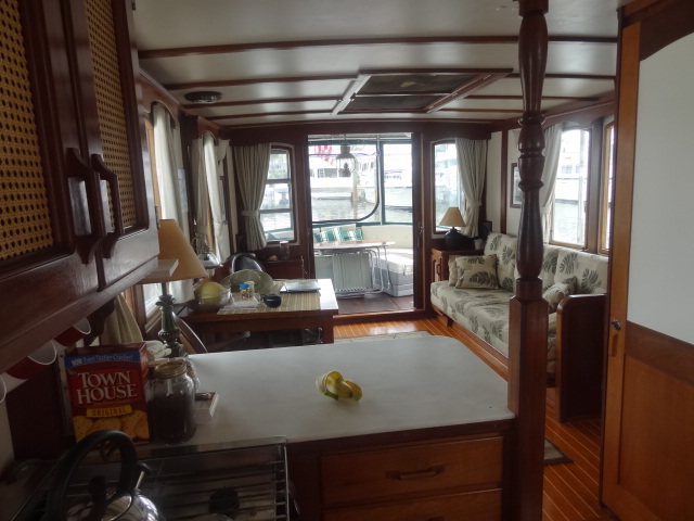

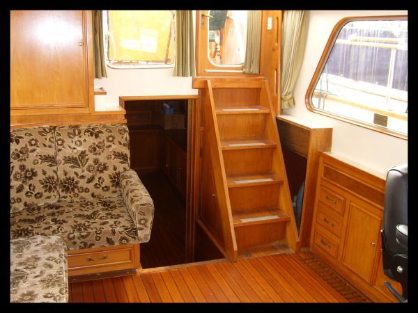

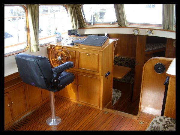

    It can look like this inside,...and a nice aft deck

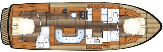

    Hello Brian,
    The main difference of the usual European inland cruiser and your favorite type of boat is our European air draft restriction and this stupid length limit of 15 meters for inland waterways. Bejond that length, you would need a commercial inland waterway skipper licence.
    Therefore we have this split level type boat, in order to make maximum use of the possible volume. This has pro and cons on both concepts.
    Your Missisippi steamer type canal or river boat has far to much airdraft for Europe and is probably less seaworthy because of its higher center of gravity and lower freeboard for the occasional open sea crossing or coastal cruise. But the living space inside is much more convenient, because all facilities are on the same deck level. All technicall stuff is below deck and only accessed when needed.
    On our boat you are always running stairs up and down, wherever you need to go. But this is the tradeoff for this large living volume on only 49 ft of lenghth and 11,5 ft airdraft. There is no standing height in the engineroom but you can remove the salon floor and the engines can be pulled by crane through a large hatch in the salon roof.
    The two engines are really needed only for maneuverability and less draft. A single 250 HP high torque diesel engine would have done the same job. But the bigger prop would have given more draft and less flexibility, when moneuvering. The economy is not bad. The two Volvo Penta D4-180 consume together some 2 Gal per hour at 6,5 Kts, 4,3 Gal at 8 Kts and some 6,5 Gal at 10 Kts. WOT would not make the boat any faster, just much more noisy and more thursty (hull speed limit). The range with the 550 Gal of diesel fuel is about 1.000 NM at 8 Kts (no reserve). This is sufficient for a 14 to 16 days cruise at 8 hours cruising a day (Which is more than enough for decelerated eldery people like us :D)
    This includes the production of AC power, as the boat has a second high capacity alternator on each engine which produce (all 4 alternators together) a combined DC power of 560 Amps at 24 Volt. This converted by an 10 KW Victron inverter bank into 230 Volt AC, produces all the DC and AC power, the boat needs during cruise. The variable speed DC genset is only needed to charge the big battery bank of 1200 Ah at 24 Volt, if the main engines are off and no shorepower is on hand. The heavy battery bank sits on the keel and is very convenient for the stability of the boat. If we go on Anker with no shorepower, the battery last the whole night (without air conditioning and watermaker) but including cooking. The DC gen starts automatically, if the battery drops below 40 % or as programmend.
    The stability of the boat is sufficient for inland waterways and rivers and even for a coastal cruise on a nice day. We went offshore once at seastate 5 with gusty winds. I must say, the Admiral was not amused. If I would buy the boat again, it would have a Gyro stabilizer. To late, no space left for one of those goodies.

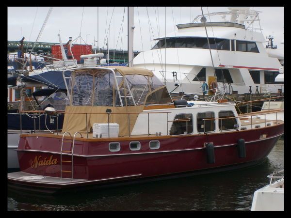

  11. brian eiland
    brian eiland Senior Member
    Jul 28, 2004
    3,020
    St Augustine, Fl and Thailand

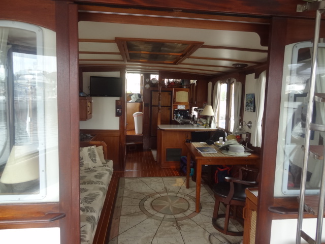

    Dutch Stella Maris

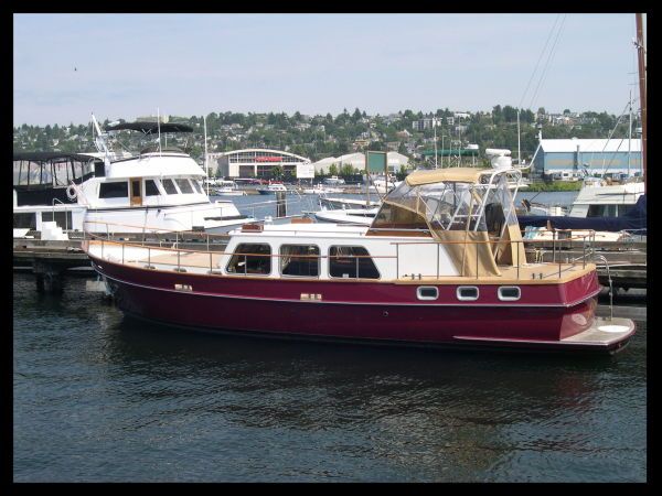

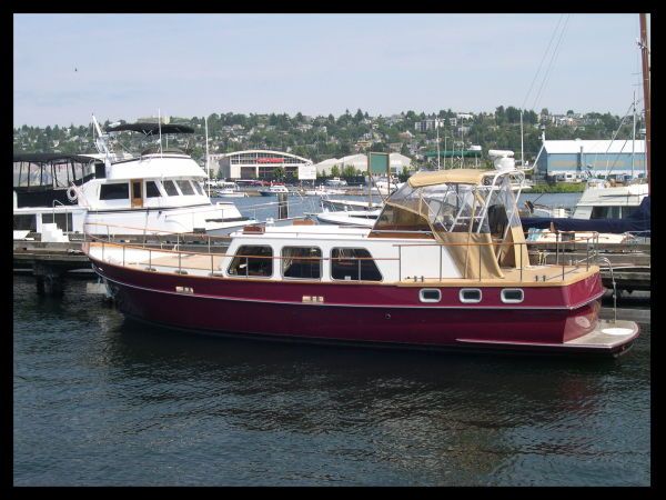

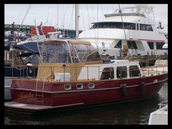

    Your vessel reminds me somewhat of a good friend's 44' Custom Dutch Steel Stella Maris. Are you familar with these? He bought it to do the waterway trip up to Alaska, and he did it in a two year time frame.
    NOTE: He added that arch at the stern and the covers for the outside steering station. It had none of this when he bought it.
    Problem now is the vessel is out in Seattle, and he is back here on the east coast between Nova Scotia and Florida. He has it up for sale, but I've suggested he might get a price on shipping it by truck back to the east coast.

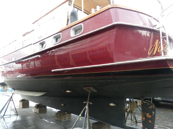

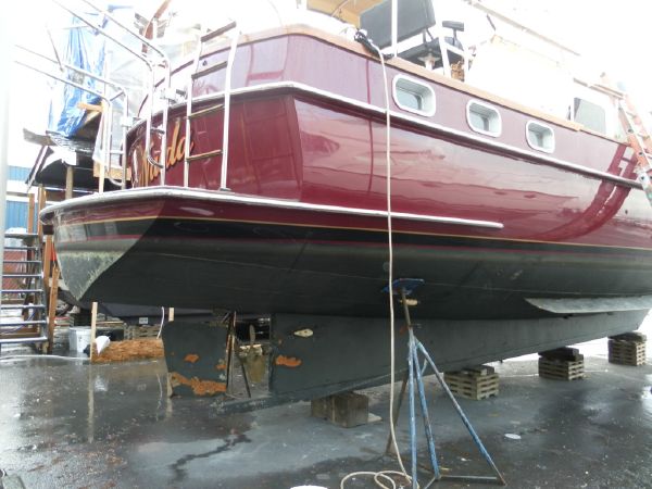

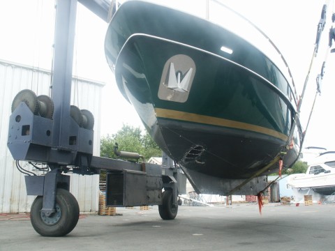

    Do you have a photo of the bottom? Here is the bottom of that Stella Maris,...almost sailboat like in some aspects. In fact I thought maybe that usede this same hull form for a motorsailer design?
  13. HTMO9
    HTMO9 Senior Member
    Jan 13, 2009
    1,681
    Hi Brian,
    that boat follows the same principle except for the missing of the distinctive raised aft deck. But your example seems to be a round bilge steel hull ? Without stabilizers that hull might roll already on a wet lawn :).
    Below a profile with underwater body. Hard multi chine optimized for a cruise speed of 6 to 8 Kts. Above that, it pushes a big bow wave and gets thursty. But a very sturdy design, that can take a bump. With higher waves on the nose, it gets noisy and slowed down by the waves. Its designed and made for protected inland waters.

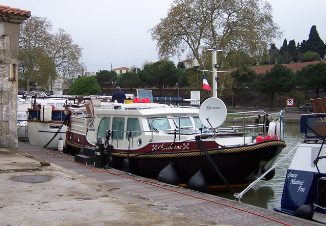

  14. Marmot
    Marmot Senior Member
    May 20, 2007
    3,300
    9114 S. Central Ave
    Is that one of these?

  16. Marmot
    May 20, 2007
    3,300
    9114 S. Central Ave
    I like the looks of those boats, here is another one cruising the canals:
