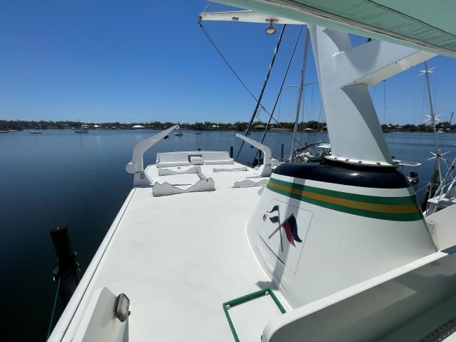

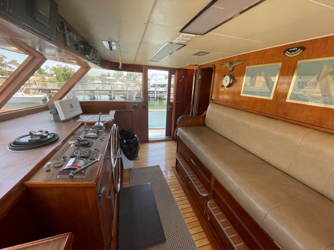

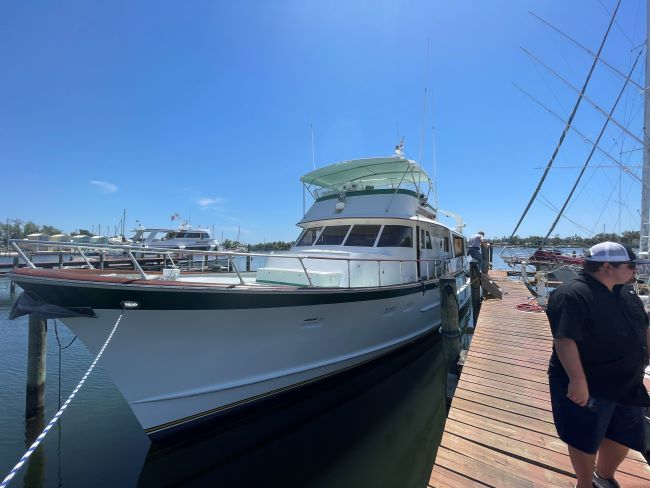

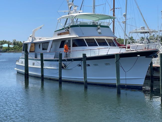

    A few photos to start with.

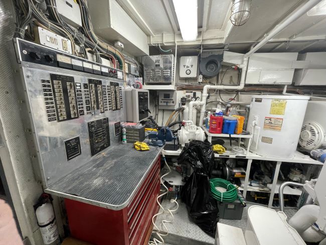

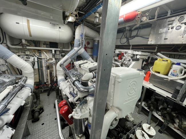

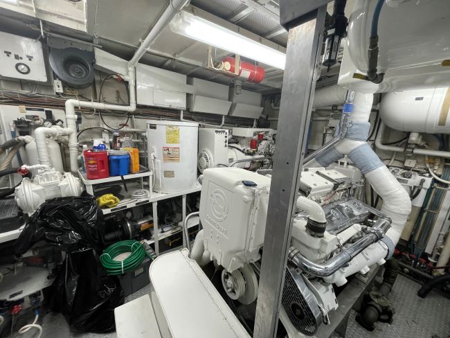

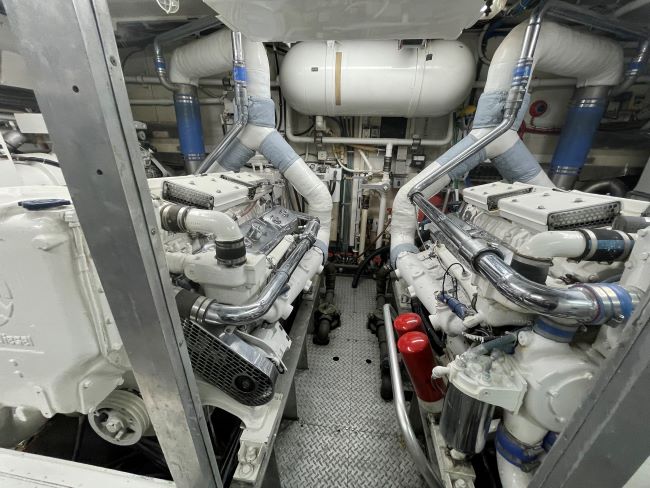

    rocdiver, bayoubud and MM3 like this.
  3. Capt Ralph
    14,585
    Ah sweet. 12V71Ns, Older NL gen-sets.
    I do not see the spread between the engines as I was expecting.

    It's around 28 inches between the manifolds.

    So. Need some specs;
    Clutch model and reduction?
    Shaft size?
    Wheel diameter?

    Really a great looking boat. Especially for its age. I'm very jealous of the space in that engine room and access around the mains. What is the large cylindrical tank in the overhead of the engine room aft of the mains? Is that an air receiver? Or a fuel day tank?
  12. Capt Ralph
    14,585
    I believe air tank.
    Like some ole Huckins I used to work on, that big bottle was under the aft master bed.
    Engines air starter reservoir.
    Gad I luved that air starter sound.
