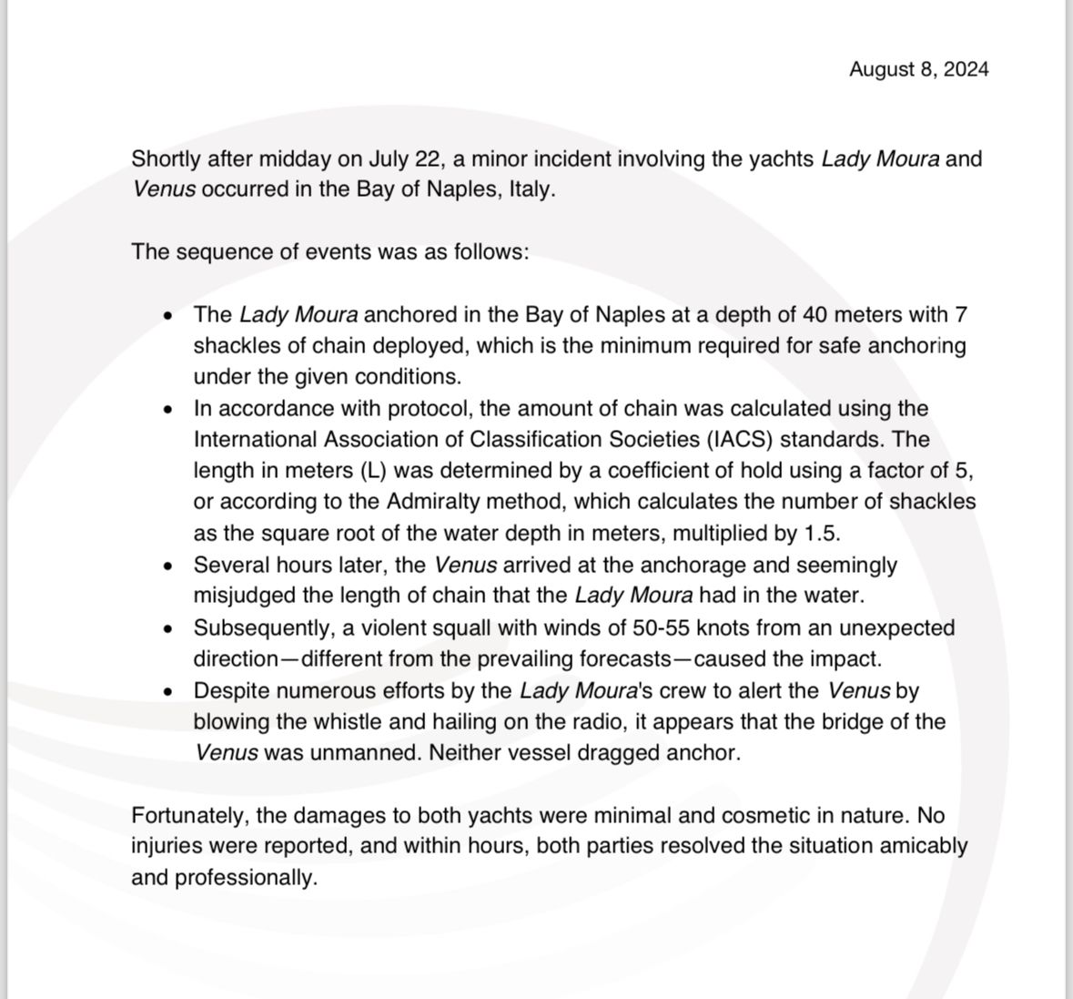

    Lady Moura statement:
    Lady Moura anchored in the Bay of Naples at a depth of 40 metres with seven shackles of chain deployed, which is the minimum required for safe anchoring under the given conditions. Several hours later, Venus arrived at the anchorage and seemingly misjudged the length of the chain that Lady Moura had in the water.
    Subsequently, a violent squall with winds of 50-55 knots from an unexpected direction – different from the prevailing forecasts – caused the impact. Despite numerous efforts by Lady Moura's crew to alert the Venus’ crew by blowing the whistle and hailing on the radio, it appears that the bridge of the Venus was unmanned. Neither vessel dragged anchor.

    I didn't report the last part of the statement...it then concluded that damages to both yachts were minimal and cosmetic and that the situation was "amicably and professionally" resolved.
    No you don't. From what I understand, it's Venus which could have used more chain out to avoid Lady Moura. But it seems the crew on Venus was unaware that any of this was taking place.
