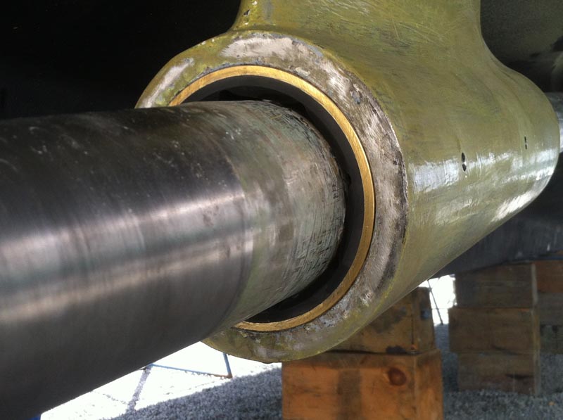

    We are hauled out to change the cutlass bearings on both main struts as well as the intermediates. Minor other work as well. Back in the water in under a month.

    I called SeaWorthy Services and asked if they didn't like me ... because they were already done with the bearing replacement job and maybe they were trying to hurry me out of there, lol. Props/shafts/struts still looked great with the propspeed from Viking in the spring- we just didn't have the time to do the bearings then. Of course it was taken off the shafts so they will get a new coating. New shaft packing, and soon new turbo heat blankets and some new ME air filters. Minor glitch in the UW lights fixed and same with one trim tab. If you want to see the boat out of the water now's the time!

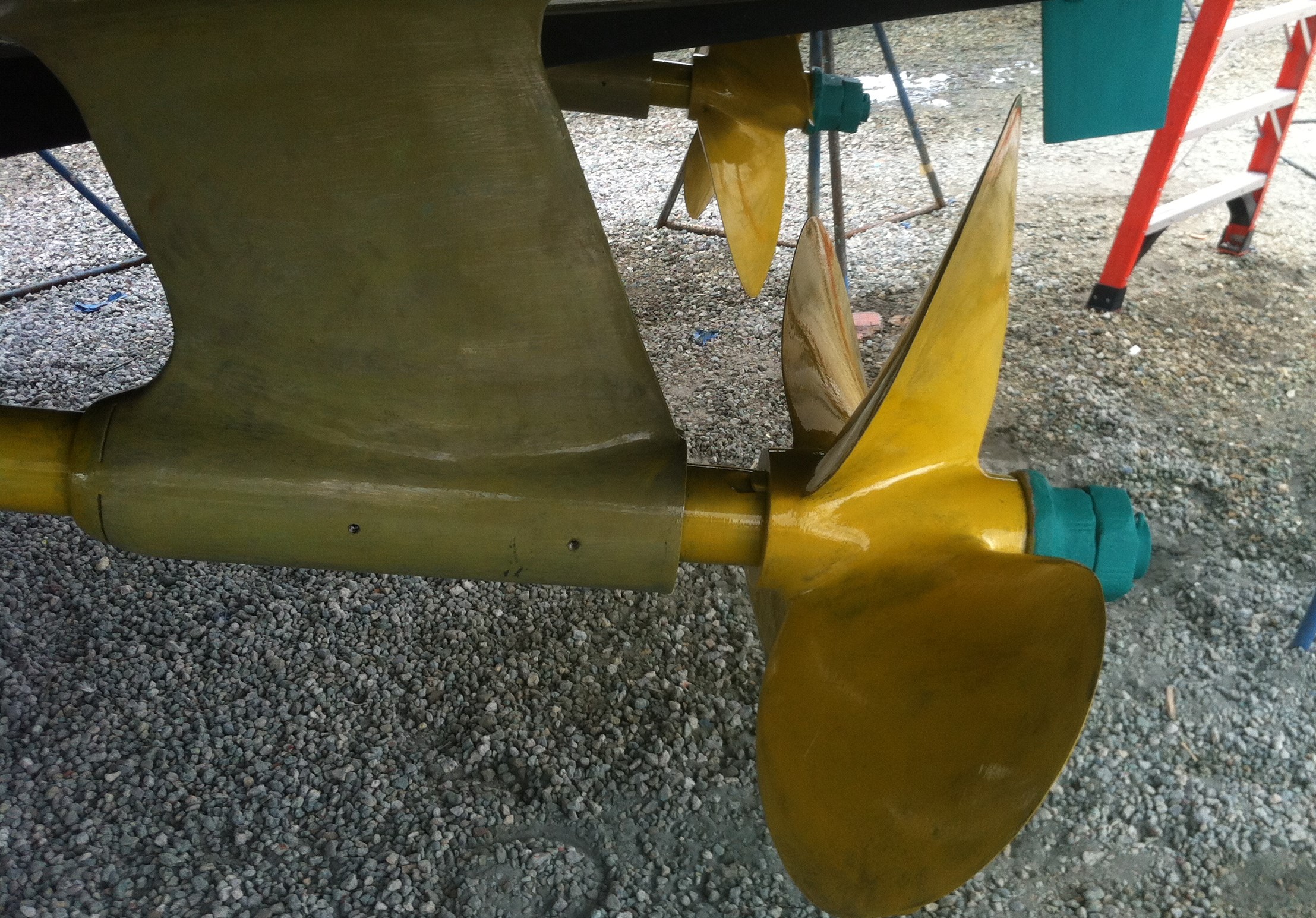

    Oh, that shaft looked low in that strut.
    ,rc

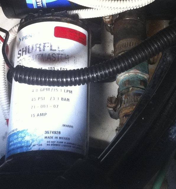

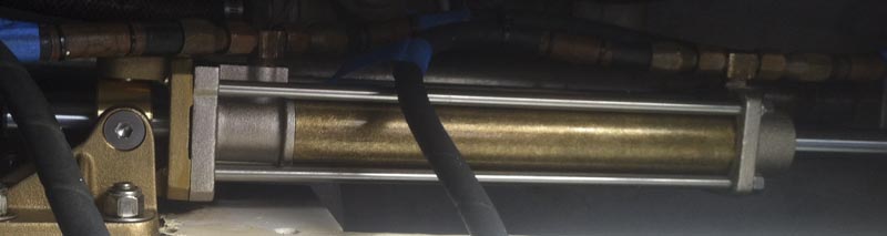

    New steering ram; one of two in the lazzarette (the other one is a 5(?) years old). The old one lasted since before I was on the boat but the shaft was slightly pitted and the seal had a pinhole leak. No point in resealing a 12 year old ram since steering is kinda important... ;)
    New macerator evacuation pump for the live well, and a bit back I replaced the 12v live well pump as well. Note to self: don't clean the labels with Spray 9.

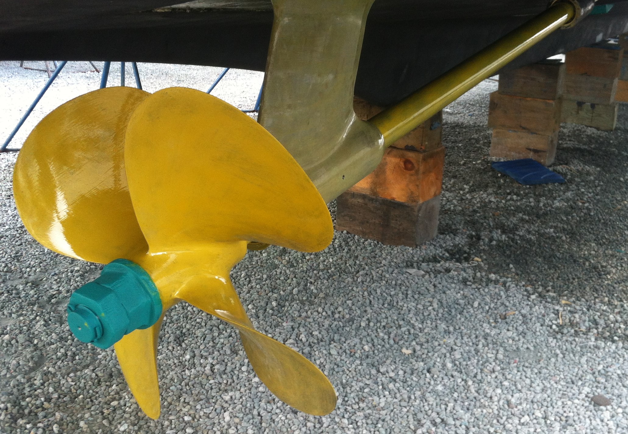

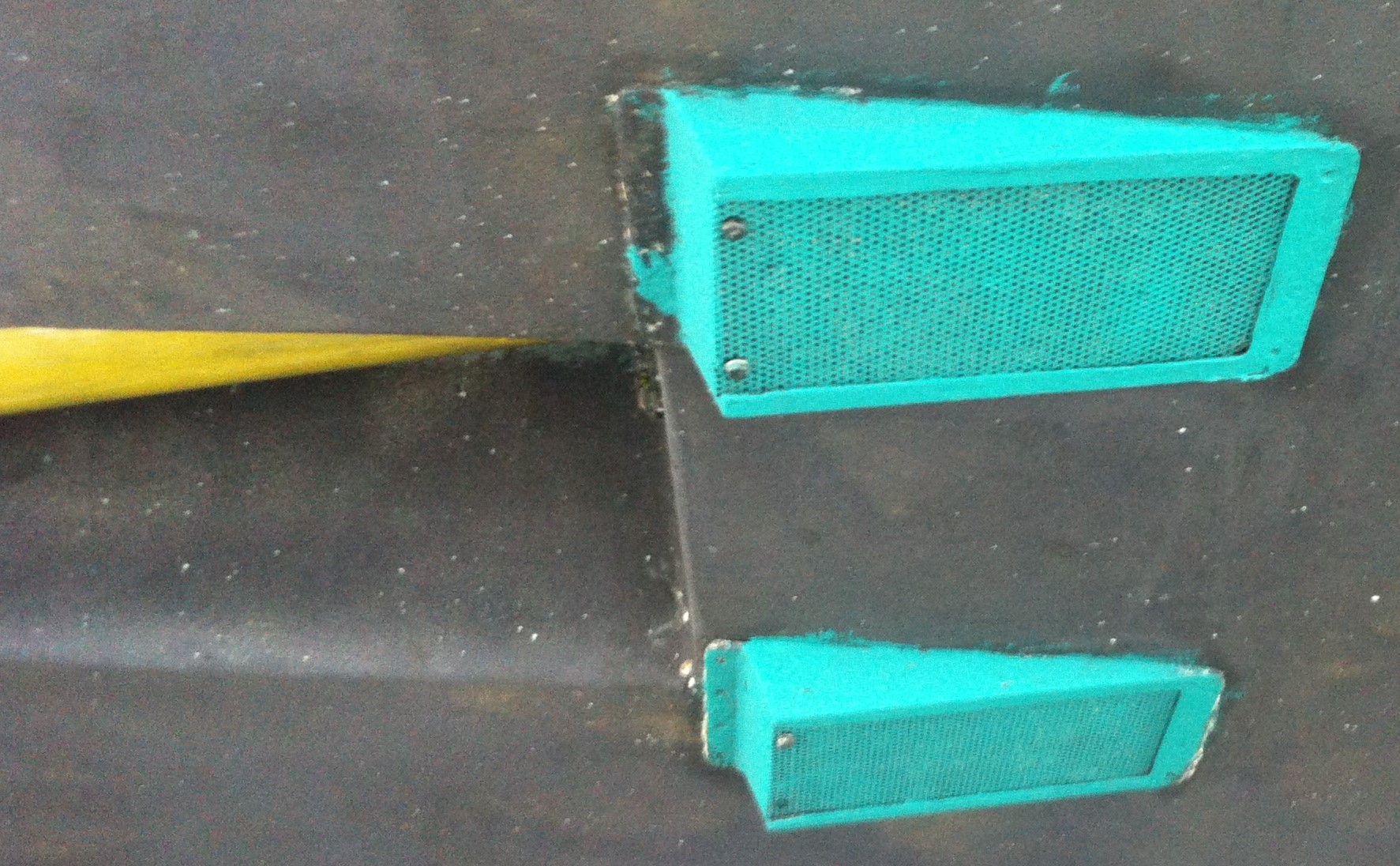

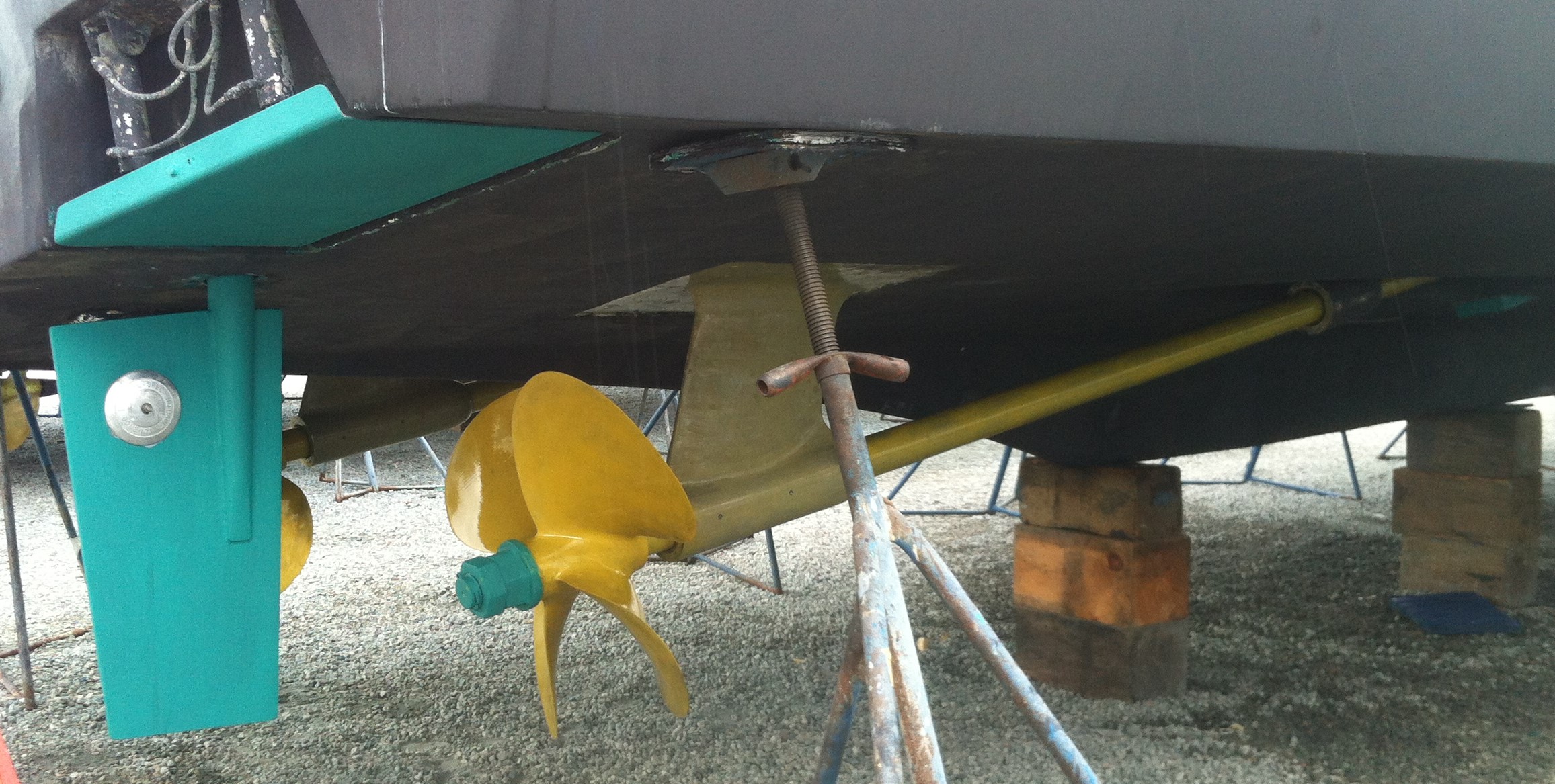

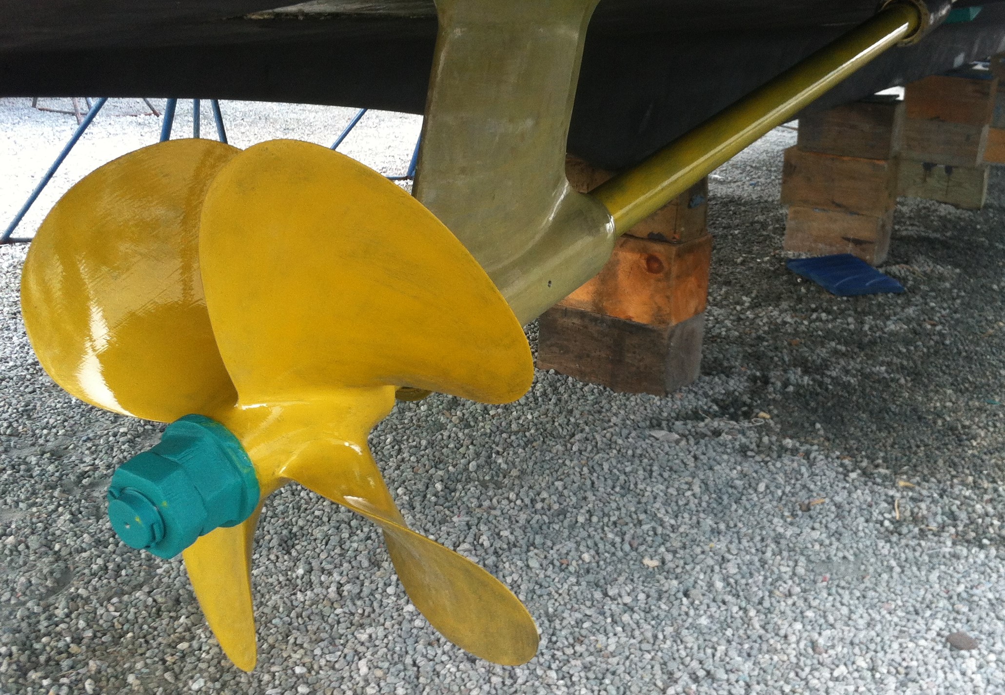

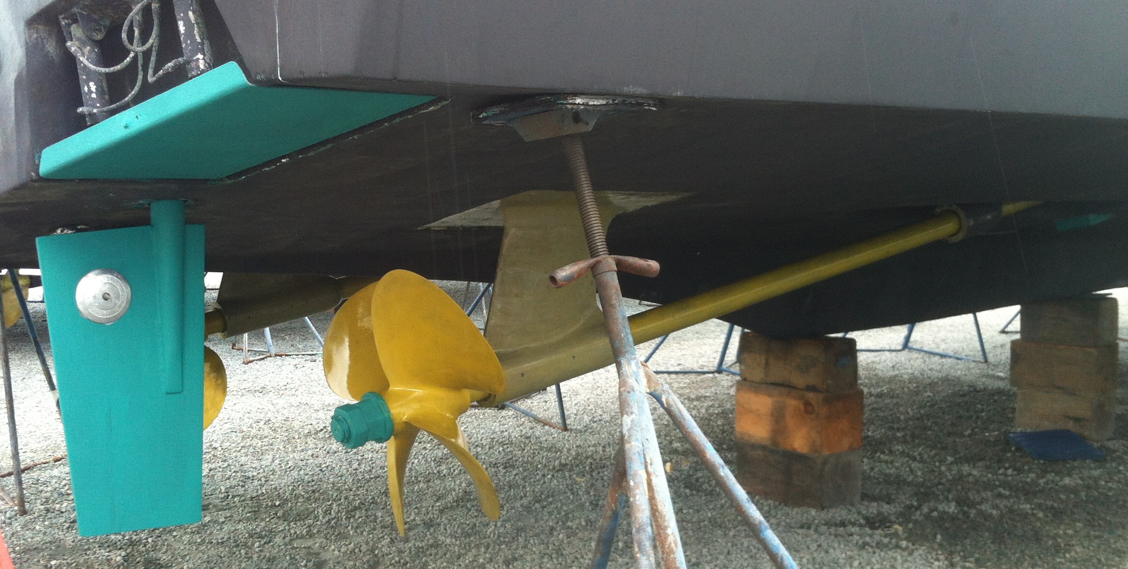

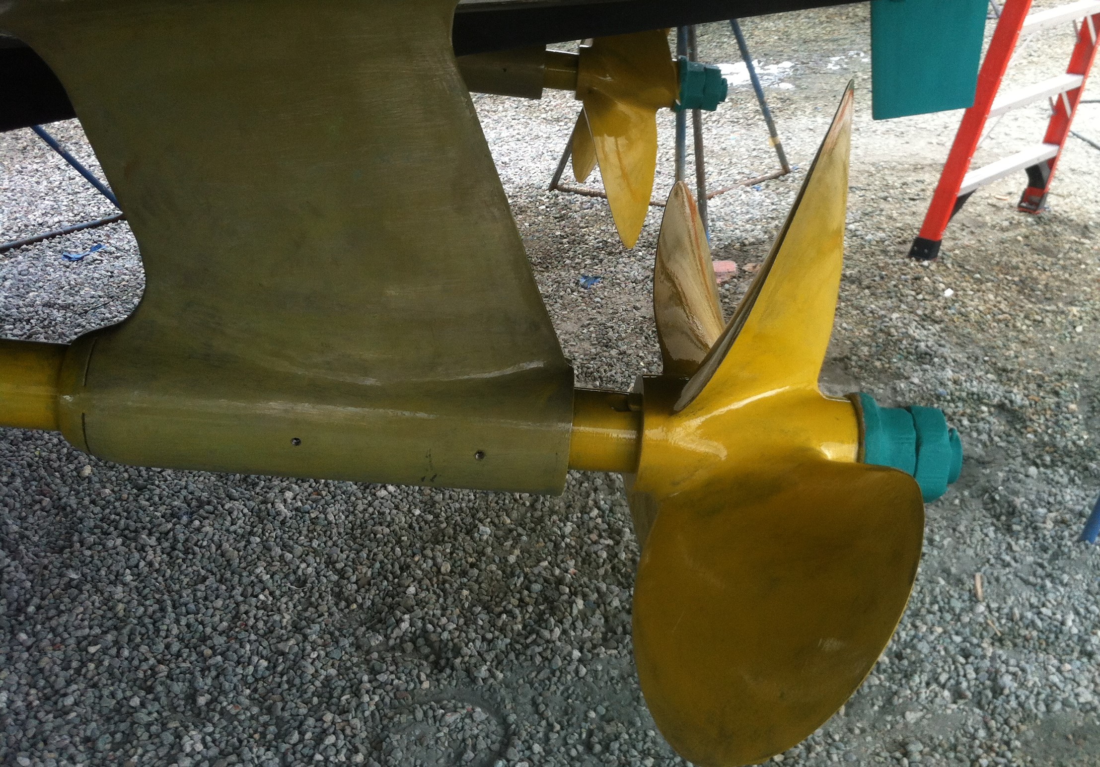

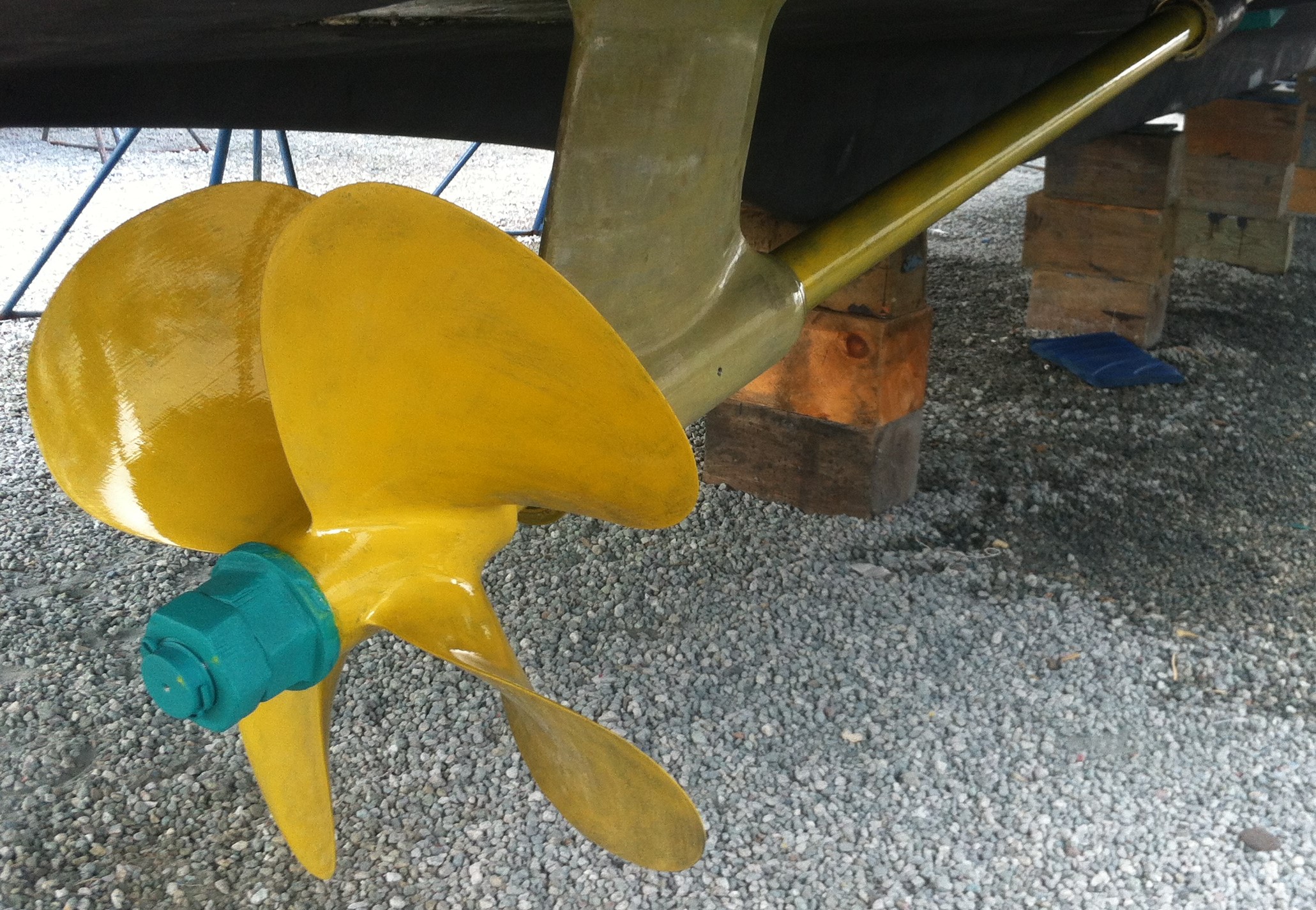

    Are thumbnails ok? My camera is my iphone4; I don't see settings to make the pics take up less pixels.
    Notice the spring time applied propspeed on the strut vs the new on the shaft and propeller. New green bottom paint on the trim tabs, rudders and intakes. Of course I pulled the screens and painted the inside. Rest of the paint was good to go.

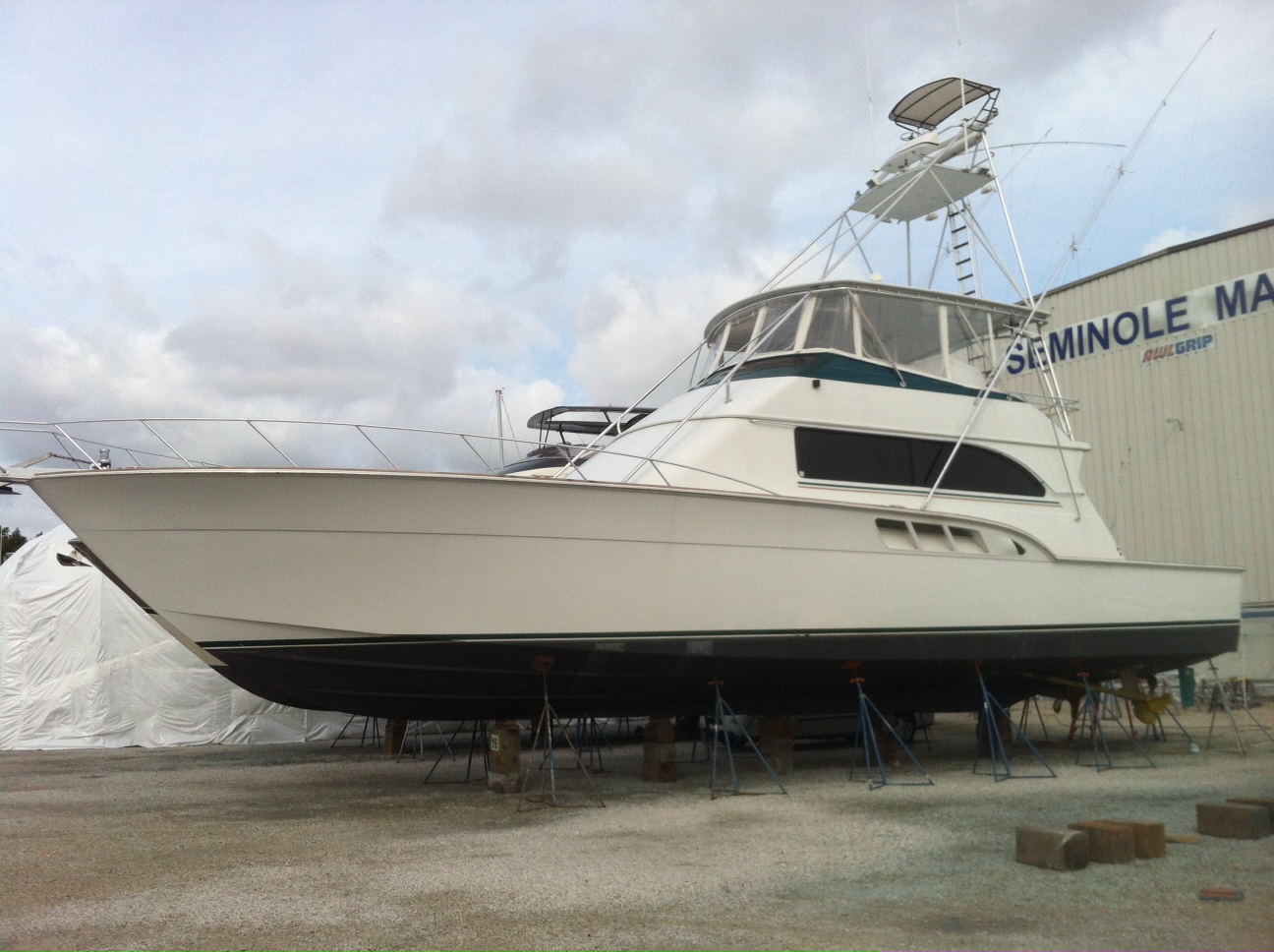

    seminole Nov 2015 hull.jpeg Last pic before we launch...
  19. Capt Ralph
    14,548
    Ah, the Old Seminole yard. I used to run boats in/out of PGA Gardens Many years ago.
    They always treated us very well then.

    After all the arguments here on YF, Your nuts (prop nuts) are still on wrong.:D
