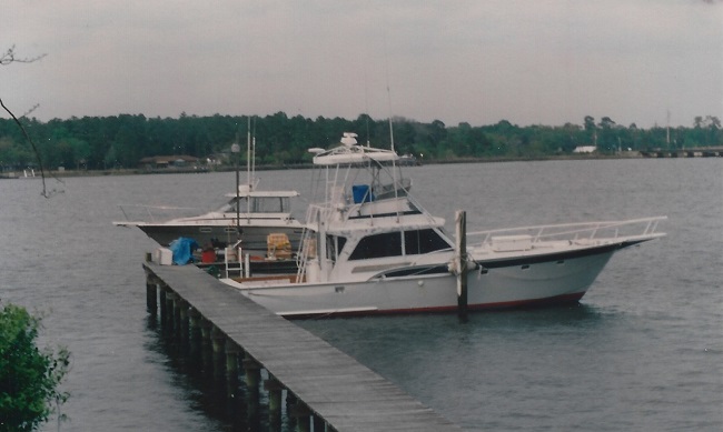

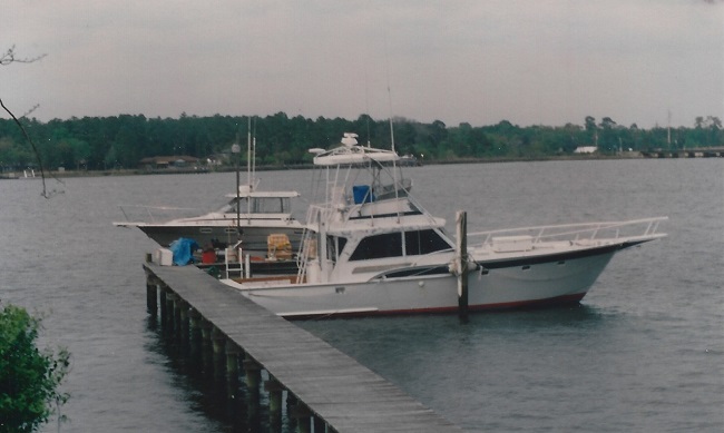

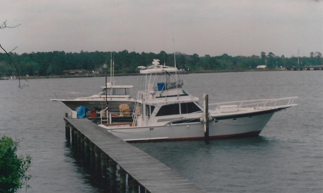

    Found a pic. Here is that 44 that I managed.
    Un-loading her of stuff to pull up the deck plates over the engines.
    That recliner went and stayed on my back porch. Most of what other came out was trashed.
    Amazing how well boats run empty of stuff..
    Got lots of fuel tank stories on this boat.
    That was my dock on the Trout River, Jax FL.
    My 28 Trophy in the lift.
    This would be around 1988/89
