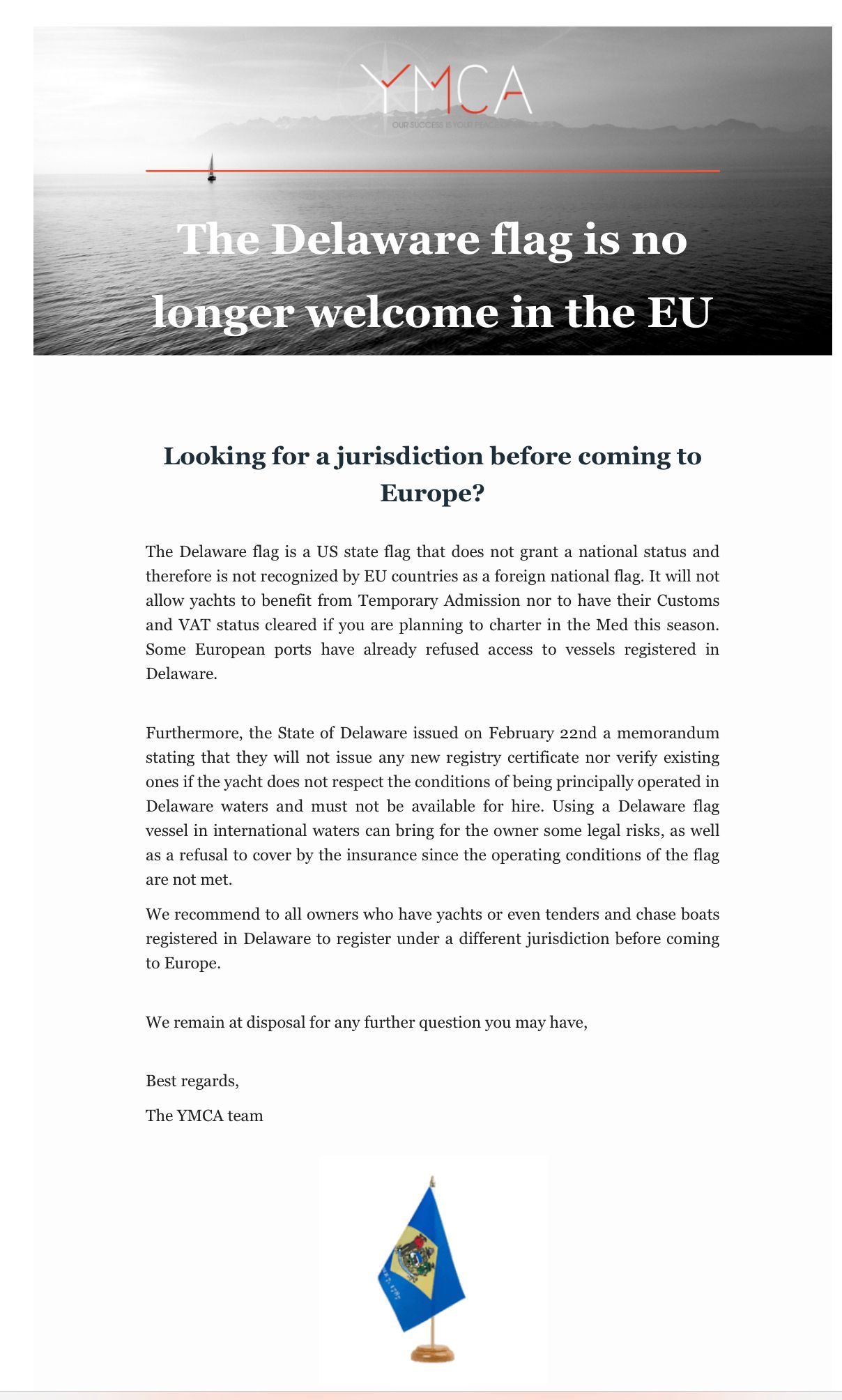

    Not accepting US flagged vessels homeported in Delaware is crazy. I wonder why that is. I m also wondering about the language used in this notice. Yachts registered and homeported in Delaware don’t “fly the Delaware flag” but the us flag
    No worry for us though as our homeport is FL.

    There was a time when loads of tenders were registered in Delaware, and these are the people who will really be affected by this. Ours were registered DE under previous ownership, but we added them to our Cayman Islands official list of Tenders and Lifeboats.
