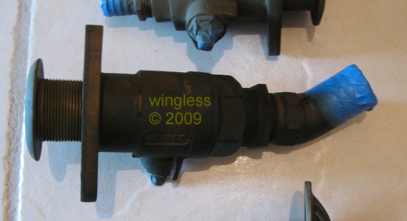

    The seacock valves on my boat would never have the desired feel when opening or closing, regardless of lubrication or frequency of movement.
    All my seacock valves were reworked by me to remove the stem and nylon seal washers behind the handle and gland nut.
    All of those parts were cleaned, lubricated and reassembled.
    The gland nut was tightened to attain no leakage and proper handle movement.
    Now all my seacock valves have an excellent feel when opening or closing.

  18. wingless
    wingless Member
    Dec 20, 2009
    35
    East Coast
    Sorry for my failure to conform with that rule.
    Thanks for correcting my error.
    Here is my seacock image that is hopefully properly uploaded now to the forum. This time I pressed the Upload a File pushbutton below the text on the reply.

  20. wingless
    wingless Member
    Dec 20, 2009
    35
    East Coast
    The OP finds the seacock difficult to move. My reply w/ image is a direct response to the OP question.
    My seacock valves also had less-than-desired action.
    My post describes the method I followed to attain excellent action on the seacock valves.
    The rework I created is totally different than the recommendations from others, like using a Zerk fitting on the drain to inject grease. When I spoke w/ the seacock manufacturer they specifically instructed AGAINST that action, that it could cause permanent damage to the seal.
    The missing / now restored image shows the type of seacock valve that I reworked, because there are different styles. The OP does not know the seacock model.
    Best wishes and good luck resolving your issue.
