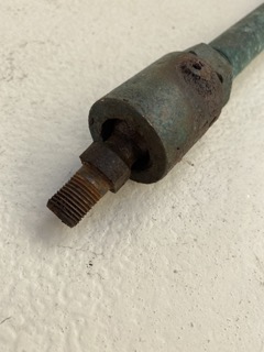

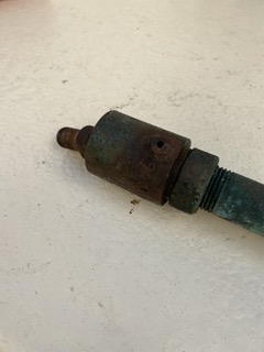

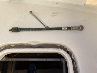

    I'm not sure what else to call it- it attaches the piston of the ram to the tiller arm. I replaced both rod end ball joints at the outboard end (big thanks to Greg Page) but the port inboard link has a ton of wear and is loose. Has anyone had luck replacing one of these? (Pictures include the wrench that was keeping it from rolling away)

    Try McMASTER CARR I found my ends there.

    I saw them online at a couple places the same time I was looking for the boots. Here is one place I saved with a part number. A few daily shots of PB Blaster before working on it usually works well.

    **** you are right about that. Perfect match though. I'm glad only one needs to be replaced right now!

    Place on the PDF has them listed about $40 less, don't know about stock.
