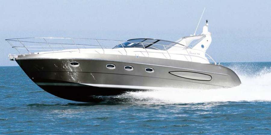

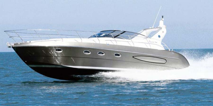

    Mind, I have no reasons to doubt of your knowledge/experience, but as an Italian and as a Mediterranean boater, I never (and I mean it!) came across any boater who know what exactly the CE Recreational Craft Directive is all about.
    What most boaters know is just the CE categories synthetic description, i.e. the brief statement that Norseman included in his post #107 (for CE-A category - there are other similar descriptions for B, etc.).
    Trouble is, the technical requirements and procedures required to qualify for CE-A category approval are nothing to write home about, to the point that for boatbuilders it's just a matter of deciding which category to go for, depending mostly on the value they place to the higher category from a marketing standpoint - nothing else.
    In fact, there is no such thing as a "normal" pleasure boat that anyone in his right mind would consider safe in 4+ meters breaking waves created by sustained F8+ winds - regardless of CE category.
    There are several examples I could make of boats built to Cat-A specifications, which are waaaaay LESS seaworthy than others for which the builder just preferred to apply for CE-B (whose conditions are already a stretch for most pleasure boats, particularly the planing ones).
    But I think the following is one of the most self-explanatory: it's a pretty common 40 feet open boat, whose builder was one of the first to jump on the RCD bandwagon, strictly for marketing purposes, and decided to build all the models in their range to Cat-A specifications.
    As a result, believe it or not, this boat is Cat-A certified, in case you might be interested to consider it.
    The good news is that you could as well cut windows in her hull, because if you would be mad enough to go out with her in Cat-A conditions (just because that's what it says on the tin), I'm pretty sure she would fall apart anyway, with or without them...! :D
