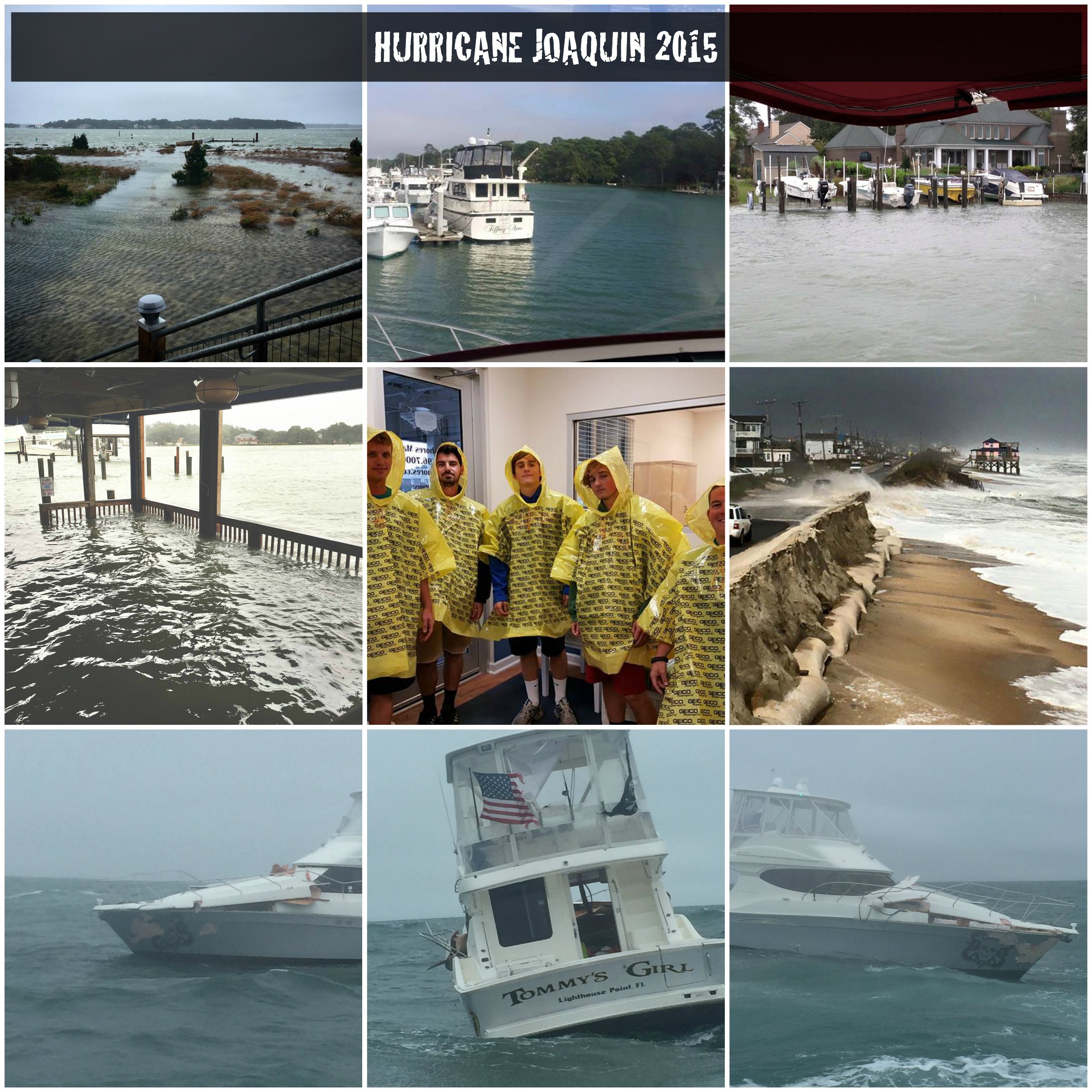

    I still think the marks on both sides of the stem mean something. Can anybody spread some imagination and help me?
  2. johnjen50
    johnjen50 New Member
    Mar 23, 2013
    6
    Portsmouth RI
    Ok, really out on a limb here, but what if this was a frontal collision that happened PRIOR to the boat embarking on its course, and the captain said screw it I'm getting the boat home, or wherever, and took off believing the vessel watertight. Not prudent or smart. I keep looking at those marks you reference and they seem to me to indicate an impact that would have caused the separation of the foredeck cap, almost like a really hard slam into a ship, as you suggested, or a dock, where the boat was wedged in some way. Either way, I think it is possible the damage occurred before the boat left on its trip.
    I see in this photo (better resolution) the bow markings appear to be a Skull and Cross Bones design or bow art.

    Hummmm. Maybe not damage. Glad you responded.
    What are those pale splotches, white-out?
    Thank you for your young eyes and extra look.

    Looks like core to me, where the gel peeled back.
  7. olderboater
    olderboater Senior Member
    Sep 2, 2013
    7,127
    I'm wondering if the total pressure caused the peeling rather than it being a sign of collision. It doesn't look like the result of a collision. Had they run into something the very front of the boat would surely be dented badly. Having a collision on both sides of the boat is difficult. I am thinking once the foredeck broke loose, the delamination happened, water got in, that all he.l just broke loose on the boat. Maybe the visible damage even came from inside out. Once the structural integrity of the boat was destroyed, then no telling what could happen.

    Looks a lot like the 63 Bertram that sank off South Carolina a few years back.
    In the photos of the sunken Bert, you could clearly see the nice shiny resin underneath where the tabbing separated. Curious to see if something similar happened here.

    That last picture looks like a wrap type covering is peeling back some here and there. The I looked at the stern.. is there a chunk out of the Port quarter ?

    The port quarter looks like another decal of some sort...

    Yes they are big skull and cross bones stickers. But the paint above and foward of the skull and cross bones is peeling. I don't think there was any frontal impact. I think the paint peeled off from flexing. The sea state really is not that severe in the photo's, perhaps 3-4' and don't understand why they couldn't have brought the vessel in under it's own power as the hull seems to be floating at normal waterline and the hull seems intact.

    To me it looks like the anchor was pushed right into the hull on the bottom left picture, forcing the deck back. I think there was an impact on the pulpit below the rub rail.

    Anyone else notice the foredeck appears to be a separate part from the rest of the deck and superstructure mold? Photos 7 and 9 of the port and stbd sides, you can clearly see the perfect vertical and horizontal lines where it sheared off.
