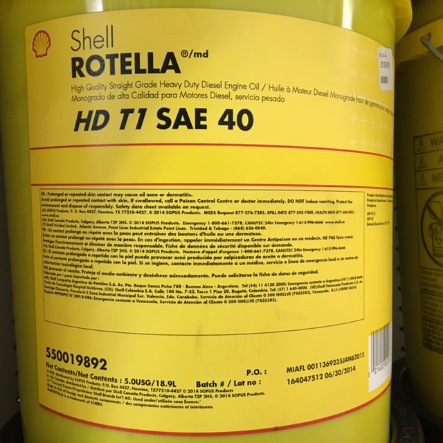

    My local boat store stocked "Rotella T sae 40" which below that stated it was "High Performance mixed fleet engine oil" It was not listed as "T1". This is the odd man out I've not seen it before and I cannot find it listed on any Shell website. The link with the MSDS for the "T" oil is not a Shell site but greatlakesoil so I think perhaps this oil is NLA? That's the info I'm looking for- we can all google and find what oil's are CF-2 rated but the Rotella T is the ghost here.

    In any case, what I was focusing on is that it appears Rotella T (not T1) and any straight weight (e.g., 40) in the same sentence maybe isn't really an existing product. Did you actually see the bucket/read the label at the boat store? Or was it from an on-line listing that could conceivably have been corrupted?

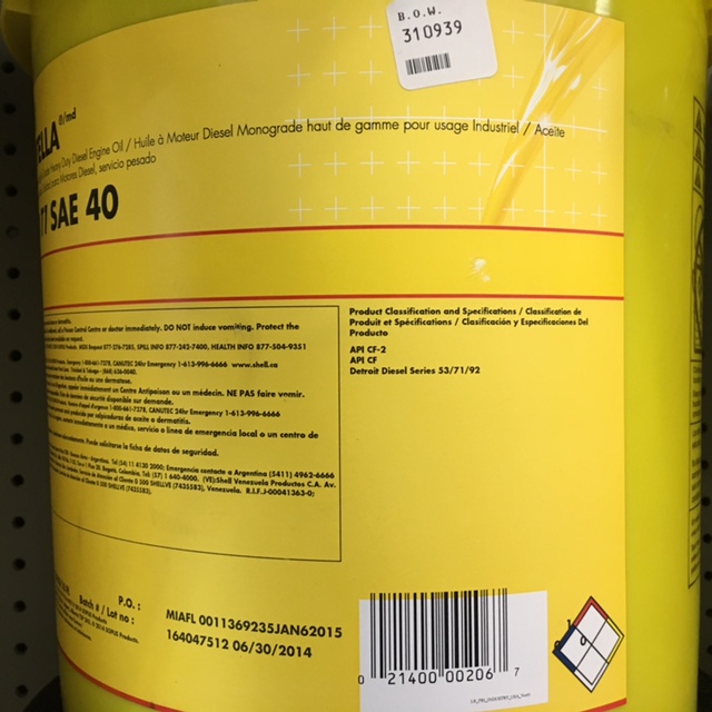

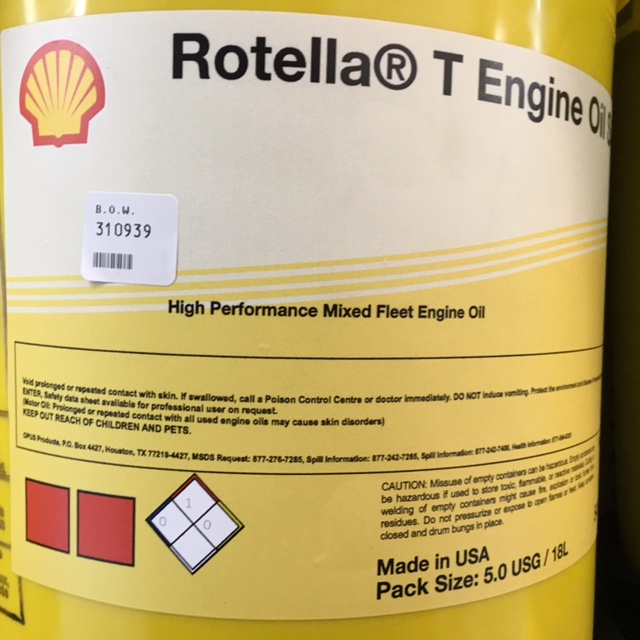

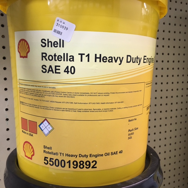

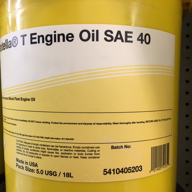

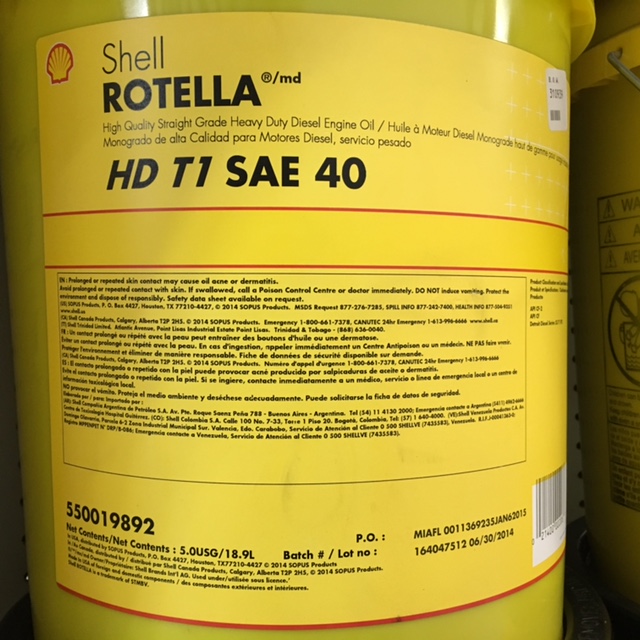

    pics taken this am- note that as well: " HD T1 SAE 40" not "T1 SAE 40" ; different than the website- I couldn't find T1 HD SAE 40. The store's label is the same number for both oils, but the bar code from Shell is a different number. Note HD T1 also lists MIAFL- perhaps it's packaged in Miami and the facility there has it's own labeling? Remember I also already posted the greatlakesoil MSDS of the Rotella T High Performance Mixed Fleet oil.

    Well, I'm guessing the HD stands for heavy duty. It appears to be CF-2 rated, so you could use either one.

    Incorrect Guess, H.D. = High Detergent

    Interesting one part of the label says T Engine Oil SAE 40 (T suggesting multi-grade) and the other part says T1 SAE 40 (straight weight, as expected).
    Phone call to Shell?

    Wrong, If you read the label on the 5 gallon bucket in the 3rd picture it says "High quality single grade Heavy Duty Diesel engine oil" right under the big Shell Rotella print and above the HD T1 SAE 40.
    The first pail simply states "High Performance mixed fleet engine oil"

    I believe "T" does not stand for multi weight/grade; "Triple protection" seems to indicates that as that phrase is only used on dino based multi weight formulas while "T" in some variation is used on the rest of the Rotella line. With your suggestion I called and the result is posted below.

    So I called Shell and got a technical specialist on the line and he told me the Rotella T SAE 40 oil was discontinued over 4 years ago and is not suitable for use as the shelf line is less than four years. He also said all Rotella T1 is "HD" and the marketing dept will sometimes insert that and sometimes not. I didn't ask him about triple protection nomenclature. At least I found out the difference! BTW I called the store and the manager is most likely going to pull the old stock after doing his own investigation.

    I didn't see a manufacture date on the Rotella T, nor a expiration date; but I did not buy that oil. Did you see one in the pics I posted and missed? The T1 has a date of 6/14 and it's within the shelf life according to the specialist I spoke with. The store sells plenty of oil and this is the first I've seen of this Rotella T. I'd think it was NOS from the distributor and an aberration as the retailer is quality and service oriented.

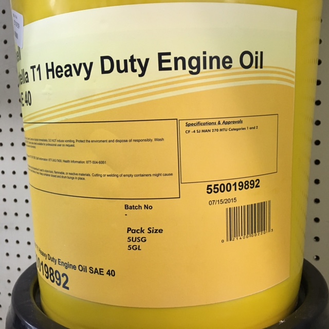

    The retailer immediately removed the old oil, here's the replacement. Different label again and it does not show the CF-2 rating but instead CF-4 MAN MTU and CAT ???
