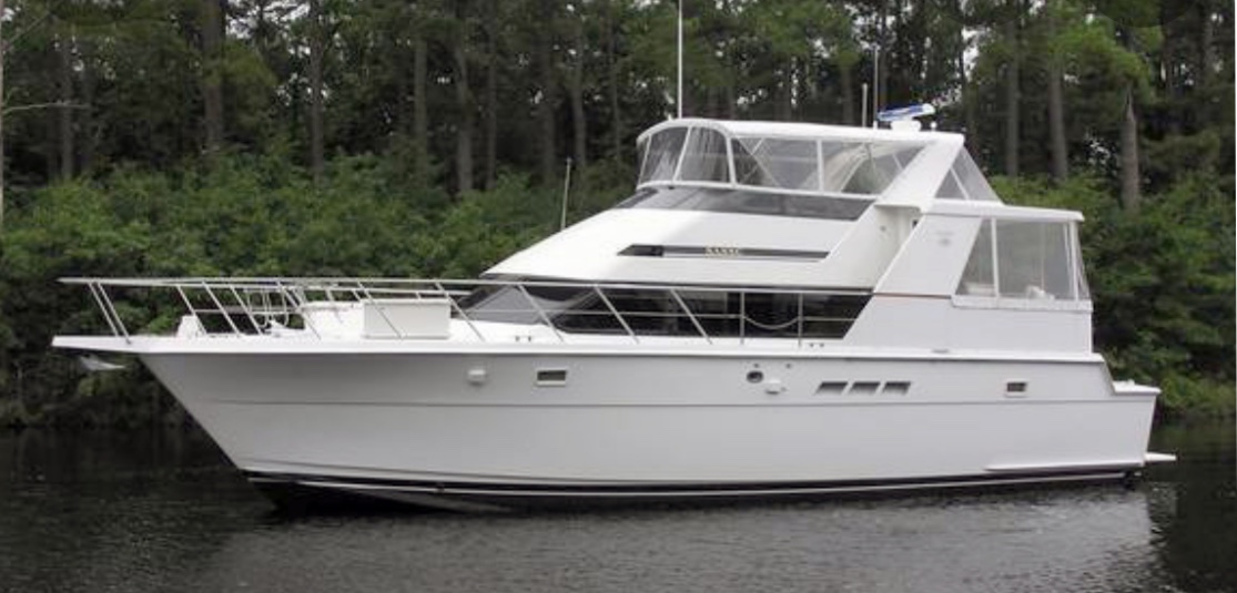

    52D77824-1A4D-4142-92C8-F2F3441EA9C9.jpeg Take a look at something like the 48’ Hatteras CPMY. They were built in the 1990’s and would be my choice over the Jefferson you mentioned or the Carver.
    A cruising couple can handle it with side deck access to fixed docks and cockpit access for floating docks. You can get around the boat but have to go through the aft deck enclosure same as the Jefferson (side decks on Carver Voyagers are about 6 inches wide). Hatteras is a better built boat with better sea keeping abilities than the others you have mentioned.

    Based on some suggestions, I have been looking at some Hatteras boats. Actually, I like the 48 CPMY and the 52 CPMY. There seem to be several in the 1990-1991 years. Any opinions on these boats??
