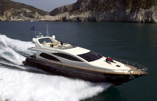

    Riva are great quality boats with great performance but one has to like the design of their current models, especially their bigger once.
    During our first "shopping tour", the 85 Opera was my oldest sons and my favorite boat. But Riva stopped the production of this model before we could order it.
    She was a real beauty, inside and outside. Italo design at its best. Besides the typical Italian (below standard) sized crew quarters, a very practical layout. To bad, its history.

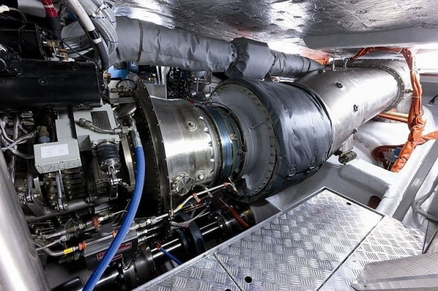

    Karo, I agree with you on all points. The variable pitch props are the most practicable, most efficient and best handling (non podded) system for "normal" speed ranges from 0 to almost 40 Kts. But we are still unable to find a production boat builder or even a semi custom yacht builder, willing to build a yacht with such setup. The Norwegian Servo Gear company has the best VPP system for yachts of this size in their portfolio.
    The turbine option would be an total overkill for a yacht below 120 ft in length. Overmarine has built a Mangusta 108 with twin Vericor TF 40 turbines and as far as I know, no additional diesel engines for slow speed an docking. I have watched this boat leaving the Port Hercules yacht harbour by using its turbines (and not a tow). The skipper most likely lost all friends among his jetty neighbours during his maneuvering :).
    Below a Mangusta starting up its center turbine while still moored.
    https://www.youtube.com/watch?feature=player_detailpage&v=ellhZWC4MG8
    The Pershing 115 can be ordered with a central booster jet, powered by a TF 50 turbine. But this turbine can not be started below 10 to 15 Kts, due to exhaust gas reclycling and water ingress into the exhaust pipe of the turbine.
    The wildest example of a turbine powered yacht for me, is the Wally 1118 Power. Fast beyond any safe limit but it has at least two additional small diesel engines for slow speed and docking.
    Very high power to weight ratios, very high performance and small in size but the procurement and maintenance costs of turbines for yachts are ridiculous.
    And you need an specially trained and qualified engineer to operate those turbines in a yacht. Otherwise they (and may be the whole boat) wont live very long and your insurance company may not like you anymore.
    Below a picture of the engine room of a Pershing 115 with central turbine. Not much room and probably quite hot and noisy in the engine room.
