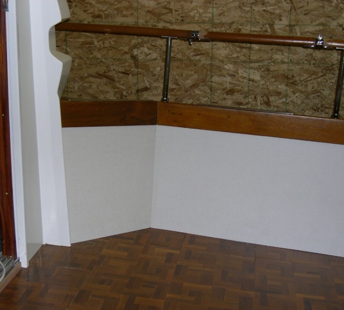

    aft deck restoration
    Well, I am starting to see daylight in this project! Had to buy Meranti plywood and sealed it and epoxied the edges after fitting the pcs. to the boat. Formica came in this week and my Carpenter got it glued on and we are now nearly ready to trim it out. Bought 3/4" Pemko stainless to cover the seams. While the formica looks all white it actually has a nice bit of gold and brown flecks in it which accents the teak flooring and the rest of the teak trim.

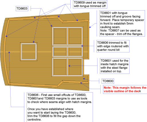

    Have spent the past few week doing just that and aligning up all the hatches, etc in preparation for the shipment of TEK-DEK which is on itz way!!
    Great timing - only the weather is already very nice here -- oh well, I'll just lay down some old oriental carpets when we go out in the meantime.
    Project came complete with a diagram - shown below.
