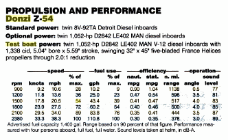

    I found a 1995 Boating test on a Donzi 54 and the numbers look pretty good:
    They even hit my Benchmark criteria for 30 knots at 90 gph or less!

    Those are pretty impressive numbers. I see it says full fuel and full water but no mention of total weight. I’ll bet the boat had no tower or hard top, no fly bridge enclosure, probably empty galley, no tackle, etc. It would also have to be light to swing those 32x45 5 blade props. However, it does give me some comfort that maybe the 32x39.5 props I’m going with might be OK. Will see in a few months I guess.

    I think you are in good shape, the Veem propellers are a not so secret weapon in getting to your speed targets. Makes me want to stick with my initial numbers.

    14,897
