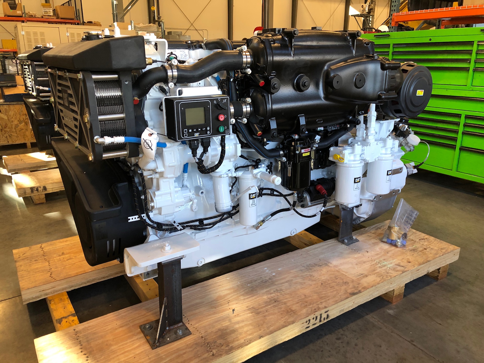

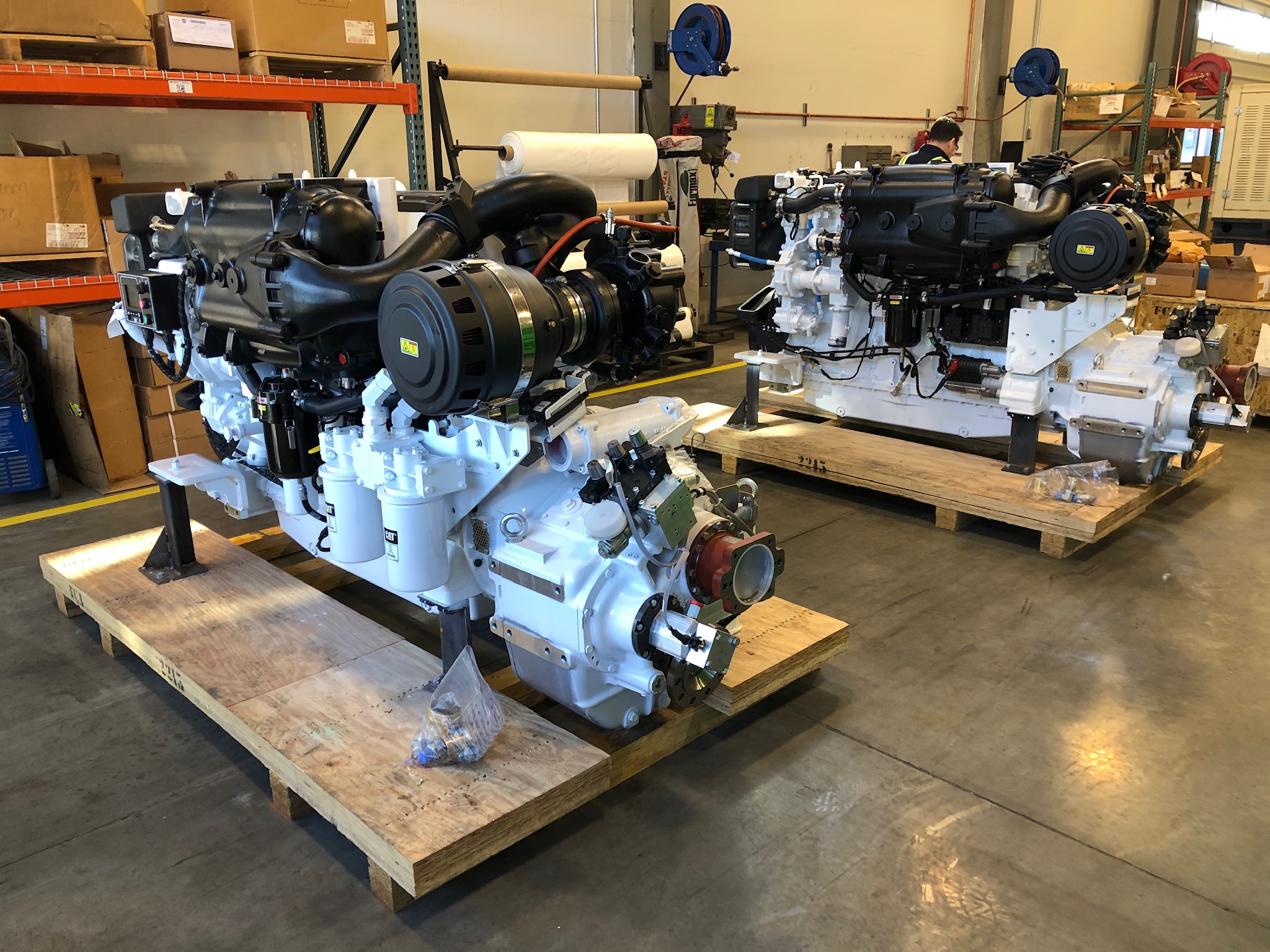

    Christmas in February! Engines arrived CAT dealer. Gears are mounted up and being plumbed. Everything gets loaded on the truck and sent to barge terminal tomorrow. Should arrive Ketchikan early next week and then the fun really begins.

    BTW, am I right in seeing hydraulic pumps connected to both ZF PTOs?
    If so, what are they for? Hydraulic thruster(s)? Or are you possibly fitting also fin stabilizers?
    Just curious!
  10. Capt J
    14,889
    If only one engine has a PTO and you lose it, you then only have the other engine and no thrusters. So they generally put PTO's to both and to allow more pumping pressure at idle when you're docking. It is quite possible one is for stabilizers too, but most yachts I run with hydraulic thrusters have 2 PTO's.

    I said nothing against having them on both engines.
    But I didn't expect to find any, on a 54' sportfish.
    At that size, hydraulic thrusters (as well as fin stabs) are pretty rare, this side of the Pond.

    I originally ordered including the mounting pads on the PTO’s to drive the original hydraulic steering pumps. The Hynautic system had a pump on each of the original Detroit’s. I wanted to keep the two pump set up so I would have power steering when trolling with only one engine running regardless of which engine. Since placing the original order I made a change and have now installed the DC electric powered SeaStar hydraulic system. This will give me power steering regardless of which engine is running and reduces the number of hoses and equipment around the engines.

    Interesting.
    I didn't even think of steering, which I assumed driven by DC electrical motor, as you eventually opted for.
    Are you now going to remove those PTOs before installing the engines, or leave them just in case?

    The PTO mountings pads (red mounts in picture) will be removed and blanking plates put in place. No sense having unnecessary appendages just sitting there. We will save the mounts in case future needs ever require something to be PTO driven.
