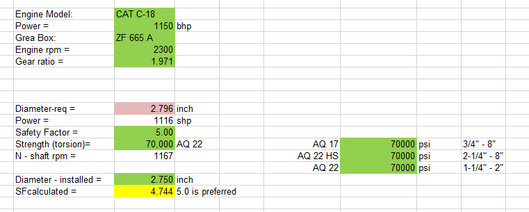

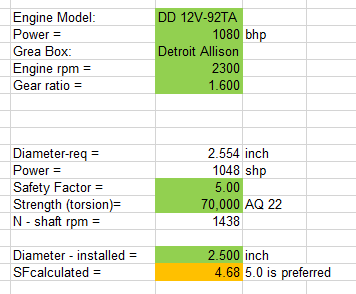

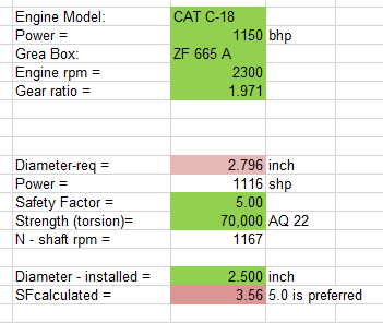

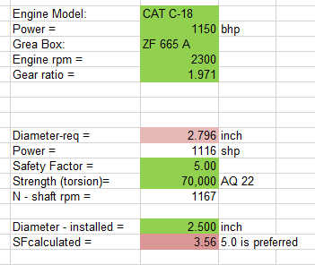

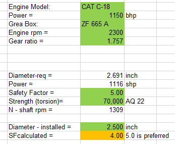

    PB - Is my math correct that using the 2.75" shafts with 1.97:1 will give me an actual safety factor of 4.9177 ? I just did a simple % take off from what you provided showing a 2.796" shaft needed to get to a 5.0 safety factor.

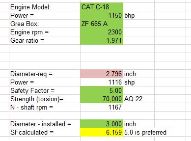

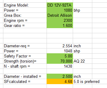

    It does not accurately scale on a percentage basis.
    I recalculated with a 2.750" diameter shaft and you get a SF of 4.744, which is better than the 4.68 you had on your 2.500" shafts with the Detroit's. Your shaft diameter is only 0.046" away from the design target, this is where the engineer has to put on his thinking cap and make a practical assessment and live with the 4.744 SF.
    A 3.000" shaft is overkill at a SF of 6.159, I would have to say go with the 2.750" in your case.

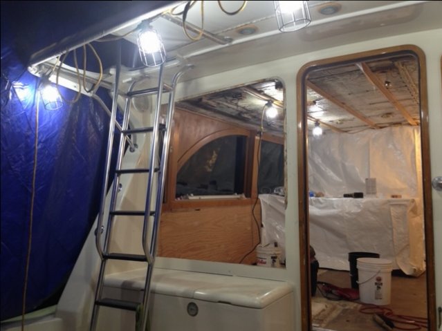

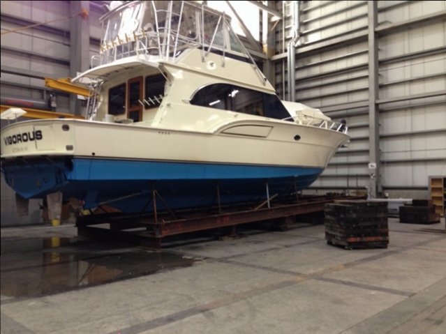

    I visited ZF and got to operate the display of the Smart Command unit and got a full run down on it by their tech. I was very impressed and glad we selected this system. I will be installing the control head to the left of the helm as this just makes the most sense for our overall configuration.

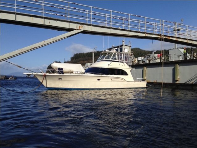

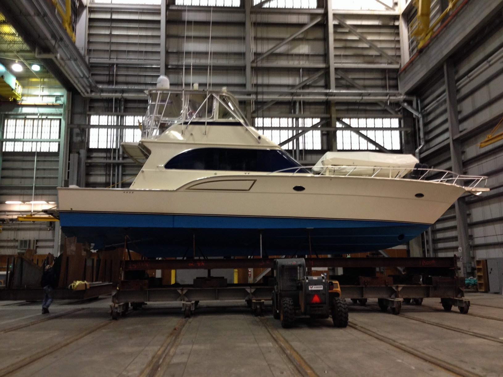

    The boat was docked yesterday, bottom washed and then got moved into the building this morning. The cradle was lifted off the transport carts and set in final location where the work will be done. She is all leveled up and ready for the real fun to begin.

    Nice to work on her inside, tape the waterline in a few places so we can see the difference when she refloats.

    Nice looking Donzi convertible, this should be a fun repower to follow going from older v-12 to modern inline 6 cyl power. Good idea to mark waterline.

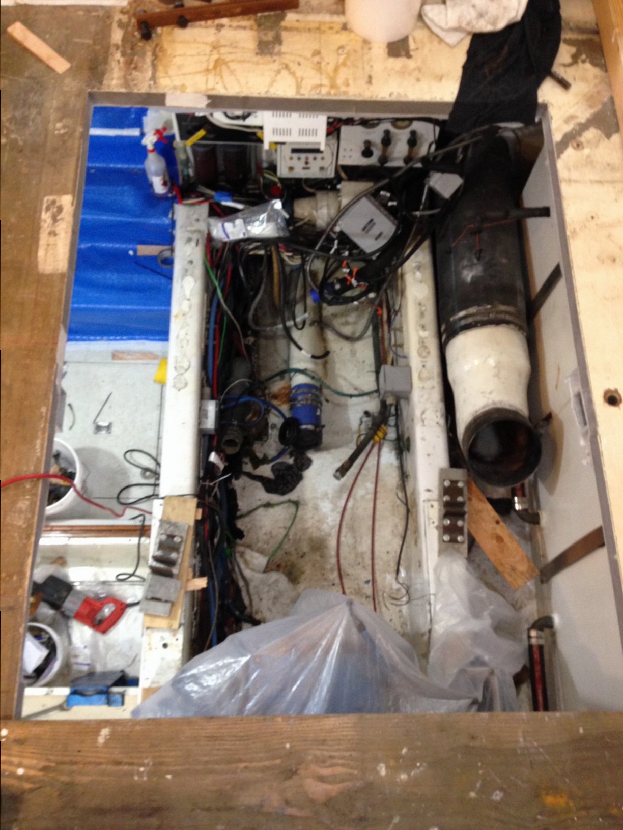

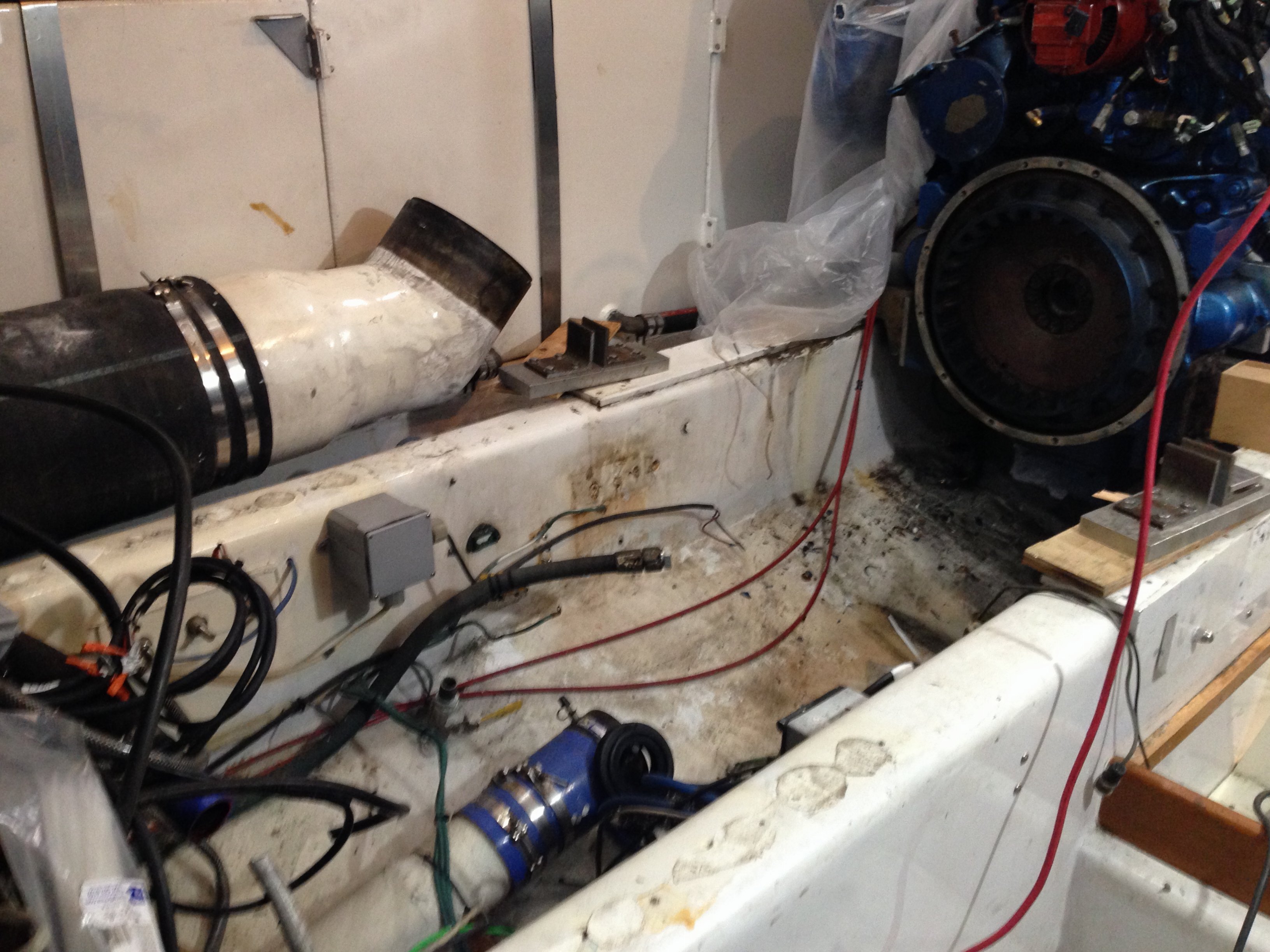

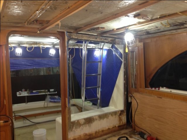

    Making some progress. Aft bulkhead access cut is made. Port side salon floor access cut made. Port gear and 8kw generator removed. Next is to slide port engine aft and lift up and out. Then the stbd side gets tackled. Still lots of hoses, cables and junk to remove then degreasing, cleaning and painting. In the photo looking down thru the access cut you can see the water maker panels, filters and pumps on the bulkhead. That's all coming out too.

    Some serious prep to get access for engines. Nice work station on the transom.

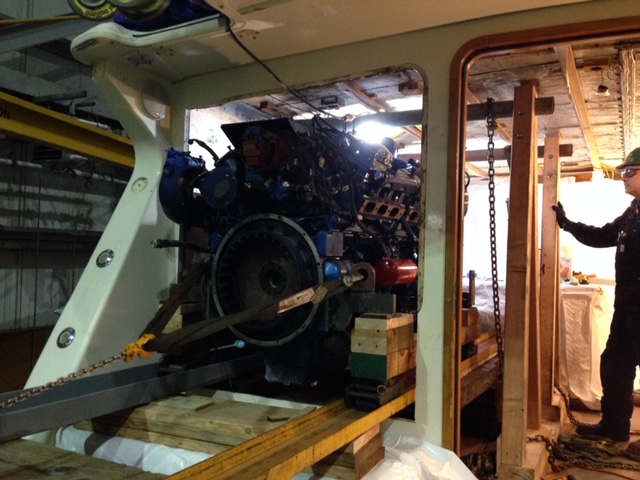

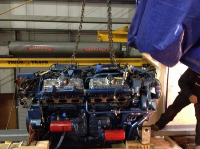

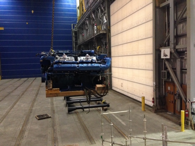

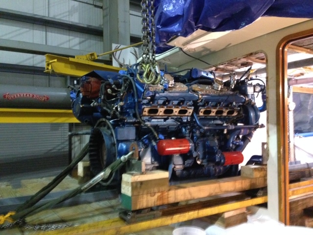

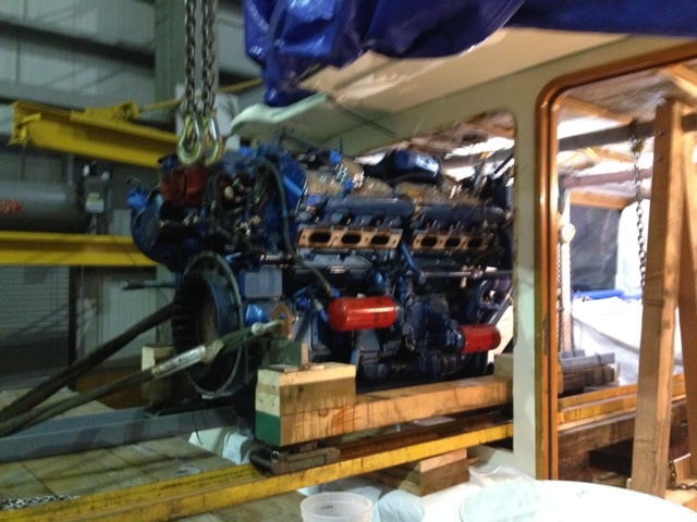

    First engine is now out and on the shop floor. We elected to lift it with chain falls to the salon then rolled it out on Hilmann rollers riding in steel channels. This allowed the aft bulkhead opening to be smaller as we didn't need room for an overhead trolley or stinger. This also kept the rolling mass center of gravity at a much lower point. Finally, this also allowed a much more controlled movement which we felt was also safer. The channels are supported by 4(ea) 12x12 beams spanning across the cockpit and blocked to the shop floor. This means no load whatsoever on the cockpit deck which we preferred.

    Consider a preservation now before you bag them up and wait for their next owner :)

    Stbd engine came out today. Still have 20kw gen, old water maker, oil change pump and misc cables and junk to remove. Then ER will get deep cleaning and paint. Then we go into new install mode. I’m anxious to see things start going back in.
