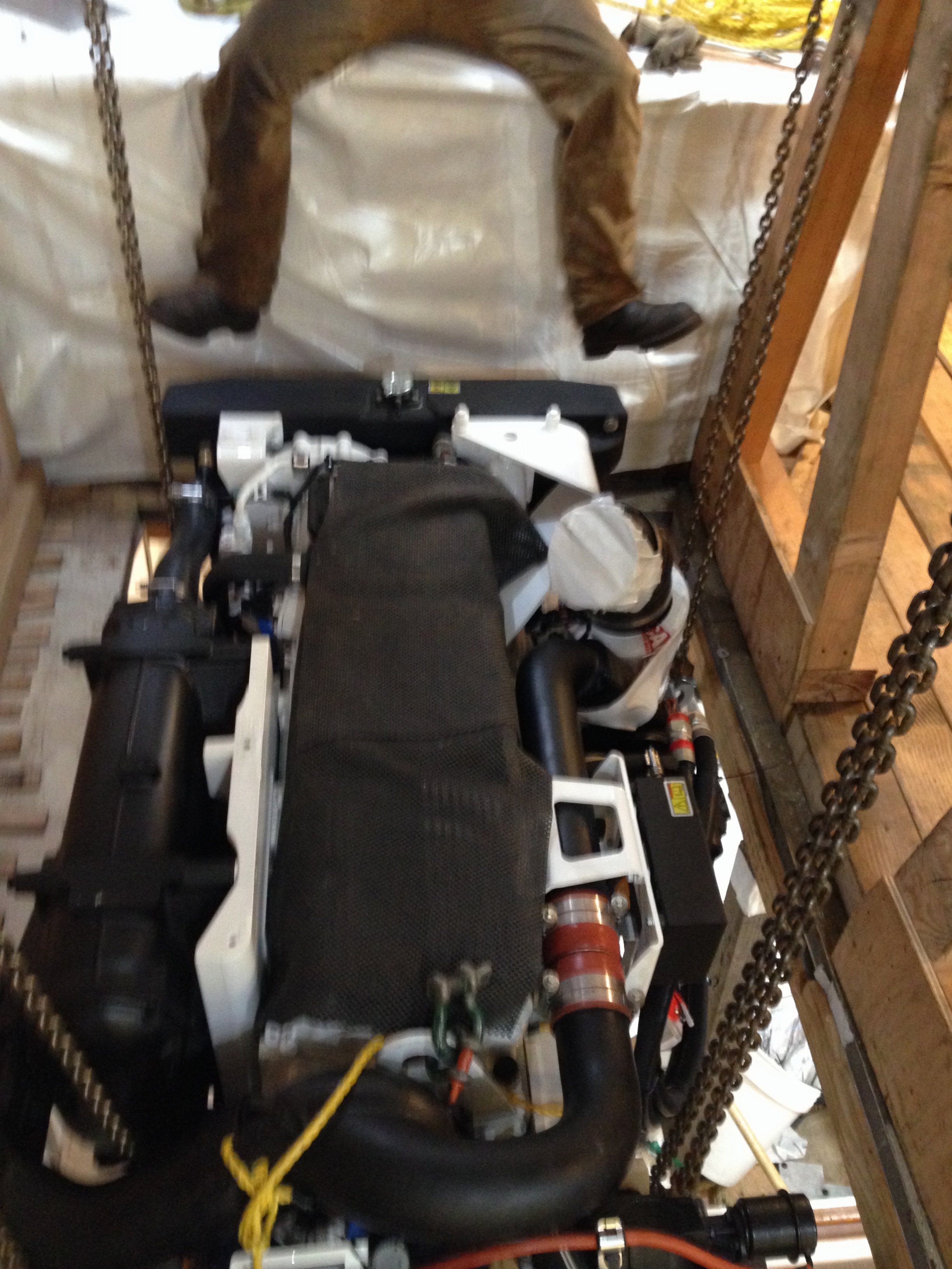

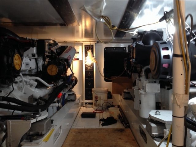

    Back to the Repower now........Port engine rigged in and coupled back to the the gear. We are doing final positioning on both engines and drilling tapping the mounting plates the resilient mounts sit on for final bolt down. I’ll post more pics once the engine room is cleared of all the shoring and rigging.

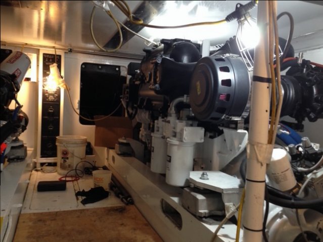

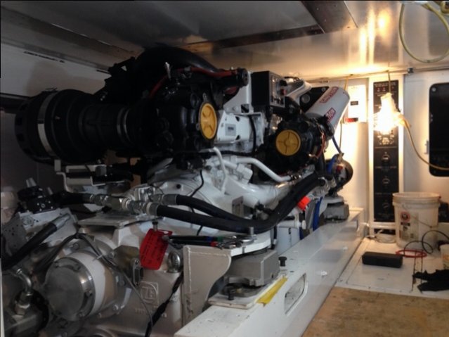

    Port Engine and gear:

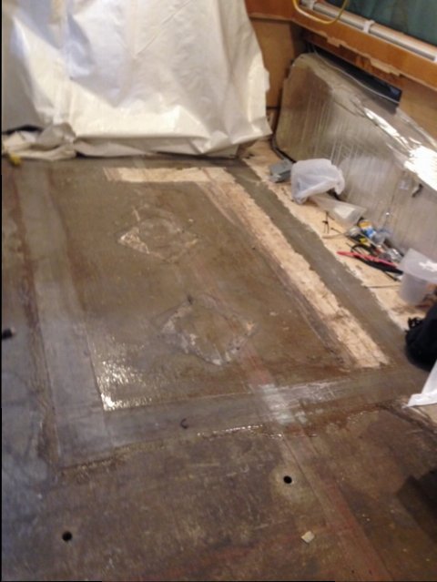

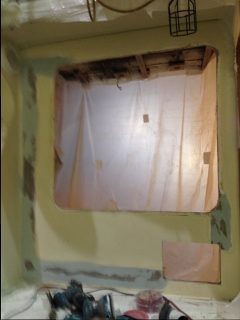

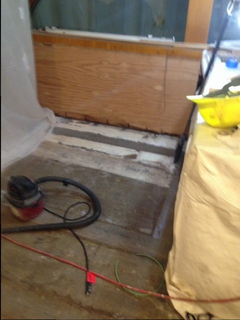

    We are moving forward presently. Engines are in and preliminary aligned. Hoses and connections being made. Salon floor access cuts were epoxied in and glassed over. Aft bulkhead access cut is being fitted back currently. Still lots to do to put humpty back together again.

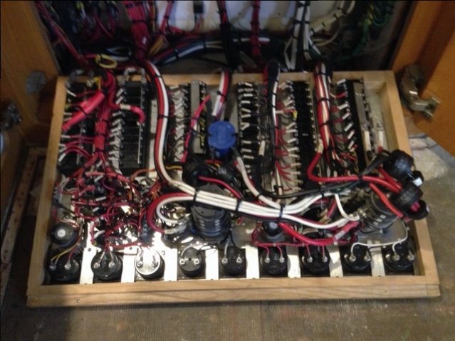

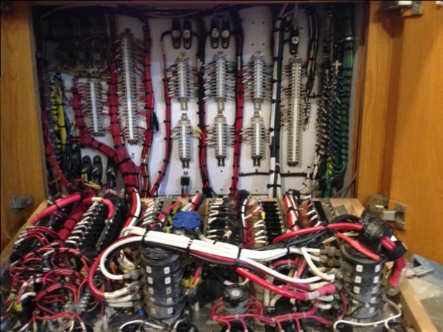

    All wiring and clean-up pretty much done in the main panel and behind. All the new systems (Gens, h2O Maker, block heaters, etc) all have new wiring all the way to their respective breakers. Additionally we cleaned everything, torqued all lugs and screws and checked every terminal connector. Yes, we found some loose ones, even a few that were never crimped and just had wires pushed in. Everything is now neatly banded up and well secured. All wires have printed floaters/tags and we have updated the original wire diagrams. The blue rotary switch in the middle of the panel is the selector switch between the 9k and 20k gens. We increased the wire size to both gens from original as well as the calcs showed original was borderline.

    The access cuts in the salon are all epoxied and glassed back in. The aft bulkhead access cut has been refitted and glassed in. Doing final fairing and prep for paint.

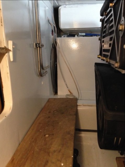

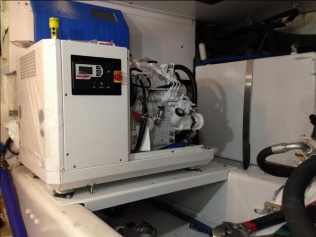

    The new 9k gen is on the new foundation and being final connected. This sits aft of the Port Engine above the shaft log and seal.

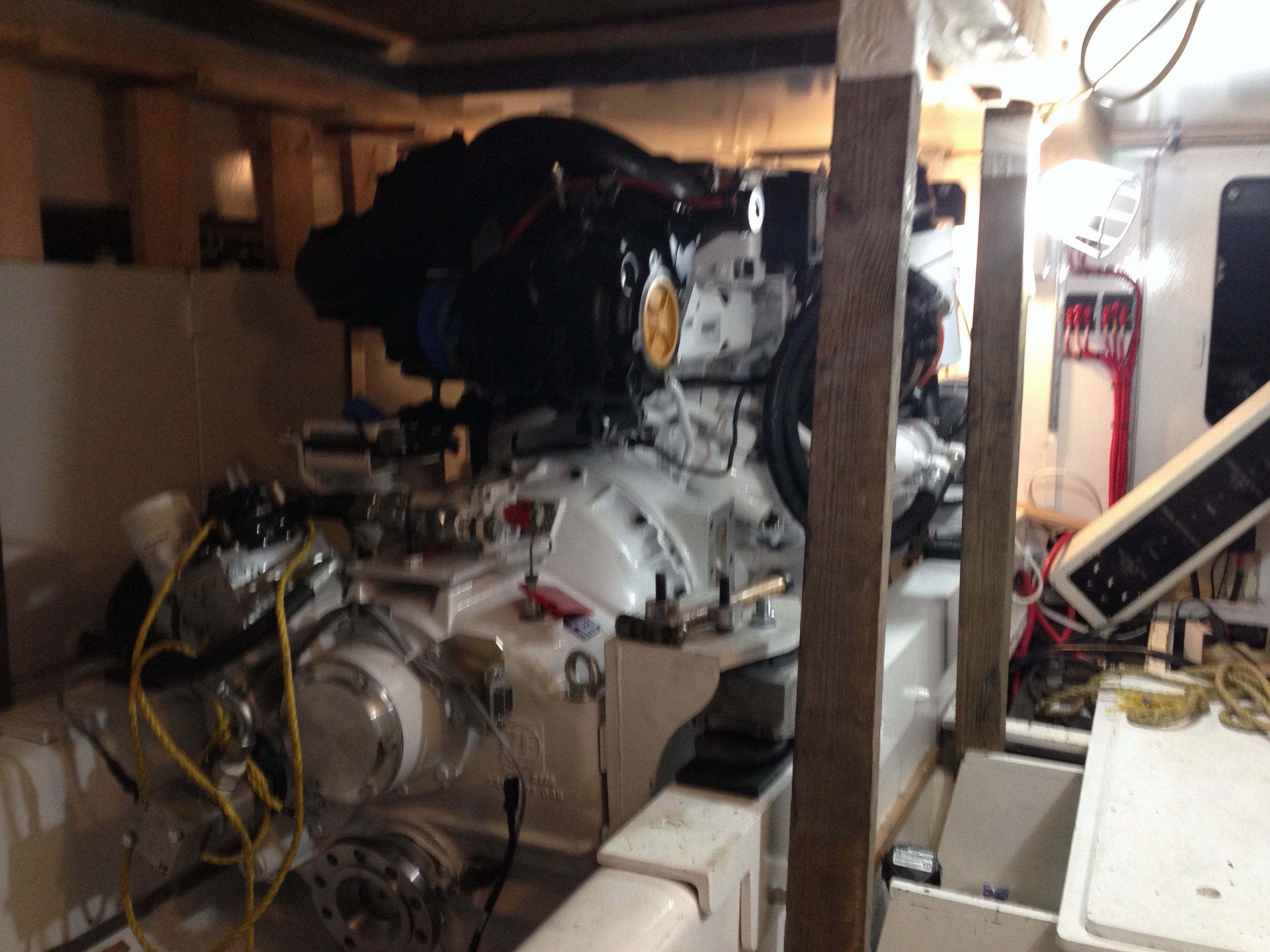

    Engines all set, mounts tapped and bolted and in their homes. Note on Stbd engine we relocated the oil filters up and aft a bit as they were too tight inside the engine rail. Port side fit fine with factory mounts. Everything fits inside the engine rails and more room outboard too. We gained almost 7" of clearance on the front side which makes it nice since you have to go around from the front to access outboard.
