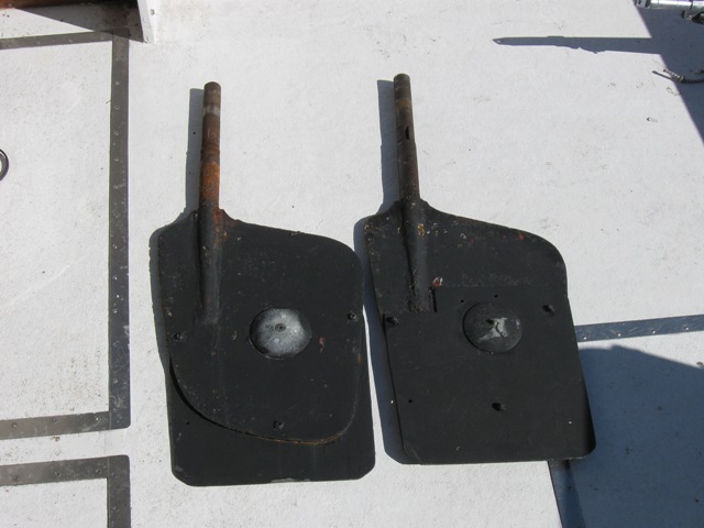

    Trash Romaer steel rudders...
    Just trash those old rudders... when you pull them out you are going to see the rudder pole/shafts have deteriorated in circumfrance anyway. Make new ones out of stainless and pop a zinc in each one. Sed up the old ones and tell Kenny to make you new ones. The guy is top of the line and won't rip you off.
    Your tubes may be ok, but acid bath them and make sure to coat with bottom epoxy a few times up the shafts.
    Most old Romaer rudders bang around... just grab them and you will see probably.. rudders shoud not bang around.. but it they are seized they won't.
    Ours seized too.. it's an inherent design flaw.
    Not into Sea Rays... Roamers are way tougher and will crush a Sea Ray if it ever hit one into glass dust. Also, a Roamer with the same power will beat it in speed considerably. The only thing a Sea Ray will do is roll more (Roamers don't roll withthat nice hard chine... but a Sea Ray likely hits a head on short chop Sea more smoothly.. can't have it all.

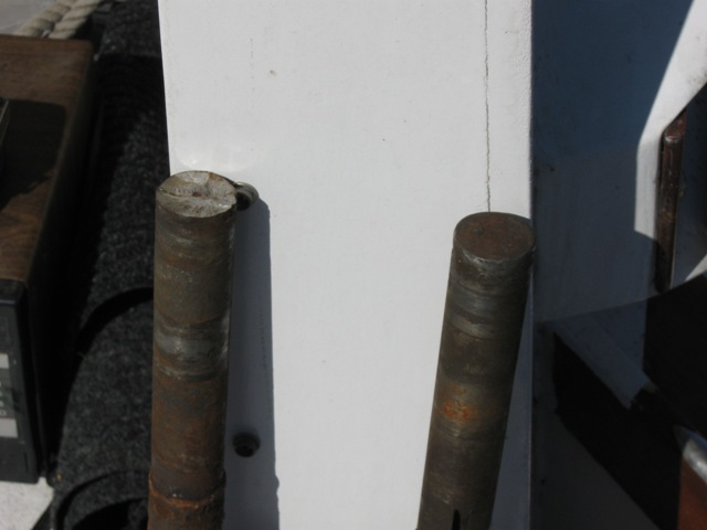

    My Rudders don't bang around or leak. They are just seized and really it's only the port one. The starboard one is fine. I agree with you though, anything that is over 40 years old should be replaced. Stainless Steel sounds like the material of choice.

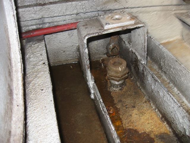

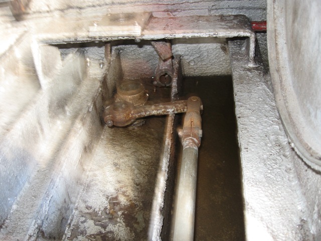

    Rudder Help - me too
    After all the transporting work, the Roamer is home sitting under a california sky waitng for the americas cup races to start this summer.
    First roamer repair needed is rudders. The outfit that removed my rudders independently for shipment decieded to cut one due some mushrooming on top of rudder post ( note sure why they couldnt grind it vs going through the effort to. This also might be a clue some thing else is up.
    What r the suggestions from here should,
    1) buy all new rudders/shafts or just shafts
    2) how should prep the through hull
    3) what r the liner options mentoned in the above thread
    thnaks for the help

    Here is what you do..
    Take one old rudder and ship it to Kenny at East Coast welding to make you two new ones... won't cost much... make them in stainless. Make sure you clean-out old tubes with acid bath. Neutralize with baking soda after done. Immediately when dry hit with Interlux bottom epoxy inside tubes. Be careful when taking of bronze nuts not to strip aluminum tube threads so make sure to douche with WD-40 overnight or so if they are still on. I would re-make the nuts in stainless if you can.
    Don't listen to people who don't know what they are talking about on this site (and there are a few) and don't make them again in steel. The shaft rusts and gets skinnier over time and they start banging around, particularly in salt environment. Clean grease fittings well and repack with boat trailer grease and off you go. Make sure to zinc the rudder unlike Chris did back then.

    I replaced one of my steel rudders last year on my 1960 steel hull Roamer. There are no grease fittings on those tubs. I replaced it with a steel rudder made in a local machine shop. The thing lasted 50 years before it needed to be replaced. I really don't care if someone 50 years from now has to replace it again. It won't be my problem then.
