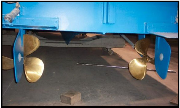

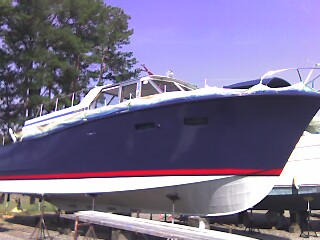

    Not displacement hull
    The Roamer Offshore hull is not a displacement hull. It is very flat aft but with a sharp entry. It should be fine for outboards (other than size and weight).
  3. Laurence
    Laurence Senior Member
    Aug 30, 2006
    248
    Chattanooga TN
    Flat Aft
    Bow turns into keel

    hull type
    Laurence - that is exactly my hull. i wondered how it could get to 30mph if it was simply a displacement hull. so can you guys help me to decide on outboards ? unless someone has a better idea.... the biggest gasoline ones i can find are Yamaha. or should i go to Diesel ? (the mechanic says the fuel tanks can hold gasoline or diesel without problem)
