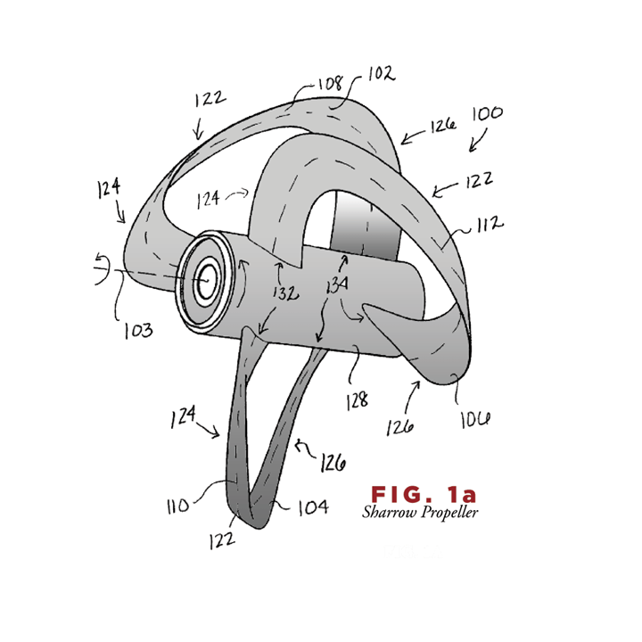

    My eyes go in weird directions while trying to follow the water flow against the thingy surfaces.
    I think I have some of it figured out.
    Is there an official Theory of Operation from the designer or companies yet?

    Notice the angle the thingies are attached to the hub in post #1.
    Now check out this mount in the picture from post #61.
    Borrowing Carl's diagram from post #4, I'm pointing to areas 132 & 134.
    Compression of the water straight out (sideways) or mounted this way for strength and sacrificing some aft thrust?
