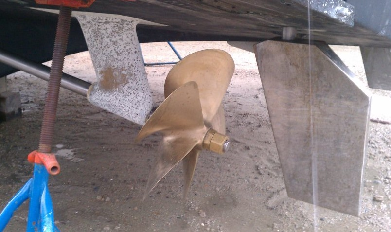

    That's interesting, I have not ever measured but by this photo of mine looks more then 3.5" and that's with a 33/43 wheel. Also note the updated rudders that we installed.

    Very hard to tell from this photo. From the angle it looks like the blade may not be at its closest point to the hull? But what the heck, it is obviously been working well for you regardless.

    10% tip clearance is an acceptable minimum for a conventional setup, I have seen less only on boats with propeller tunnels. There is some sound deadening material that you can put inside the hull over the prop area if you have access in case you want to address any potential noise or feedback issues.
    I suspect the struts are different on both of your boats (Donzi 54 and Dockmaster). They could have a different vertical drop. Now that the boat is level, what shaft angle can you measure? What is the the length of your strut barrel, you typically want at least 4 times the shaft diameter? And what is the OD of the aft end of the strut barrel, you want the OD of the forward end of the propeller barrel to be equal to or less than the strut barrel OD?
