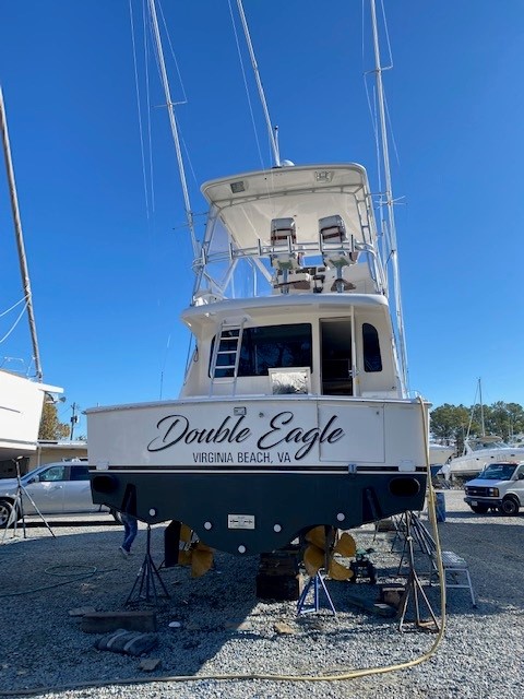

    I ended up having my Federal wheels adjusted. Wildcat Props reduced the pitch slightly which reduced the load on the C12 CATS and virtually eliminated sooting issue I was seeing on the transom. I lost about a knot at the top end, however the boat is performing very nicely at cruise (24-25 knots).

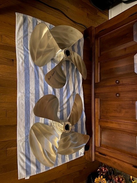

    that’s what my 40 Convert. w/800 Man’s weighed as well.. 32-34k depending on fuel on board. i believe my boat ran 29x38’s w/veems. i have the spare set of mi wheels down in the cellar.. if anyone is interested fwiw

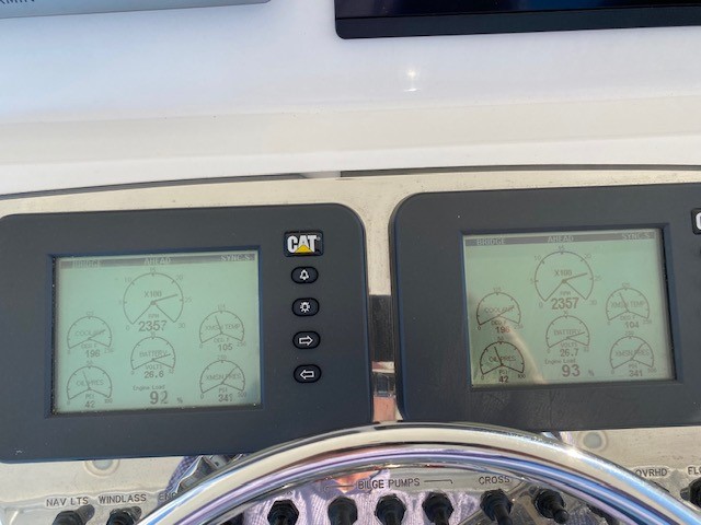

    Here is a photo of my CAT gauges during sea trials at WOT.
    2357 RPM/34 Knots
  20. Capt Ralph
    12,747
    I'm assuming the "92" & "93" bottom center is engine load.
    Further assuming you were on the pins and governor holding WOT @ 2357.
    Do you see taller loads full of fuel? Full of fish, ice and crew? When mother in-law is onboard? Climbing the back of a swell?
