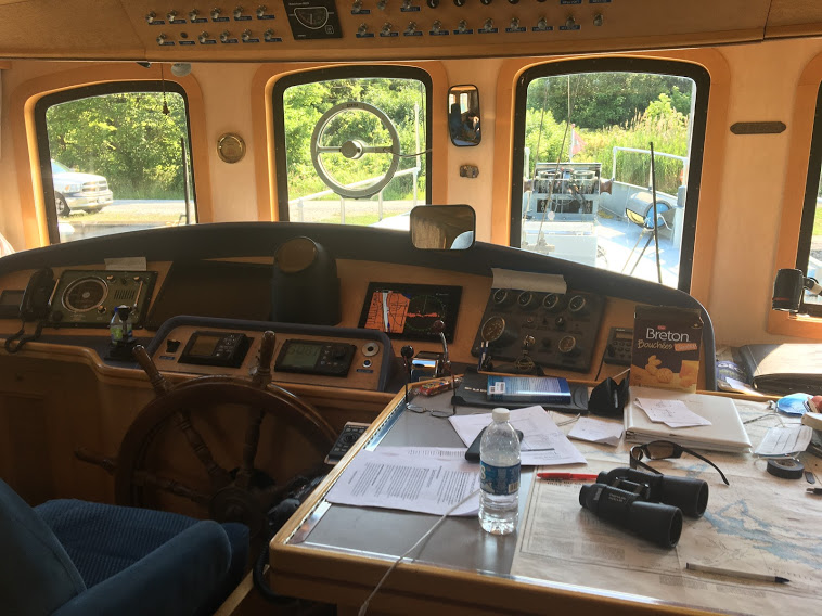

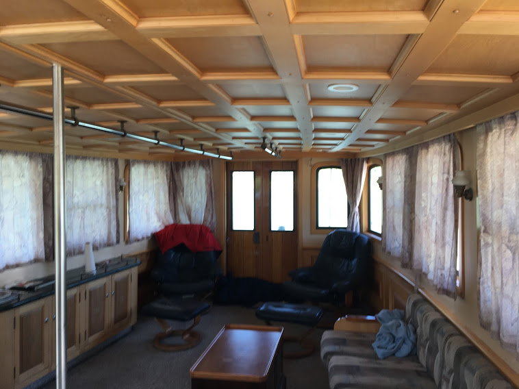

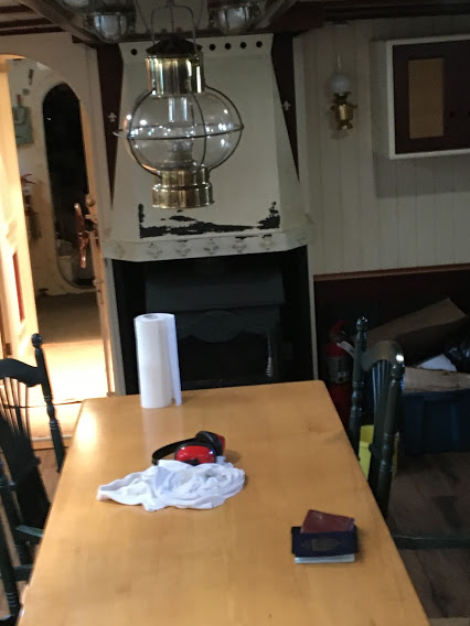

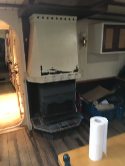

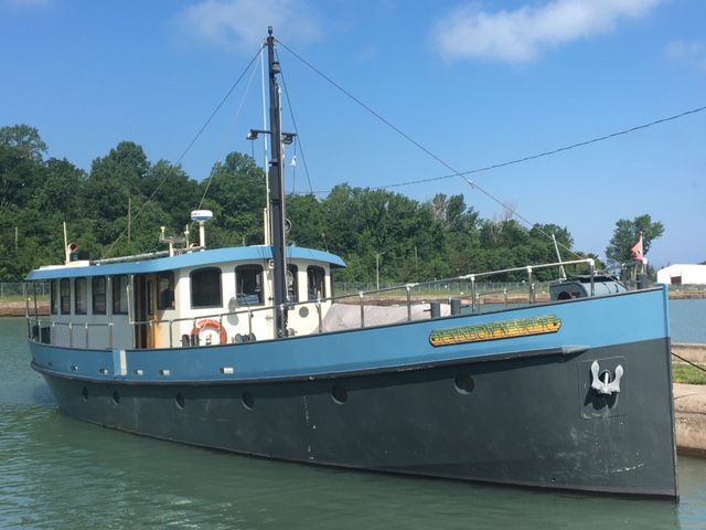

    Well here she is, I hope the owner dose not mind me posting pictures of Rainbow Maker but she sure is a nice boat.
    They arrived Welland Canal this morning and needed crew as I was busy today tried to find help for him but none of my guys were available owner found a local friend who worked the lake freighters to help them through canal. It has nice wood stove to. Had a nice chat with the crew. I saw this boat years ago going through the Welland Canal I am sure it was a local boat at one time.

    Designed by Dutch Naval Architect John Jansen in 1998 to a classic Dutch style for a coastal boat and built in 1999/2000 by Quebec yard Chantier Naval Forillon for a Gerald Verlaan specifically to do the Great Loop. The yard is known mainly for stout fishing boats, is still in operation and currently has 6 SAR craft in build for the Canadian Coast Guard. Very pretty little boat in the old style.

    Wow, nice but not my kind of boat, fireplace and all. o_O

    Wow.
    In hindsight, this previous comment of mine was the understatement of the year! :)
    Congratulations, a stunning small ship indeed.
    She looks fantastic in spite of the black hull, that IMHO doesn't do her justice.
