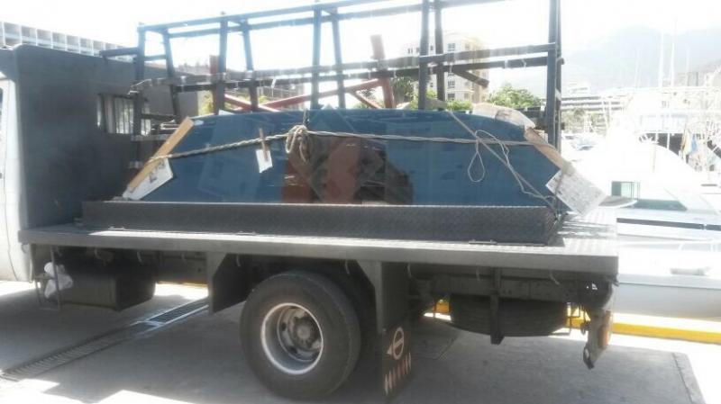

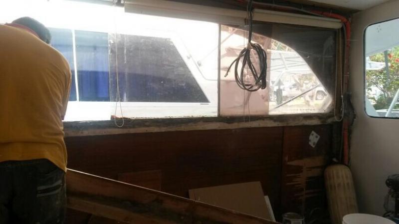

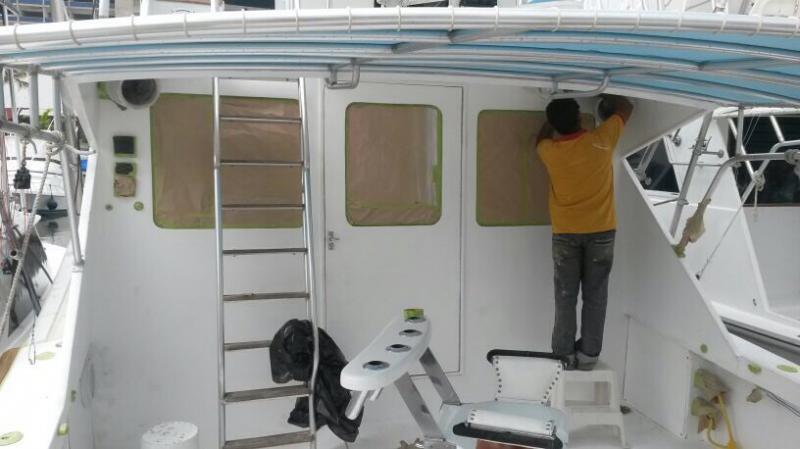

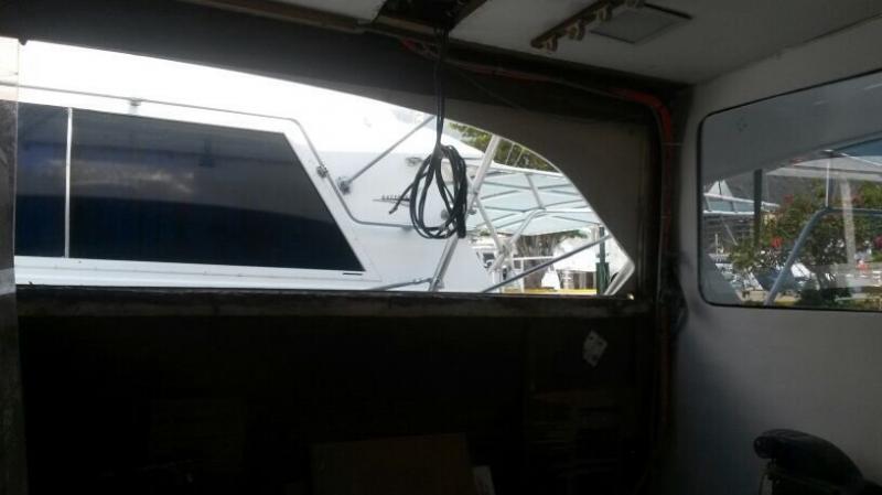

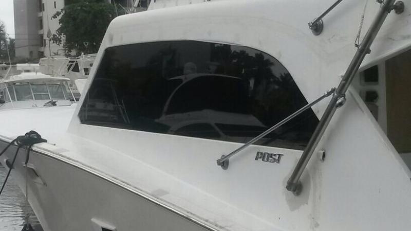

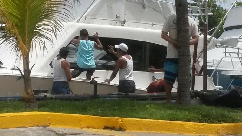

    It' not a dificultad process or project, but it is a frágile one.
    First you have to take the riels of the three piece Windows, then on Fiber glass make an interior frame, we make it about 1-2 inch, after That make a model of the Windows to fabricate the laminated glass.
    Once you have the frame and the window we used "uretano" in spanish (dont know the word in english) to fix the glass.
    The most important step is the model of the Window, we had to cut a little bit of the Finder glasés on a corner to fit .

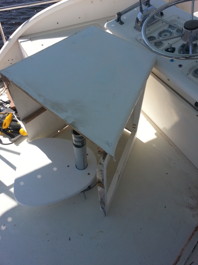

    This Was the other big proyect, we rebuild the floor, door, door Windows, and a Huge fish box.

  8. P46-Curaçao
    P46-Curaçao Senior Member
    Mar 8, 2013
    734
    Juan, you did an incredible job, love the looks of the side windows, just curious, do you have pictures of the interior frame?
    (el barco tiene un aspecto fantástico!)
  9. Gambetica
    Gambetica Member
    Aug 3, 2013
    45
    Venezuela
    Nice spanish, and it looks Really nice índeed, last pic!
    Ps let me Look one of the frame...

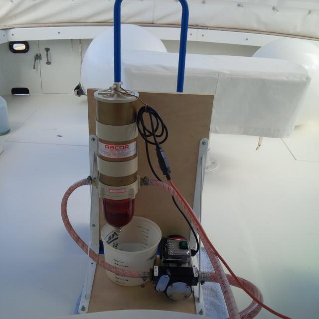

  14. P46-Curaçao
    Mar 8, 2013
    734
    Custom made 'fuel polisher'

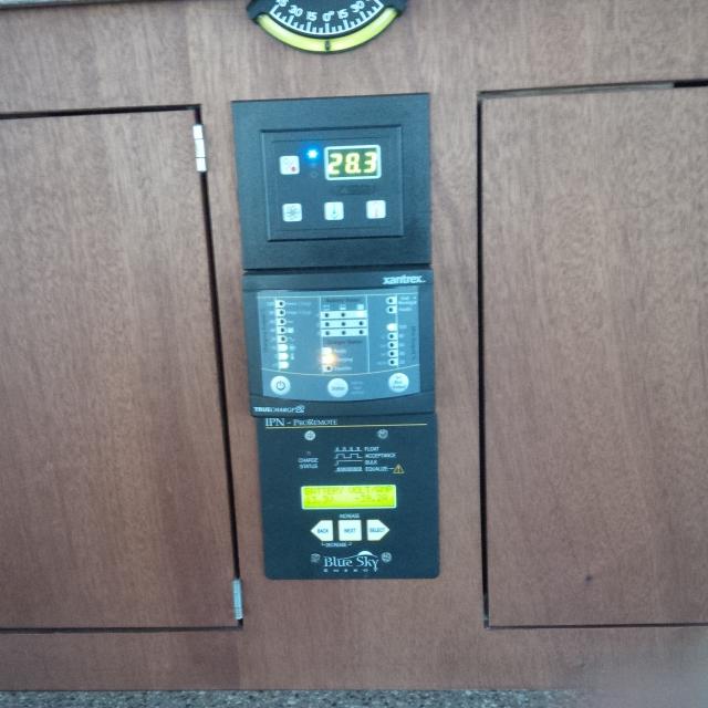

    Airco panel
    Battery charger panel
    Solar charge panel

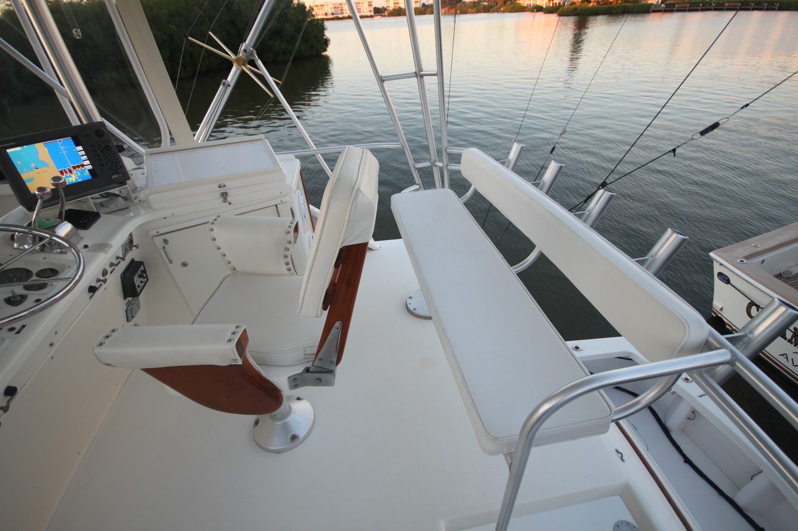

  16. RT46
    RT46 Senior Member
    Feb 22, 2011
    1,063
    This is a cool idea for the area behind the helm seat.
    (not my boat)

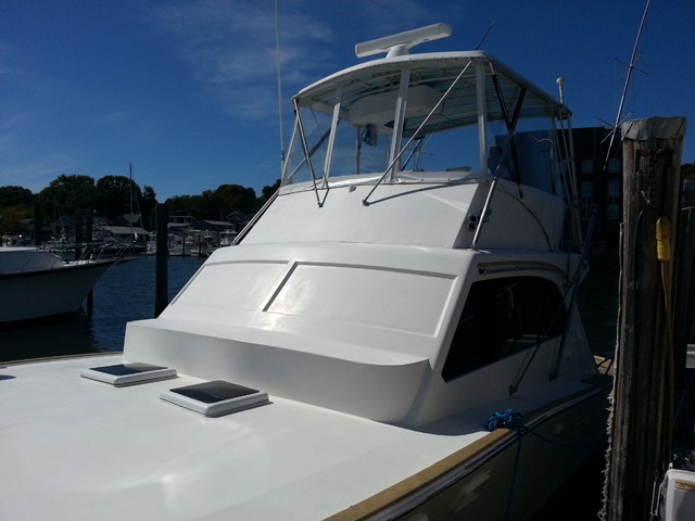

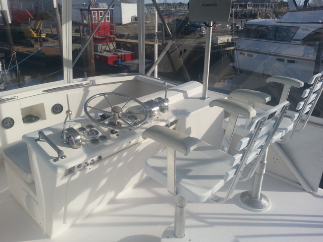

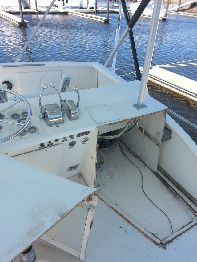

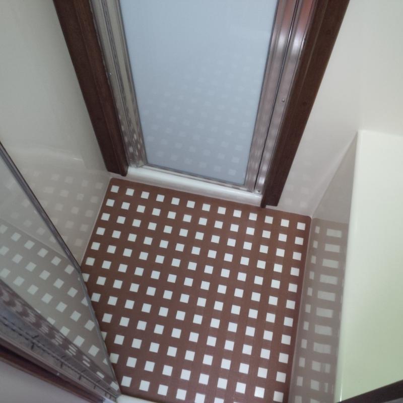

    I have been inspired by some of the great projects that are posted in this forum. Here are a few of the simple ones I completed on my 82 42' over the past few years. I removed the side cabinet from the helm and moved the passenger seat forward. When I had a new enclosure made I removed the tinted visor and all wood from the flybridge.
  18. Matt46post
    Matt46post Senior Member
    Apr 27, 2015
    226
    El dorado hills california

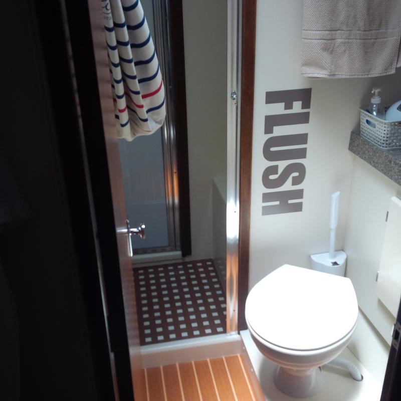

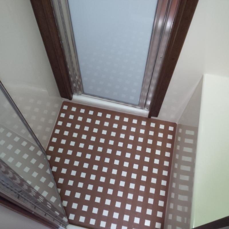

    How did you get the shower mat in ...in one piece ,the door door jams make it tough, it must be really thin, I was planning on doing mine in two pieces

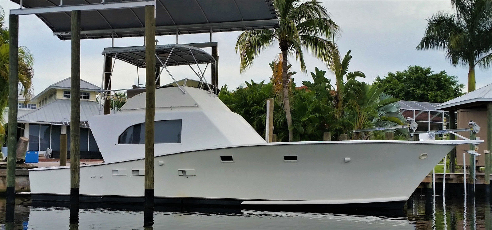

    Not mine....thank God!
