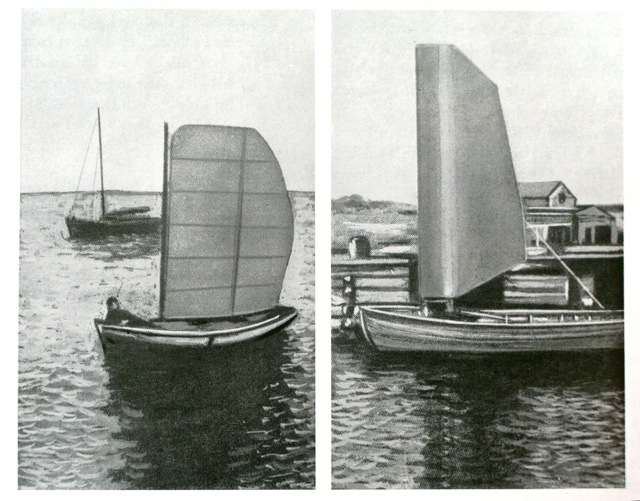

    Interesting AMG, is that first photo really a rigid wooden sail?
  10. AMG
    5,392
    I am not sure, as this is from an old article. They had both combined wood/fabric and wood with thin veneer. Seen from above, the sail has a symmetric wing profile. They were better upwind than downwind compared to normal sails.
    At the time they were common and they were convinced that wooden sails should replace the white on all boats...
  11. brian eiland
    brian eiland Senior Member
    Jul 28, 2004
    3,020
    St Augustine, Fl and Thailand
    Amaryllis Experiment
    Looks to be some sort of thin membrane material that needed battens to help it with aero shape...both horizontal ones and one vertical one
    But it goes to show you there was lots of experimentation going on even in those early days of sailing. Sometimes it hard to convince sailors to accept new ideas :rolleyes:
    ..ie:
    " I can with a good whole-sail breeze, boat to windward faster, by a mile an hour at least, than any other sailing vessel afloat." -Nathanael Herreshoff , the infamous yacht designer speaking of his revolutionary 25' catamaran design, Amaryllis.
    .....the year, 1876

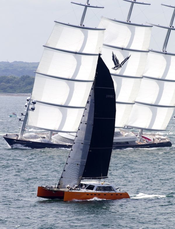

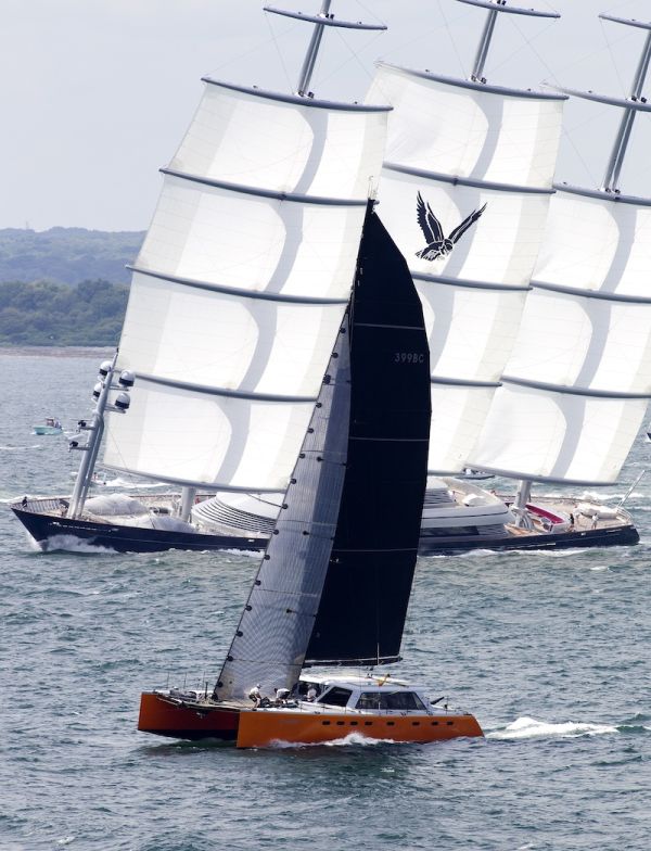

    David vs Goliath
    I'm a wee bit late reporting this news, as somehow I was totally unaware of it :?:. I must have been somewhere in outer space.
    Maltese Falcon vs Gunboat cat
    ...excerpted from the start of the TransAtlantic 2011 Race..
    Newport, R.I. USA (June 29, 2011) – This morning, the tension was mounting dockside as 14 yachts made final preparations before they took the second start of the Transatlantic Race 2011 in a spectacular scene full of drama.
    While the first start of the day produced some high drama, the start for the two yachts in the Open Class was just as extraordinary. As the magnificent 298’ Maltese Falcon unfurled acres of canvas and entered the starting area, the Gunboat 66, Phaedo, owned by Lloyd Thornburg (St. Barthelemy) was dwarfed in comparison. Phaedo is one of the world’s most head-turning maritime creations and the carbon fibre, Lamborghini-orange catamaran has become one of the most well-known yachts on the regatta circuit. However, the spectacle of the Art Deco giant, Maltese Falcon, dominated the proceedings, announcing its intentions with a bone-rattling blast of colossal air-horns to warn spectator yachts that they were about to tack for the line. It was a full five minutes before the three rotating rigs, each weighing 30 tons, completed their revolutions and Maltese Falcon heeled over bound for the start of the Transatlantic Race 2011. Phaedo, however, was far more exuberant and timed the approach to perfection, coming up under Maltese Falcon. At first they were caught in the enormous wind shadow of their leviathan nemesis, but as Phaedo came out of the wind hole, gasping for air, the crew onboard hauled in the sheets. Pulling the trigger, Phaedo accelerated away from the opposition, but not for long. Weighing in at an unbelievable 1110 tons, Maltese Falcon soon overhauled Phaedo and the rest of the fleet in today’s start, achieving a boat speed of over 14 knots.
    http://www.transatlanticrace.org/news/53-2011-news/297-ocean-theatre-dramatic-spectacle.html
    http://www.youtube.com/watch?v=PIWmgjlK2bM
