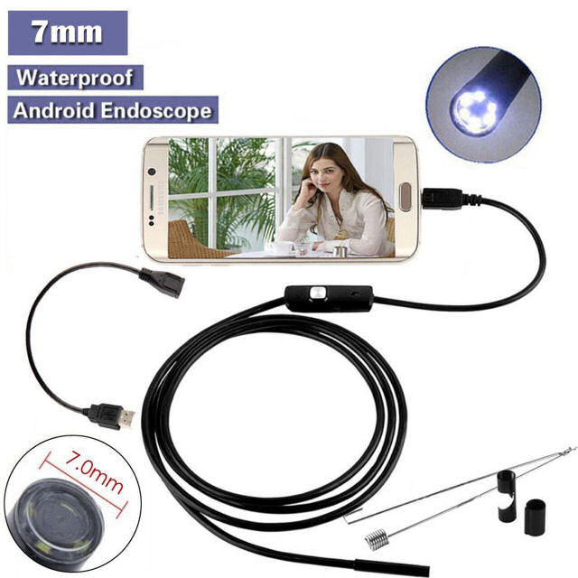

  3. d_meister
    d_meister Senior Member
    Mar 4, 2010
    515
    La Conner, WA.

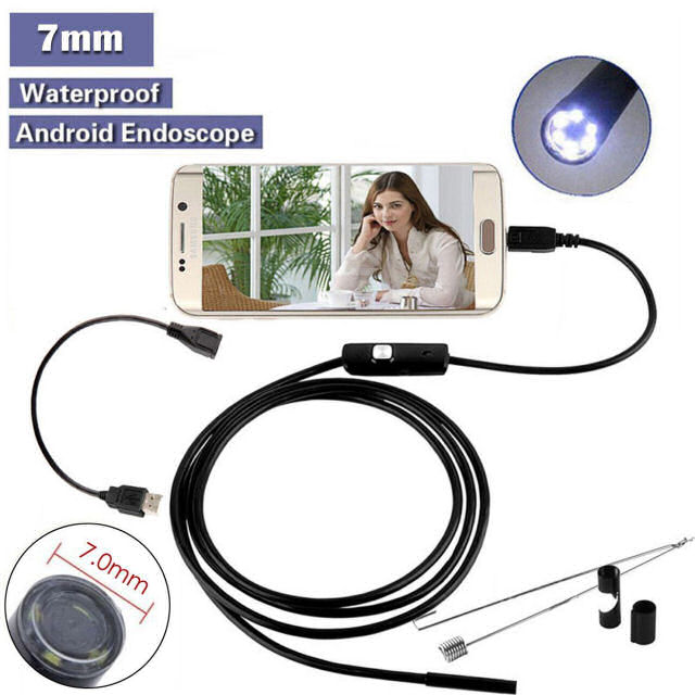

    If the concern is blocked dump can ports, it seems to me that the raw water hose going into the top of the can could be removed and a bore scope (endoscope) could be fished in there for a look around. They're under $15 on eBay all day long, and have lights built in. Mine works great and has a really good picture. The only difficulty is maintaining orientation, so it's best to fix it to a stiff wire,

  5. Boomer
    Boomer Senior Member
    Oct 14, 2017
    677
    Seminole
    Ordered...they are cheap! Now I can go the other way and see the thermostat also
  6. d_meister
    Mar 4, 2010
    515
    La Conner, WA.
    Hope it helps you. Those cameras are incredible, especially for the price. Be aware that the OTG connector ones don't work with iPhones. They have BlueTooth ones for those, but the picture is not as good. I wish those had been available when I was doing a lot of electronics installations. Endoscopes and lipstick cameras didn't fall to under $200 until maybe 5 years ago. It's surprising how useful they can be.
