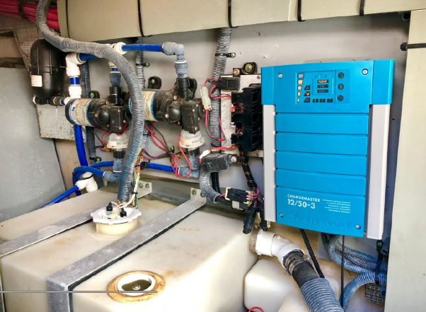

    Access to all systems is a high ranking boat criteria in my book too.
    The Sundancer (express) models are a bit more difficult because the Aft Stateroom takes up a portion of the engine room space when they shifted the engines back and used v-drives to get this features. They have sold thousands of them, quite a profitable design, but not quite the same installations as on a Convertible/Sedan with the traditional and much larger engine r0om. Here is a view of pumps from a 2004 SR 46 Sundancer:
