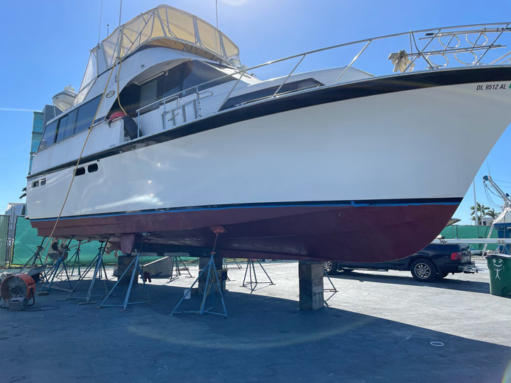

    When we laid up the Hat for a bottom job (blisters), after 6 months inside with heat lamps it was still almost too wet to do the job. You've got a serious (expensive) problem on your hands.

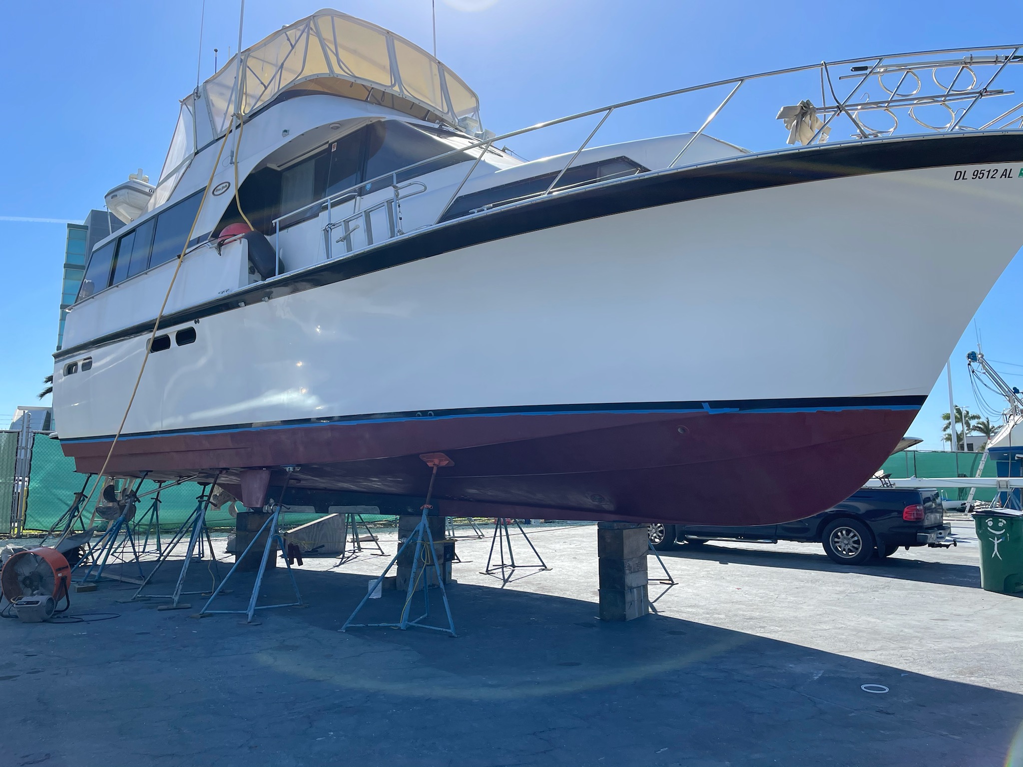

    Picture from today. You can see the 2 spots on the keel being worked on.

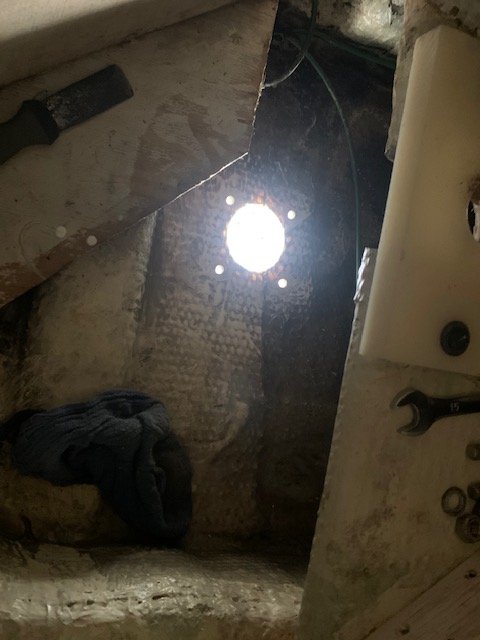

    I read somewhere that the center bilge pump screws can be too long and can puncture the top of the keel from the inside then water works it's way in from the bilge...I read it somewhere but cannot verify it being true
  4. RichV
    RichV Member
    Oct 26, 2020
    89
    Massachusetts
    I will investigate that, thanks.

    Btw, the keel has foam in it, not wood...nothing to rot...

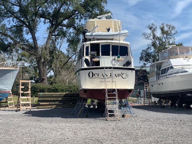

    -Seems like the blocking at Cracker Boy could have caused some issues; The port side door doesn't lock anymore and the port shaft developed a pretty good wobble. The wobble did lessen after the first day, which is in line (no pun intended) with what I've read about not aligning the until shafts after 24 in the water from launching.
    -The port rudder log leaked a little when the boat launched from Cracker Boy, and the was a terrible rattle on the port side prop whenever we went over 1500 rpm. The boat was hauled Thursday at Lamb's Yacht Center in Jacksonville, and the rudders were pulled out yesterday for re-bedding and re-packing. They did take it on a sea trial prior and heard the same rattle and thought it might be something with the running gear, but found nothing yesterday.
