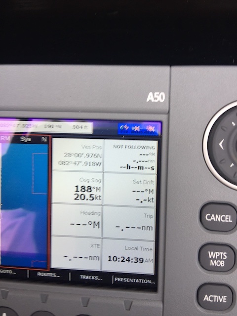

    Been following your adventure with your 83 46SS. I have an 83 46SS as well. Purchased in 1998 i have put roughly 13,000 + hours.
    I believe i have seen you at Three Rooker Island. Our boat name is Hawk.

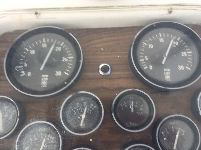

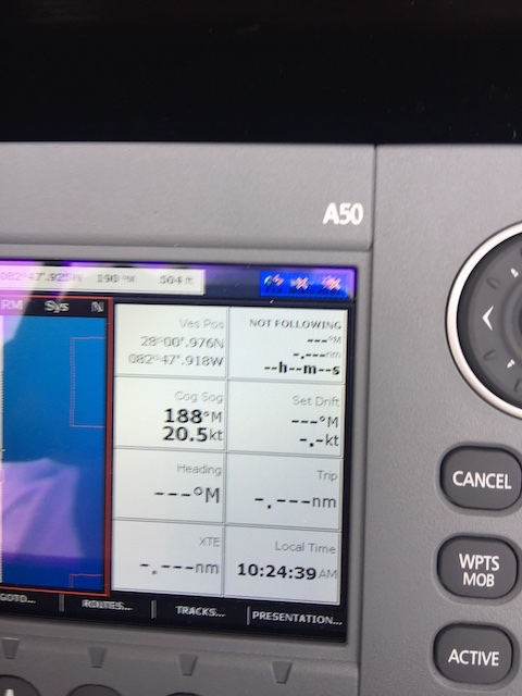

    671 J&T 450 hp Props are 25" X 25.75 - heavy cup ,3 blade Michigan wheels 1 3/4 shaft. The boat is propped to 2550 photo tached.
    J&T make a boost cooler for these engines, helps in florida.
    She planes at 1300 rpms at 14knts
    1650 - 16.5 knots 2250 - 24.5 knots
    1850 - 20 knots 2350 - 26 knots
    1950- 21.5 knots 2450 - 28 knots
    WOT 31 knots all with a clean bottom.
    For reference Tarpon Springs to Key West 270 miles at 22 knots 12.5 hrs we use any where from 360 - 390 gallons .
    Not guessing on the fuel we make that trip every year sometimes twice a year.
    hope that helps.
    Cheers Capt. Joe
    Hawk
