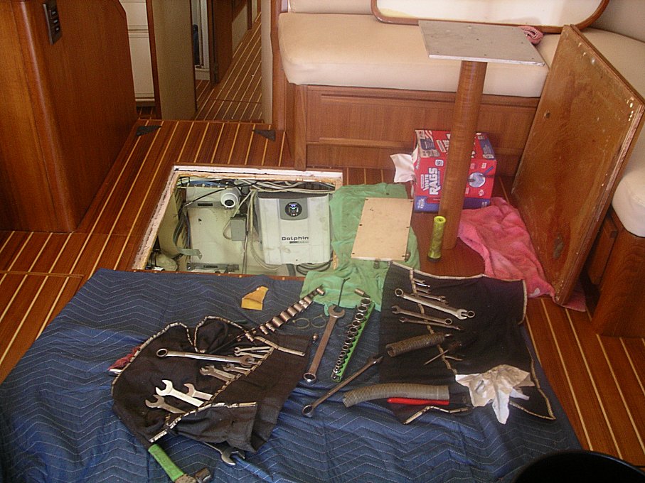

  5. SplashFl
    SplashFl Senior Member
    Feb 2, 2021
    727
    S. Florida _ Bertram 46
    UPDATE: Generator mechanic FINALLY showed yesterday. Removing the NL in two parts via a "hidden" hatch above it and installing a new Phaser ordered 3 weeks ago. Supposed to set up his A frame today and then off to the boat yard to grab with their lift and lower the new one.
    Capt Ralph let me know if you're serious about purchasing the NL unit. No idea what caused the coolant a path to the oil. Could be simple fix; could be major.

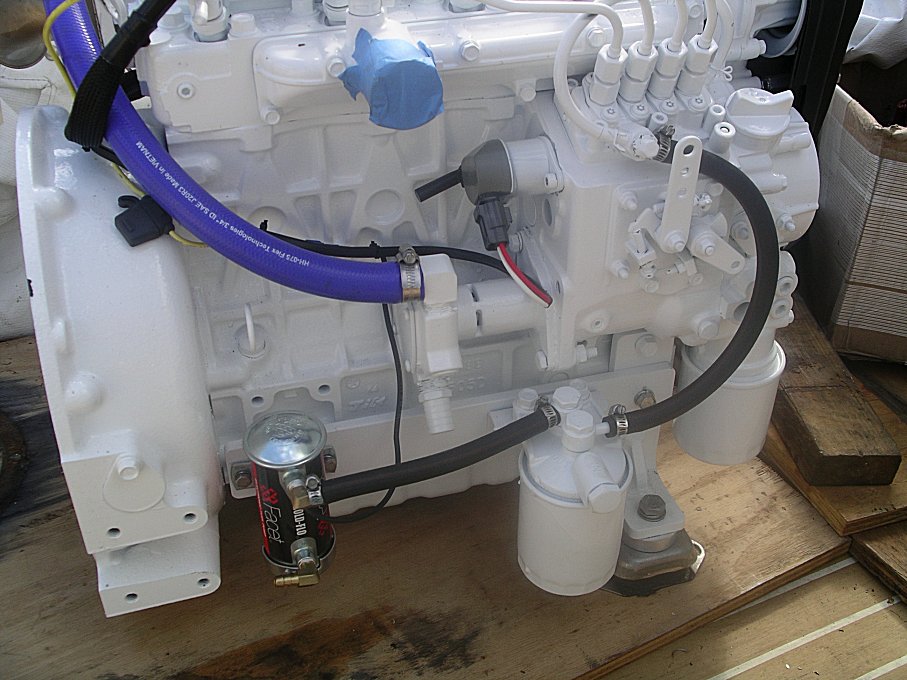

  9. motoryachtlover
    motoryachtlover Senior Member
    Jan 29, 2007
    756
    smithfield, VA
    Is the black canister a fuel filter or fuel pump? Was it a factory part or did you add it and if so why? Curious as I have a newish 20KW NL and I don’t have that set up and have had some priming issues with my unit
  10. Capt Ralph
    14,562
    Kubota uses electric fuel pumps.
    Northern lights luvs their mechanical fuel pump. Reliable but sometimes troublesome.
    On one customer's boat I installed a relay and electric lift pump to the glow plug system to help prime the gen set that had simular problems as yours. No more issues.
    On my lil get set, mounted a few feet over fuel tank level. I added a check valve to help reduce drain back to the tank during long storage periods.
    Just some of my swamp logic applied.
    motoryachtlover likes this.
  11. SplashFl
    Feb 2, 2021
    727
    Photo is the new Phasor that's replacing the NL. The black on the left is the fuel pump. Next is fuel filter, and all the way on the right is oil filter. All exactly as delivered; I've not changed anything. Was happy to see the oil filter in the vertical position vs. horizontal on the NL and the sea water pump on the front vs. right side as it was on the NL.
