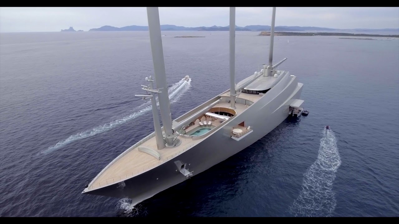

    1) Only one anchor, Port side way back from the stem.
    2) As I commented on long ago, exhaust soot on the last mast.
    Wonder what the sail and equipment looks like back there when deployed.
    Still a power boat that hoist rags sometimes.

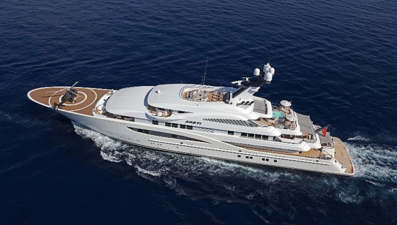

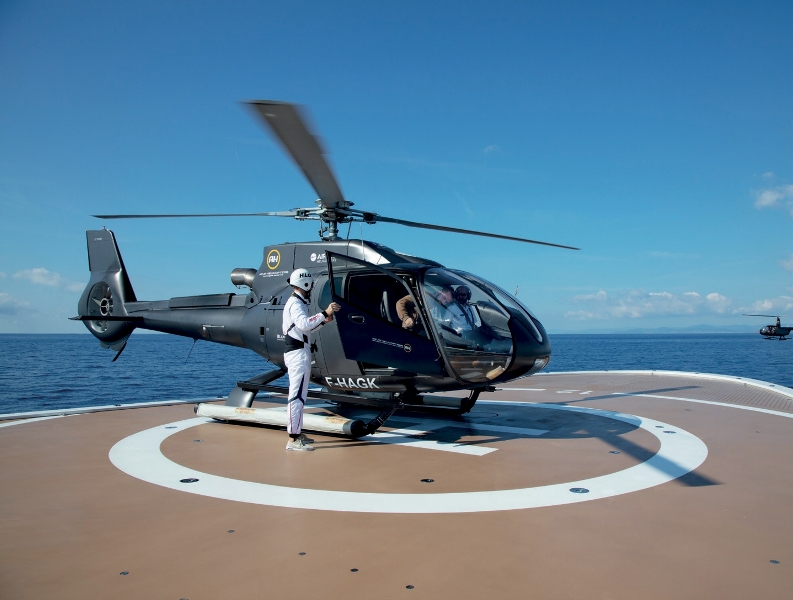

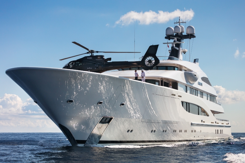

    Below some examples of the PYC certified landing pad on the foredeck on the Luerssen yacht Areti before its sale. The pictures were taken from her sales advertisement, so definately not copy protected.
    D-Value 12 meters, ring fully visible on deck and appropiate distance from the superstructure, weight classification up to EC-135, no obstacles around the landing area high enough to catch any part of a helo, full lighting for night ops, dedicated and trained and equipped ships ground crew for helo ops, all neccessary equipment for fire fighting and rescue and SOLAS rescue boat in the water and operational during helo ops. Very good SOP and all according to the books. The H-130 looks almost small on this deck.
    Areti was / is one of my favorite Luerssen yacht. But the asked price for her was ridiculous. Nice try but I would never pay the orginal price of the boat plus the operating costs for its almost two years of use. The main engines had 2.500 hours each and the gensets more than 4000 hours. And the VAT was not payed.
  16. Yacht News
    31,155
    I remember just before S/Y "A" was delivered the forward tapered part of the surrounding bulwark of the 'landing area' was missing (maybe they did not install it at that point) Or maybe something is retractable in that area?

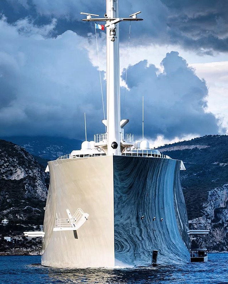

  17. Yacht News

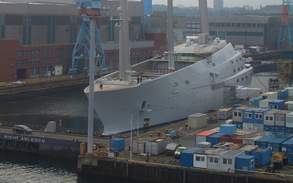

    31,155
    In this photo by yvangrubski you can clearly see the addition in the area I was referring to. If you look carefully at the video I posted... you can see what looks to be the same area of the bulwark missing especially seen when the helo is departing, so I think it folds down or something in that area.
  18. HTMO9
    HTMO9 Senior Member
    Jan 13, 2009
    1,681

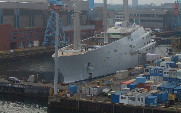

    Ron, do You mean this early design of the foredeck.
    As far as I know, this design was altered, when SY "A" went under canvas for the scond time. But if this part is removable, it helps but still not certified.
  19. Yacht News
    31,155
    Yes that is exactly what I am talking about... now look at that and look at the completed vessel and you can see the addition. Then look at the video very carefully for the departure of the helo and you can see it resembles this photo you just posted.
