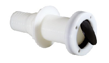

    Here's a question...
    When I have two normal sized people sitting in the stern on the gas tank, a small amount of water backs up through the scuppers onto the deck inside the boat - there is about 1/2 inch of water in the rear 2-4 feet of the deck. When I am idle, it builds up and eventually spills into the bilge where it is pumped out - but there is always a puddle there until I start to move. When I start to run, it drains back out - when folks move to the bow, the inflow stops.
    Just doesn't seem right to me - anyone have experience with this?

    Charlie... It was a bad design, I have been tempted to put scuppers in the side of hull above the water-line. Also looking for some type of check value to put in hose (which in my opinion is not large enough) that would stop the back flow.. I have owned a lot of self bailing boats over the years never did they drain below water-line.

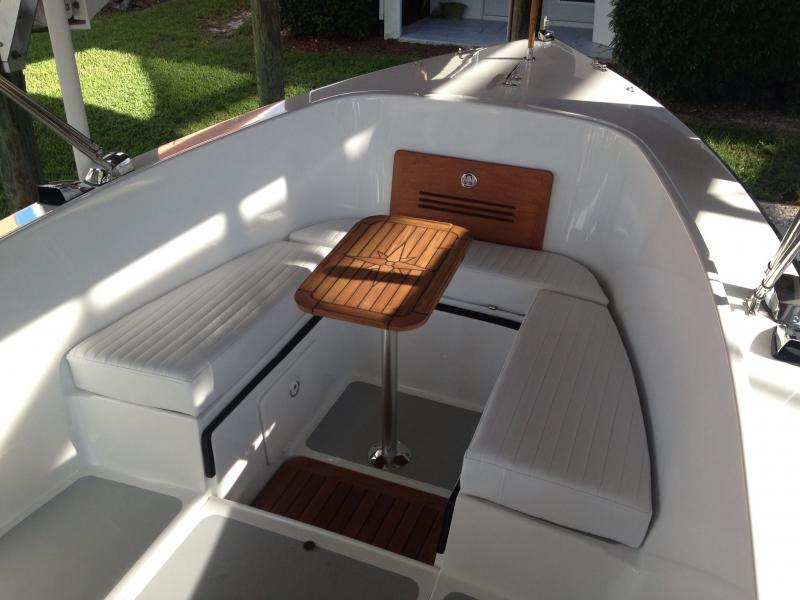

  8. Alanglois
    Alanglois Member
    Dec 1, 2004
    60
    Mentor Harbor Yachting Club
    Deck drains
    We eliminated the deck drains entirely and installed automatic pumps to handle the water. We had the same problem with water back flowing into the aft deck when there was extra weight back there. I knew we would be adding weight to the boat so we had no choice, This also prevents a catastrophic failure if one of those hoses should fail and begin to allow water into the bilge. Very poor design from the factory. Our new exhaust outlets were installed a bit higher and are half out of the water while running at idle. Also I just added the happy hour lounge (wife required) to the bow. This is completely reversible with little trouble and with built in stowage for the table and post. We built the fwd floor hatch with hinges that allow removal in a snap.
    Al

    Scuppers
    Al - that deck looks SWEET!
    Like you, I am very worried that those scuppers are well below (~2") the water line, that flimsy flexible pipe seems ripe for failure and the bilge pumps can handle any rain water accumulation without even. I may just plug them from the inside.

  15. Alanglois
    Alanglois Member
    Dec 1, 2004
    60
    Thanks all, the wife loves it and that's enough for me.
    CCI, You are correct there is little modification done here. I found a teak shower mat online that was almost the perfect size, I just had to round the corners closest to bulkhead. Some SS angle iron to mount it to and voila instant floor extension. I did have this in mind from the onset as the storage hatches in the side of the underwell facilitated the fastening of the angle iron and the table base. Also, we used removable hinges on the original lid/hatch to make for easy removal. The table/post stores on the underside of the removable lid/hatch for easy access and storage. The whole thing goes back to fishing mode in about 5 min.
    Al

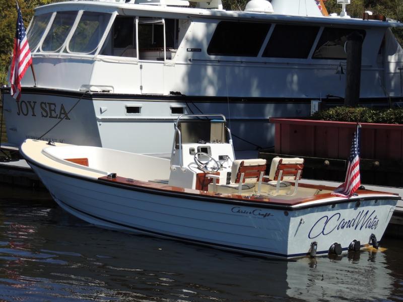

  16. ddw1668
    ddw1668 Senior Member
    Jan 18, 2007
    133
    Murrells Inlet, SC
    Fresh non skid and bright work..........used 2 Qts. Interdeck non skid, one white, one cream mixed. The original Awlgrip with 'sand' was a bear to keep clean. This Interdeck seems to be much less upkeep and really looks good over the old non skid.
