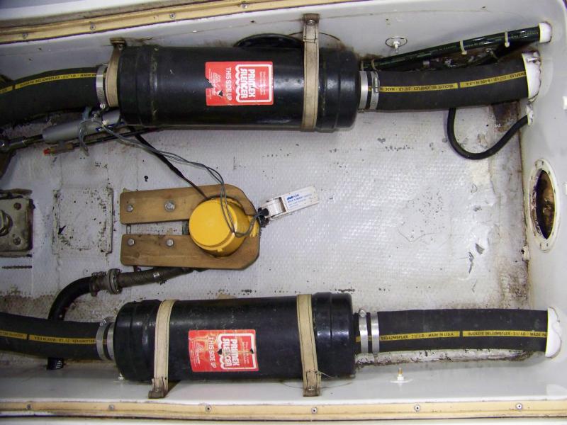

    Currently, I am running a 357 Mercruiser. After the risers, there are two 45 degree elbows down and then a straight shot of 4" flexible hose along that stern hatch to the transome.
    At idle, the noise is not too bad. But when you open it up, it is pretty loud. I have sourced a pair of 4" straight, low profile mufflers, somewhat affordable (price being relative of course) that I could fit in with relative ease. Just wondering A) would there be any decrease in performance or B) untoward effect on the water pump and C) would they be effective is reducing the noise?
    Again, I am not a motor head.... Thanks in advance for you advice.

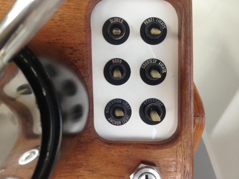

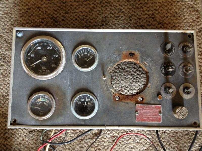

    Here is what came stock on my 76 Dory. Nice aluminum trim and all straight out of the 70's. Even the original RED bilge warning plate!! I will be using it as a template for a new one when I get to that point. I am trying to stick to the basics without much modification and keep the stock look. As most others a nice slab of teak should fit the bill. As for your handrail, everything north of your "splice" is right it looks a though prior owner jury rigged it to accomodate the larger windshield.
    Charlie,
    Man I cant wait to get to your stage. She looks beautiful. My experience with silencers is that they do in fact silence the exhaust but the bigger the can you can fit, the less noise you will have. I know some guys who did not have alot of space and put in the "space saver" slim versions and it made very little difference. I plan to install Vernatone and they are probably about 8-10 inches in diameter and about 24 inches long. Hopeully they will tame the beast!!

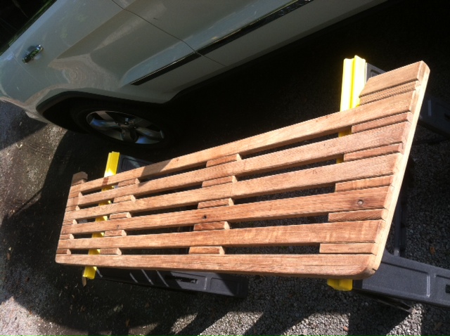

    If any of you Dory rebuilders are looking for a mint original swim platform in teak, give me a PM.

    I would be interested in it. Do you have any pics and what condition is it in. Was it off of these boats?

    I don't know about the back pressure, etc... but here's a picture of the wet mufflers the prior owner put in for my 200 hp 318 Chrysler, which purportedly work pretty well. Once I run this thing in earnest I'll let you know! Looks to me like there's room for bigger ones if they don't.
    Greetings, 76 Dory...
    Thank you so much for that "OEM" picture!!! I've found some gauges that are pretty darn close in style to those, and now I need to figure out just how "hardcore purist" I want to get re: aluminum dash v. wood. Did the rest of your rig come with all "OEM" configuration/fittings/etc?

    I would like to see a picture of that platform as well - but Al has first dibs... that's wayyyyy down my restoration priority list!

    John - I had a good chuckle over your sanding at 10:30 PM, that is absolutely something I would do. I got yelled at last month for wiring the console on the living room carpet!
    That gauge panel is identical to the one I replace on mine last year, no doubt it is OEM.

    I will dig the swim platform out my storage unit next week and take some pictures to post here.

    Also, my boat has the Crusader 330HP small block and the largest mufflers that will fit between the narrow stringers and I wish there was room for even bigger mufflers. These boats were built with 130HP to 225 HP and 330 HP borders on too much power. I have a 14X10 prop turning on a 1 1/4" shaft and the boat literally 'leaps' onto plane from a dead stop. I have gotten used to it, but the first time you crack the throttle as a new driver........you better hold on tight. :D

    The picture of your "OEM" panel inspired me to research how difficult it would be to replicate it, and believe it or not those "old school" round toggle label plates appear to be a relic of the past. In web-searches for them I found mostly postings on boards like this with people restoring boats/cars searching for them. Am I missing an easy solution to the challenge?
    Unless someone knows where to get "off the shelf"... I MAY have found an outfit that can custom make them at a semi-reasonable price... would it be possible to confirm the dimensions of the label plate as likely 1 1/4" diameter with a 1/2" center hole?

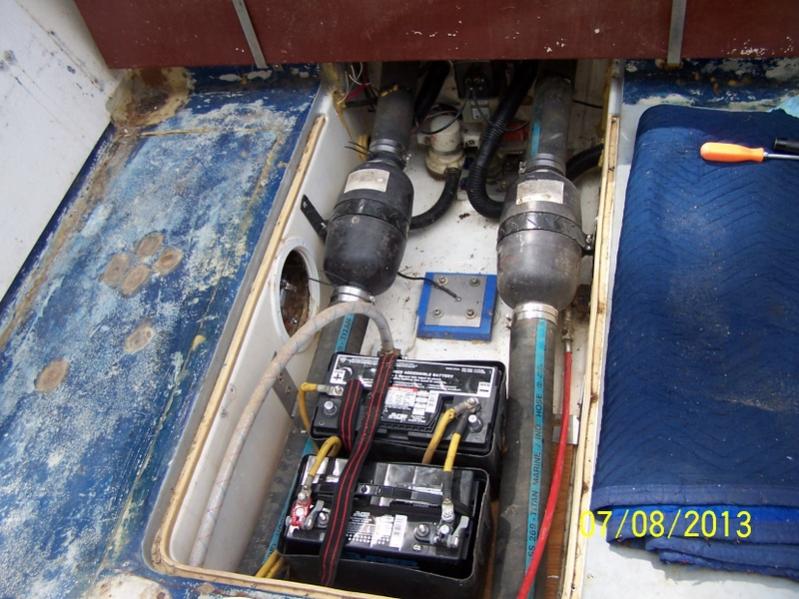

    We used starboard to back plate the rudder and strut flanked with SS 1/4 plate. We have not experienced any issues to date. What exactly was the issue? Also I will post a pic of our mufflers which reside outboard of the center floor hatch. The round toggle labels are available through LPX pars out of Bradenton fl Jim wick knows almost everything about almost any Chris . I will post a web site soon with the pics of the mufflers.

    Here are the labels

    This is the setup we found on the boat when we acquired it. We kept the same mufflers, and just moved them outboard of the center hatch. We were able to do this as we created new hatches in the floor on either side.

    Alanglois:
    This is a picture of the swim platform that came with my 79 22' CC. I can't guaranty that it is factory original. I can't find a SP option on the price sheets, but there is a photo of one with a platform in one factory photo that I have.
    The supports were not included BTW. Make an offer, taking up room.

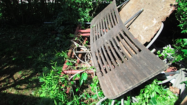

  17. ddw1668
    ddw1668 Senior Member
    Jan 18, 2007
    133
    Murrells Inlet, SC
    Picture to go with the last post.

    That looks like a Chris Craft platform to me. It's surface joinery profile is identical to the one I had on my 315 Commander SF. I distinctly remember cursing those grooves during a refinishing project.
