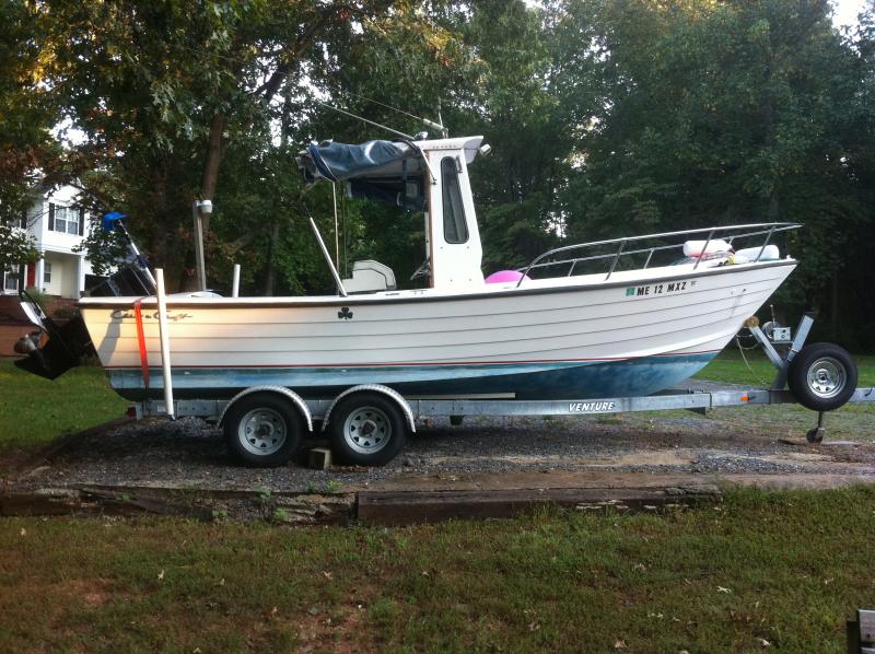

    jimmyve New Member
    Jul 17, 2014
    Maryland
    1978 22'
    Just joining the forum. I have a 1978 22' outboard version (Cutlass, Sportsman?), I have been told by Pacific 22 owner/builder only 33 of the original outboard versions of the boat were produced. I am addicted to this little dory, I love the lines and the ride, although I think my wife would like to see some of the happy hour additions, etc., to the boat that I think it was Al made. Nice job Al. I need to redo several items on the boat including decks, gas tank, paint etc. I didn't know the model had such an enthusiast following when I fist saw the boat on Ebay, I just fell in love with the form. I found it in Long Island and brought it to Maine, now in Maryland. It is a very versatile boat, I have used it tubing on lakes and fishing in the Ocean. I will try to add some additional pictures. I am also very intrigued by the inboard version, having the engine in the middle of the boat must help with the smooth ride in a chop. Although as mentioned on some of the previous posts the cockpit drains always clog.

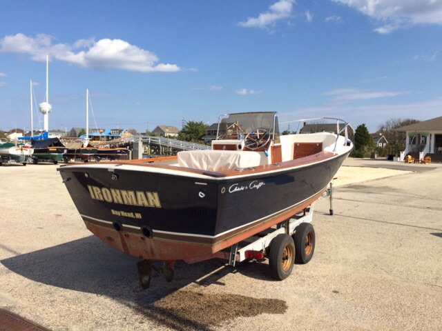

    My least favorite day of the season is when we haul out, but we had a great summer and accumulated a long list of repairs/improvements for the off season.
    She still looks as good as ever.....

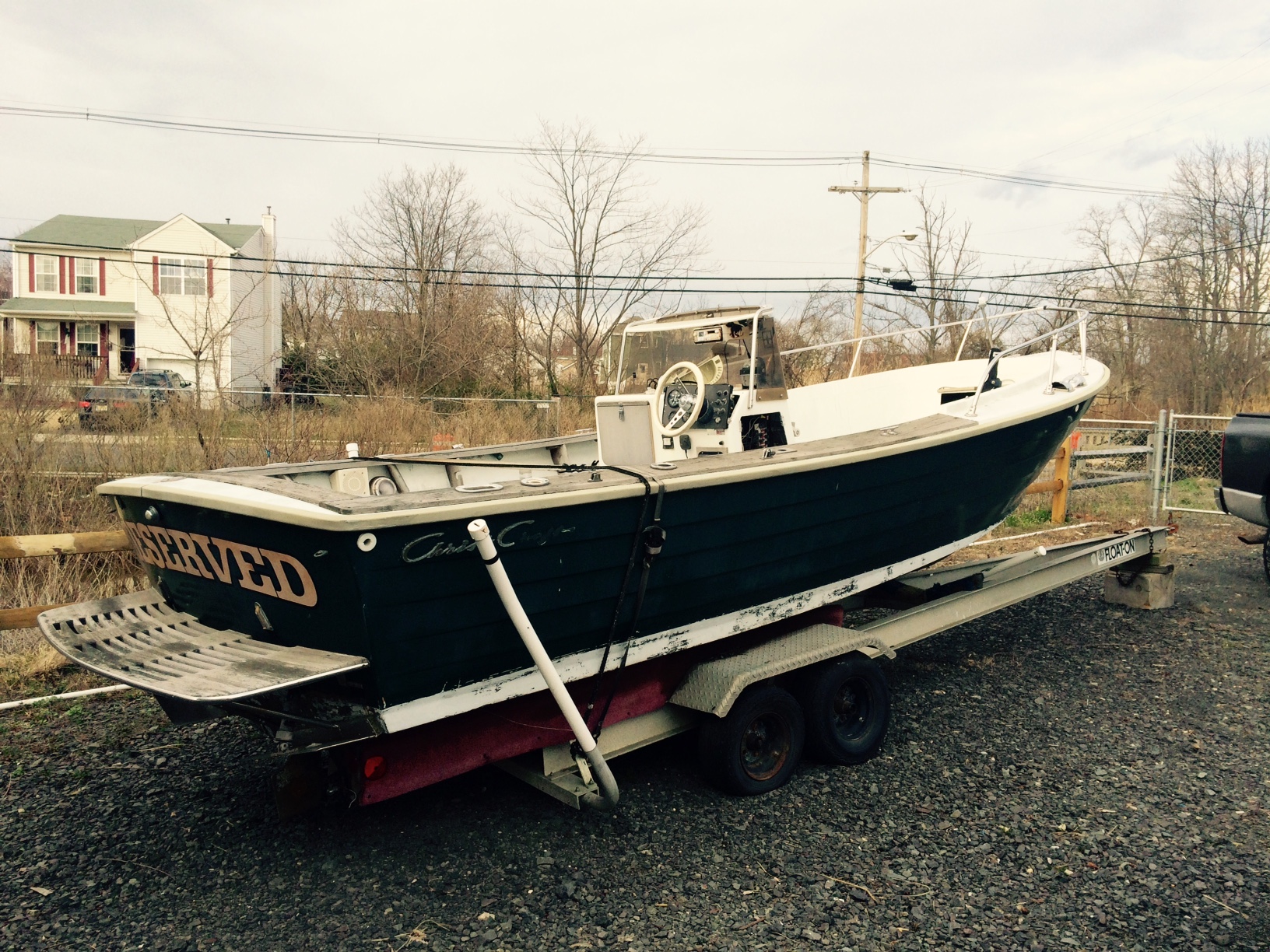

  14. David Hoder
    David Hoder New Member
    Mar 23, 2016
    22
    Fair haven, nj
    So here is the one I bought. They say it's a 72, but I have not seen the title yet.
    Eager to start working on it.

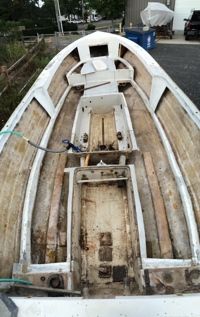

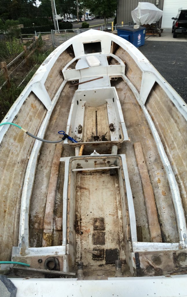

  16. David Hoder
    Mar 23, 2016
    22
    Fair haven, nj
    Started ripping out floors this week. All the foam is soaked and has to come out.

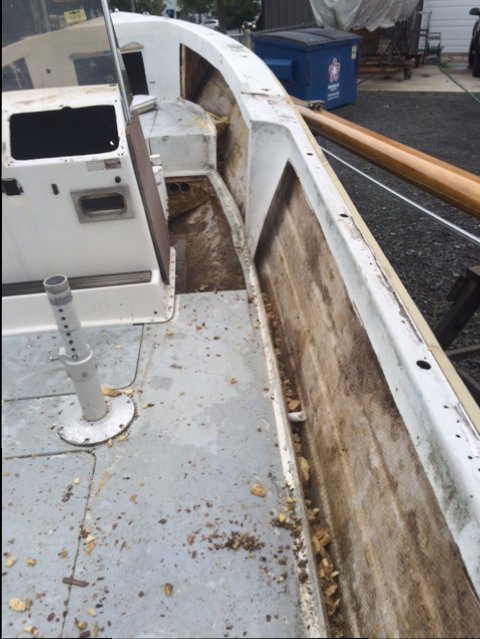

  19. David Hoder
    Mar 23, 2016
    22
    Fair haven, nj
    Well on mine, I just finished Demo. Will be cleaning up and sept will be the month of starting the rebuild.
