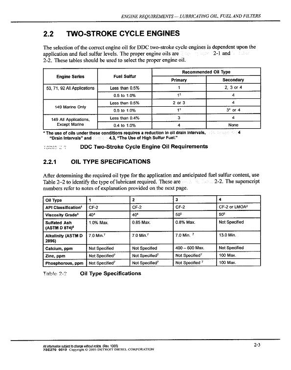

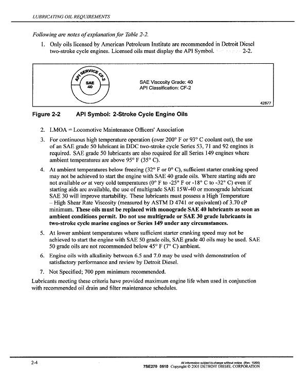

  5. Capt Ralph
    14,578
    From THE book;

    3. For continuous high temperature operation (over 200 F or 94 C coolant out), the use
    of an SAE grade 50 lubricant in DDC two-stroke cycle Series 53, 71 and 92 engines is
    required. SAE grade 50 lubricants are also required for all Series 149 engines where
    ambient temperatures are above 95 F (35 C).
    4. At ambient temperatures below freezing (32 F or 0 C), sufficient starter cranking speed
    may not be achieved to start the engine with SAE 40 grade oils. Where starting aids are
    not available or at very cold temperatures (0 F to -25 F or -18 C to -32 C) even if
    starting aids are available, the use of multigrade SAE 15W-40 or monograde lubricant
    SAE 30 will improve startability. These lubricants must possess a High Temperature
    – High Shear Rate Viscosity (measured by ASTM D 4741 or equivalent) of 3.70 cP
    minimum. These oils must be replaced with monograde SAE 40 lubricants as soon as
    ambient conditions permit. Do not use multigrade or SAE 30 grade lubricants in
    two-stroke cycle marine engines or Series 149 under any circumstances.
    5. At lower ambient temperatures where sufficient starter cranking speed may not be
    achieved to start the engine with SAE 50 grade oils, SAE grade 40 oils may be used. SAE
    50 grade oils are not recommended below 45 F (7 C) ambient.
    https://www.demanddetroit.com/public/technicianguides/technav.asp/
    See #4. It is recommended you run straight 40 weight in a 2 stroke almost always, unless in weather that gets below 32F (without starting aids: block heater etc.) . But, Detroit Diesel does sell a CF2 rated 15w-40, I forgot the part number for it and it's murder to try to find the part number online. But for cold weather, they do allow use of a 15w-40.
    Rcrapps- you beat me to it, but on your chart for marine, under secondary oil #4 is listed, but see figure 2-2 and number 4.

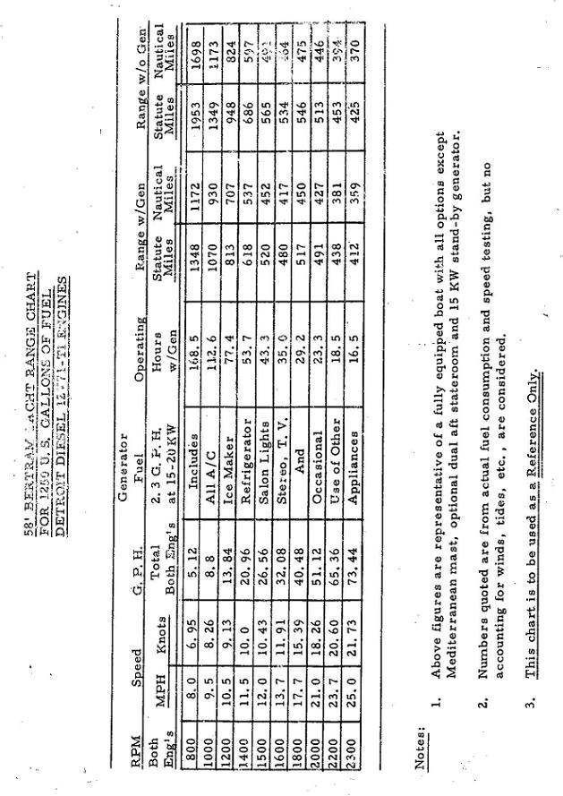

    Thanks to rcrapps for the below chart..
    Not wanting to take away from the topic too far but does anyone have something similar to the below for an Ocean Alexander 440 CPMY? Dry, it should be about 27,000 lbs and has a 300 Gallon fuel tank running twin Cat 3208's.
    I'm new to this boat and gathering info so any help is greatly appreciated.

  18. Capt J
    14,898
    Make one yourself. Get a propellor curve chart from CAT for your HP, and read the fuel numbers at a given RPM off the propellor curve chart (provided your RPMs reach WOT), you're fuel burn will be within less than 5% of whatever the chart reads, record your speed at each given RPM. Wait about 2 minutes after bringing it up to each RPM point for speed to settle out.
