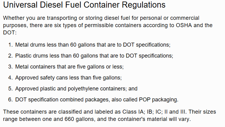

    I am just trying to make a point about being aware of what you are using. Some are 2.2mm thick, while others are not. Here is an excerpt from the U-line catalog, a common supplier:
    Another supplier states that it is the responsibility of the FILLER when using fluids that fall under CFR Hazardous Chemicals. So buyer beware, use what you are comfortable with, but know the ramifications.

    Well, I wouldn't say false but here is some clarification, and you can google the heck out of it and dig deeper if you feel the need:
    So it would have to be a DOT specified container, usually yellow for diesel, stamped or clearly marked, not the usual water or fruit juice surplus blue drums that are so readily available. Probably because of the flash point of diesel fuel, something more relevant to liquids that are used for fuel than other hazardous chemicals.
    All of this is of course, if you want to operate by the "book". My main point is that there is a right tool for the job, just make sure you have it and are aware ahead of time.
