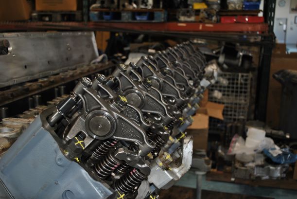

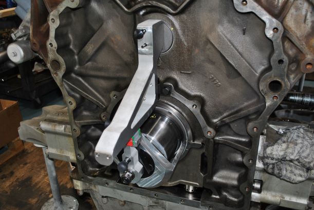

    How do you get the camshaft and crankshaft exactly where they need to be? With a very expensive alignment tool.
  2. Capt Ralph
    14,586

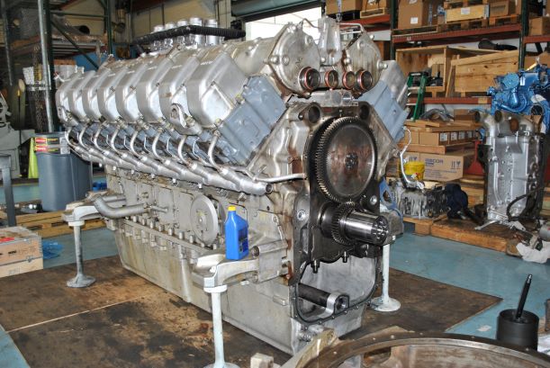

    So it's a direct connection between the crank and cam in the pic from post #20. Maybe I'm looking for it to soon,where are the PTO gears?
    Remember, I'm a DDC guy. They use lots of gears for the cams, blower and PTO.

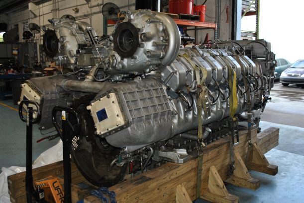

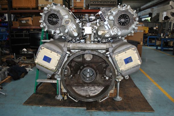

    In my efforts not to disappoint Captain Ralph, I had a colleague take some photos while I was at Monaco. Here are the results of the build;
    Fuel Line assembly continues
    Prior to Turbochargers being installed
    Turbos Installed

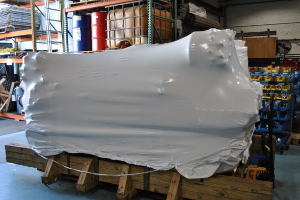

    All dressed up and ready to go
    We also include free gift wrapping, however you need to supply the bow.

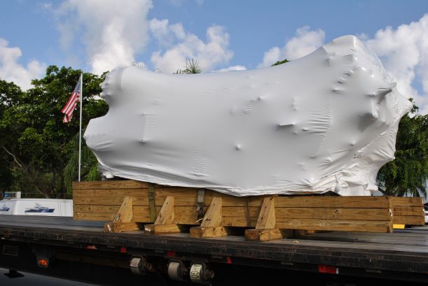

    Uber flatbed arrived in 4 minutes!!!
      39.4 KB
      1,528

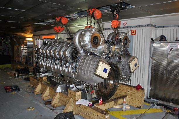

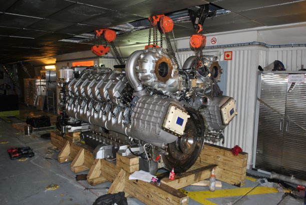

    The 16V4000 is now back on board. Prep work has started to get it into the engine room.
    Once all is ready, it will be lifted up, and the hatch you see under the support will be moved and
    the engine lowered into the bed. I'll be back there tomorrow for additional photos.
