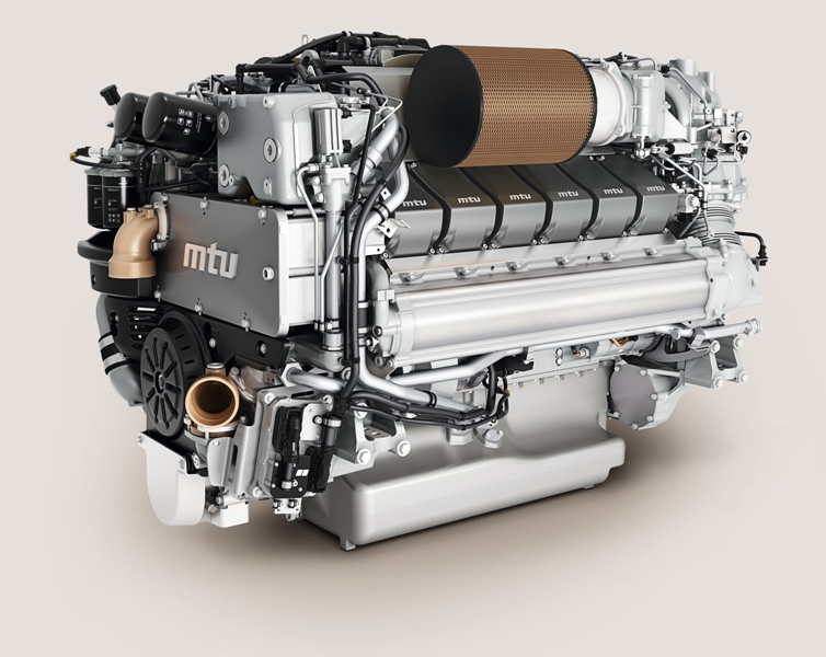

    MTU just announced a new 2000 series engine version the 96X series starting with the 12V2000 96X
    "The MTU high-performance yacht engine gets a power upgrade as the output of the 12-cylinder series 2000 M96 engine is increased from 1,432 kW to 1,472 kW, equivalent to more than 2,000 horsepower. Its proven acceleration characteristics, excellent maneuverability and quiet, smooth operation make the engine especially suited to luxury yachts and leisure fishing boats. This power increase means Rolls-Royce can now respond even better to customer requirements. The new engine version MTU 12V 2000 M96X is immediately available from now on".
    First boats that are equipped with this new motors are a Viking sport fishing yacht and a OTAM 70. The 10 and 16 cyl. versions will follow ASAP.
