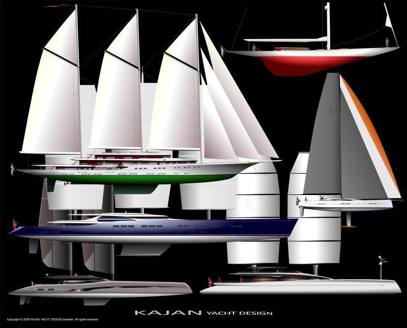

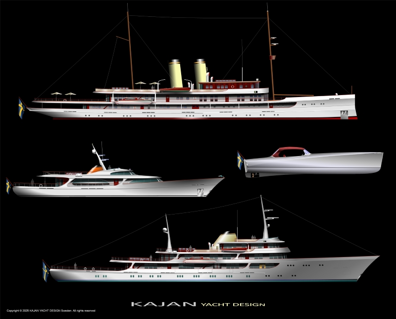

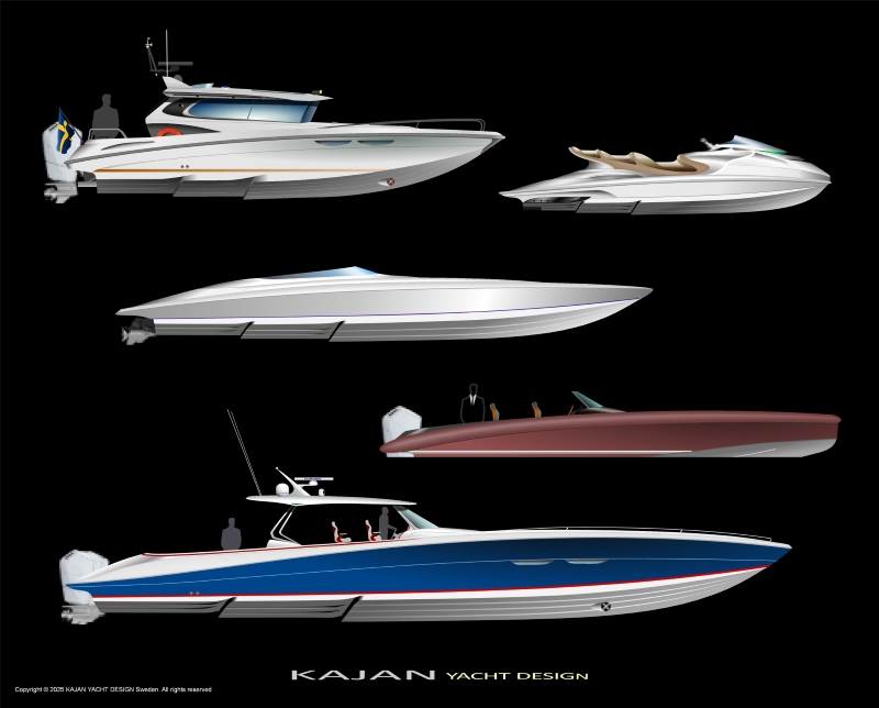

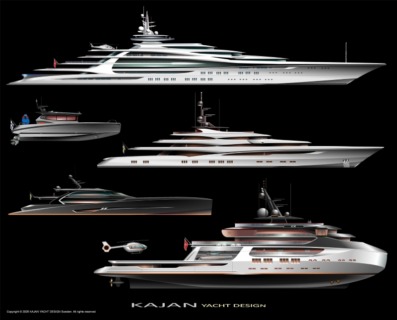

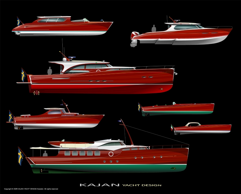

    It’s been a while since I posted any new designs and I have an urge to change that.
    I have been thinking of a different approach to new design this time, and I would like to run the idea by the YF members. I would like to introduce an idea where the different designs would be based on the viewers continuous and interactive input during the design process.
    The design would be from scratch and of course the aim is not blueprint level, think “pretty pictures” ;)
    I’m thinking different designs in different categories, from smaller pleasure crafts to Mega Yachts in all shapes and sizes.
    The categories could range from Pontoons, Jet skis, turbine cats, fishing vessels, racing to Yachts in different sizes and for different purposes. Monohulls and cats, both motor and sail. For use in US, Arctic, Mediterranean or Scandinavian waters, whatever gets your boat floating, bring it on!
    I’m thinking the YF members could contribute with thoughts and ideas and where possible contribute to the design with preferable design methods and tools. Perhaps simple 2D design ideas, like my own, could be combined with 3D and even A.I. assisted design contributed by the members.
    We need to agree on some specific design projects and size respectively. Perhaps keeping it to 3-4 different projects to make it manageably. They could all be running in parallel and in new separate threads.
    I have not thought this endeavor through in detail and I was hoping for the YF members to pitch in when it comes to a preferable way forward. Definitely high and low, no doubt, but hopefully, we can find best practice and not forgetting the aim and to have fun and not to take this too seriously.
    To get things started, I’m posting some of my old designs to get your thinking going.
    …thoughts?
    Happy Holidays!
    Best/Mike

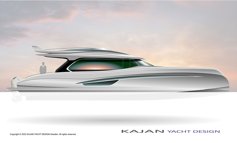

    50 to 60-foot range, outboards, a brief is coming together.
    Target speed, Flybridge, Bimini/Hardtop, Classic, Modern Retro or a Sporty look, accommodations… There are quite a few designs in this range out there and it’s clear form follows function.
    While we sort the details, I’m posting my old 95-foot power cat design, now downscaled to 60-foot, to illustrate dimensions and proportions. Not the scratch design, just food for thought and further discussions.

    Nice looking cat Kajan !!

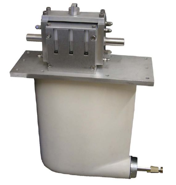

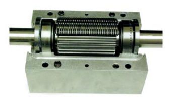

    Most cats that have tried outboards at the sterns have to deal with them pitching out of the water,..then over revving, etc. I think the props themselves just need to be further forward.
    You could located the engines anywhere along the vessel,...with a simple U-jointed drive shaft hooked up to a silent chain drive outdrive leg like the one(s) built by PYI long ago,...
    https://www.*********************/dynarig/Tennant_Hull_V_ChainDrive.php

    I could not edit that posting above to add these 2 photos of the chain drives. I very much liked not having 90 degree shafts and gears.

    Thanks Brian!
    …I guess most designs, regardless of the purpose of the vessel, will have some weak spots…

    For an outboard powered cat, I think an open flybridge would be best to keep CG and weight down. As for accommodations, a main deck master would be GREAT but maybe not realistic in a 60-foot cat? Target speed is hard to predict until we determine the the number of engines and horsepower.
    The cat in your render (above) is certainly stylish, but with most cats the accommodations often dictate the design. I'm leaning towards a modern look, maybe with a retro element?
